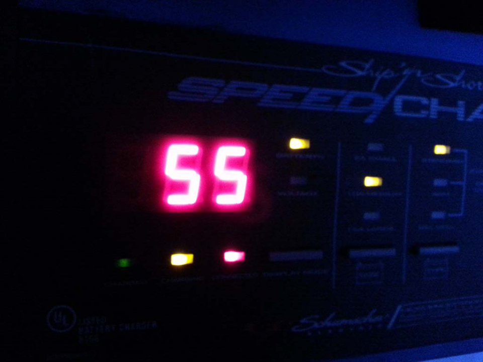

    Here's another example of a NEW under charged battery in my new 2013 Ford C-Max Energi.
    It's also more proof the charging system won't charge up a battery like some people believe :ROFLMAO:
    The car was built March 2013. I bought it on Sunday of last week and have just over 600 miles on it this morning. After I unplugged the HV battery, I thought I might have a look at the 12V battery :eek:
    55 percent state of charge. Yeah, that's always good for the systems and battery longevity :cry: I hooked up my handy dandy micro processor charger and I let it handle the battery for me :cool:
    Here's a shot of the % of battery charge before charging it to full capacity. I suggest you check yours too! You'll need a good micro processor charger. I prefer one with a battery % of charge meter as part of the readouts.

    This is not uncommon on "new" cars.
    The batteries are often far from an ideal state of charge when bought from a dealer as they often sit for weeks without being used in storage areas or on transport.
    Although the dealers should charge them on arrival they often neglect to do this and stand on the lot with people viewing the cars opening and closing the doors discharging the battery further.
    In your case the battery is at what is considered to be at a deep discharge level, 50% is normally accepted as maximum discharge level for most lead acid batteries, but may well have been much lower than this when you picked the car up.
    John (Britprius)
