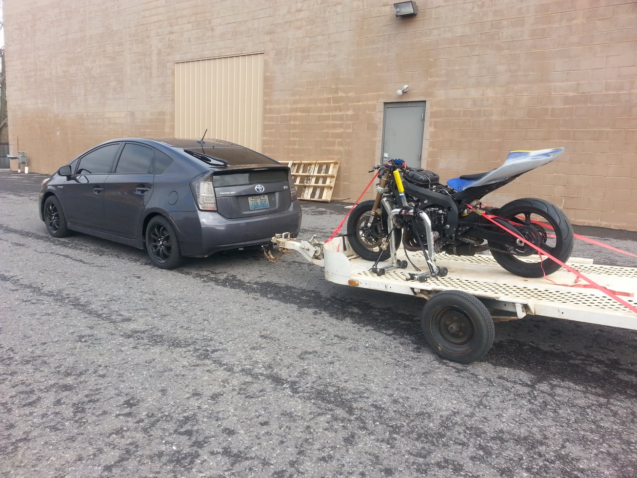

    Looking to get a small single rail trailer for possible track day use. I borrowed my father in laws trailer and put track bike on just to get an idea of the feel and mpg. It was slightly noticable on takeoff, similar to going up a hill until I hit about 45mph, then it pulled great. consistant 36-37mpg mostly highway. My bike weighs right at 300 and the trailer is old and heavy, probably 4-500lbs. But it worked for a test. Looking for a used Kendon or similar now!

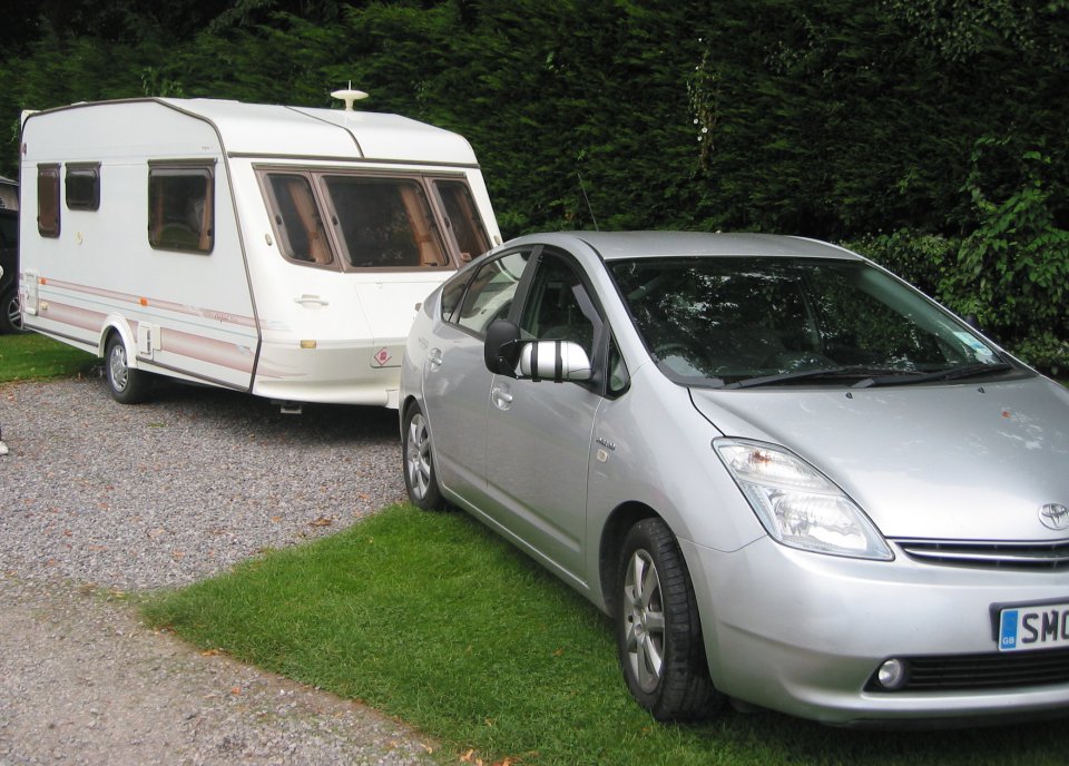

    I have been towing with my Prius regularly without problems. The outfit is shown below.

    Do UK registration papers have towing capacity for Prius? Here it says on the papers that maximum weight of the trailer is 0kg.

    UK regulations permit towing an non braked trailer up to 750kg over this figure the trailer must have it's own brakes.
    There are enforced speed limits of 50 mph on all roads "unless the speed limit on that road is lower" or on motorways 60 mph. All this is providing the loaded trailer is no heavier than the vehicle kerbside weigh "with recommendation that the trailer be no more than 80% of the cars weight".Over the 100% limit speeds are restricted further. The trailor manufacturers design maximum weight rating cannot be exceeded.
    Driven sensibly the Prius performs well at the 80% or bellow level. The outfit in the picture returns a remarkable 49 mpg "UK gallons" maintaining the legal speeds in cruise control. This includes the long clime on the M62 motorway over Saddleworth Moore from Manchester a route GC will know well. The UK's highest motorway.
    The car pictured has now covered 120,000 miles with the only thing replaced apart from normal "service items" is a passengers side front wheel bearing.
    Transmission operating temperatures do rise, " possibly due to our cool climate rarely getting over 22C" but only 10 to 15 degrees. I did initially consider extra cooling but have found it not to be required. If I was towing 100% of the time I probably would fit extra radiator. I have changed the transmission fluid 3 times in the life of the car.
