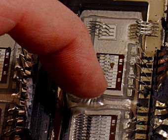

    That's not really the "control board for" the inverter; what you're looking at is the part we normally call the IPM, or "intelligent power module", which is really just a handful of very stout IGBTs (insulated-gate bipolar transistors), six for each of the two motors and two more that make up the "boost converter" matching the 200ish volts of the battery to the 650ish volts for the motors. It includes a transistor-to-coolant heat sink; the things that look like hose nipples at the top left and bottom right corners are hose nipples; the coolant goes right through this part to carry the heat away.
    The other things you'll find inside the inverter assembly are: the DC/DC converter that makes the 12 volt supply for the car, and the MG ECU, which is the control board for the inverter.
    The MG ECU mounts on a bracket above the IPM that you are looking at. The DC/DC converter mounts underneath the IPM; its top is a large metal face that meets the bottom of the IPM through heat-sink compound, so the coolant flowing through the IPM also cools the converter.

    Ah, I think I was misled by the fairly innocuous looking PCB on the top side of the IPM (most pictures only show the top), but the IGBTs are underneath and part of the same assembly? Would certainly explain the high cost then, and it's not something a Toyota garage is going to repair, hence replacement of the whole unit.

    I suspect that what you can see of the IGBTs will be in those large rectangular black features toward the middle of the board and that each one contains a group of nekkid IGBTs that you could look at through a layer of clear potting goop like the stuff hobbit enjoyed playing with (though that photo was from a Gen 2 inverter).
    I'm guessing the one at the top and the one midway down (each with three cylindrical components to its left) are for the two three-phase motor/generators, and the lowest one in the photo (two cylindrical components nearby) is for the boost converter, but I've never seen it any closer up than that photo.
    These kinds of assemblies are called "intelligent" power modules, but as far as I know, the "intelligent" means they have some on-die sensors to detect the transistor temperature and proper operation. The real controlling intelligence is in the MG ECU that bolts on top of it.
    The term "IPM" by now isn't especially unique to this application; there are off-the-shelf ones in various sizes. In this thread I wrote about the (smaller, not water-cooled) one from Mitsubishi found in an old (Prius-to-house-power) inverter I picked up.
