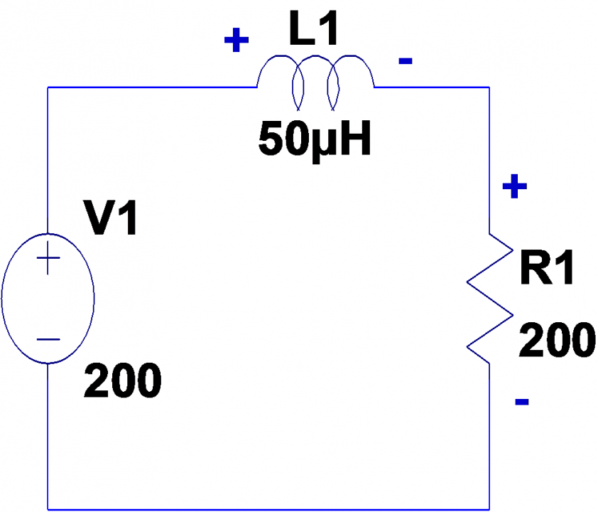

    Let's draw a little circuit diagram with a battery, a resistor to limit the current, and an inductor:
    So, the DC resistance of the inductor is 0 ohms (just a hunk of wire, right?), the current is limited to 1 Amp (200V/200Ohms, Ohm's law), and we have a magnetic field around the inductor. Current flows in the left side and out the right (OK, I'm a EE, I think that way. Techies think of terms of electron flow, which goes the other way, but I digress.) There's 200V across the battery, + to -, 0V across the inductor (no resistance, right?) and 200V across the resistor, + to -.
    Now comes the interesting question: What happens, precisely, if the wire is broken between the inductor and the resistor?
    Well, a novice would think that the current, like, stops. They'd be wrong. There's that magnetic field, suspended in mid-air if you like, and without something to sustain it, it's going to collapse. And when it does, it's going to do so in a fashion that keeps the current going in the same direction that it was going in. The sign of the voltage across the inductor will swap, with + on the right and - on the left; and the voltage across the inductor will get very, very large until something gives way.
    Any of you who have unplugged a running vacuum cleaner (motors are full of coils, right?) knows what happens next: there's a big spark, a snap, and all the energy that was in the coils in that vacuum cleaner goes into heating up the air. The current going through the coil decays exponentially at a rate of I = Iiniitial*e**(-t*L/R), where e is 2.7 something, "**" means "raised to the power of", R is our resistance (pretty big when the plug is pulled out of the wall - it's the resistance of ionized air, yeah, the voltage across the inductor gets that big), L is the value of our inductor, and t is time (as in seconds, microseconds, etc.).
    Another way to think of this: Inductors do not like to see instantaneous changes in the current going through them. Yes, one can make the current go up, one can make the current go down, but step changes in ideal (and, pretty much, non-ideal) inductors just don't happen. The inductor will arrange the voltage across itself to ensure that no instantaneous change in current will happen.

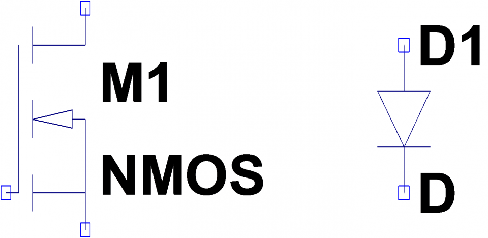

    Next, two components: A FET (Field Effect Transistor) and a diode:
    That FET, which happens to be of the NMOS (N-type Metal Oxide Silicon), has the Gate terminal on the left, the Drain terminal on top, and the Source terminal on the bottom. When the Gate (on this transistor) is positive, the Drain and Source are connected to each other, usually with a very low resistance (milliohms).
    That diode, "D1" is a EE's version of a one-way device. Current can flow through the anode (terminal on top) to the cathode (terminal on the bottom) when the voltage across the device is positive, from anode to cathode. When the voltage is reversed so the anode is negative with respect to the cathode, No Current Flows. (Although, if the voltage gets big enough, then current flows, as well as flying bits here and there, but I digress.)

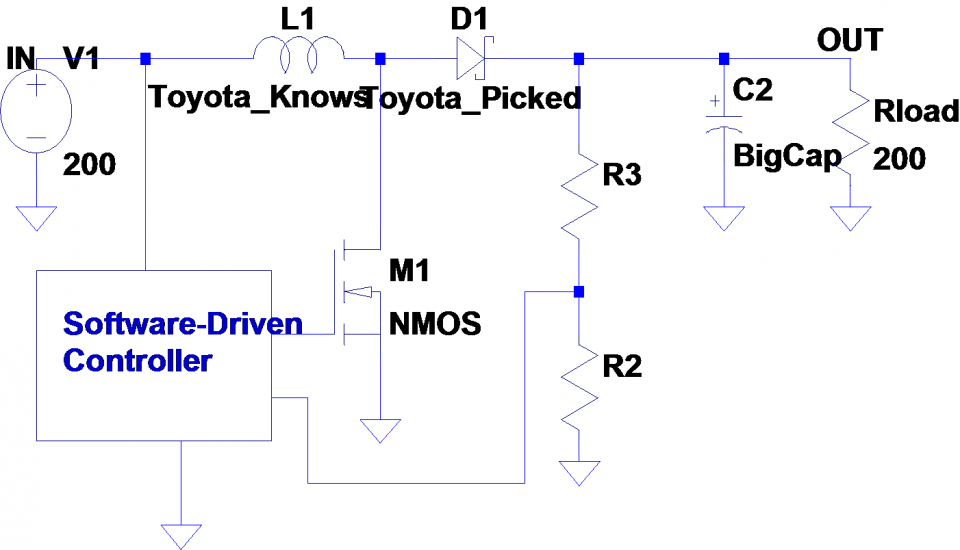

    So, here's the simplified schematic of switching boost regulator:
    Now, we get to the good stuff.
    Case #1: We're not doing a boost. The controller keeps the FET, M1, off. Current flows out of the battery, through the inductor, through the diode, and into "Rload", which I'm going to claim is everything that makes AC voltages for the motors. (I'll do how you make DC into AC at a later date. Yes, it involves lots more trannies, inductors, and what-all.)
    Case #2: Making 600 from 200. Hang onto your hats, here we go.
    1. Start: We turn M1 on, ideally, really, really fast. Suddenly, L1 has 200V on one side and 0V (the on transistor) on the other.
    2. Remember that bit where inductors don't like step changes in current? Well, that happens here. The current going through the inductor starts increasing madly, also making the magnetic field around the inductor bigger and stronger.
    3. The voltage on the anode of the diode, D1, goes to zero volts, right along with the inductor voltage. This is where the diode shows its mettle: There's still roughly +200V on the cathode of the diode, thanks to our handy capacitor which isn't letting its voltage droop much. The D1 is reverse biased, so no current flows from right to left.
    4. Current is flowing like mad out of the capacitor into the load, but that's what capacitors do. The cap is keeping the output voltage stable for the moment.
    5. I want to note at this moment that, while we're having fun putting energy into the magnetic field of the inductor, no power is actually being dissipated. (Well, a little in the transistor, but power = I*I*R, but R is as tiny as the engineers can make it.) If nothing is actually getting warm (and a changing magnetic field doesn't warm anything, particularly), then we're not dissipating power.
    6. Now comes the magic: We turn the transistor Off. Let's just say that we have twice the current going through the inductor at the moment we do this than in the steady state in Case 1.
    7. So, what happens? Well, the current though the inductor has to go somewhere, and that somewhere is through that diode. The inductor suddenly develops a voltage, negative on the left, positive on the right, and
    8. Whammo! that diode becomes forward biased right quick, the energy in the magnetic field that we just stuck in there gets converted into a current that (a) keeps the load happy, with one-half of our current out of the inductor going there and (b) the other half of that current going into the capacitor, charging it up and making the voltage across it bigger.
    9. Before the inductor's quite finished discharging, we repeat the process.
    10. Result: The voltage across the capacitor and load goes up. Since I said that we switch the transistor off at the point where the current out of the inductor is twice the normal load current, the voltage will rise towards 2X the original voltage, 400V. If we wait for the current to reach 3x the nominal load current in Case 1, we rise towards 600V. (Niggling experts will point out that it's the average current though the inductor that counts.)
    11. Usual trick on the controller is that it generates a pulse train at a fixed frequency. When it wants more voltage/power coming out, it increases the pulse width of the pulse train, forcing more current through the inductor when M1 is on. This is one reason that a boost converter like this is called a PWM (pulse width modulated) power converter. (There are frequency-type converters about.. Doubt if the Prius is using one.)
    Weirdly enough, the efficiency of a switching boost power supply like this, PowerOut/PowerIn, can be up in the 90% range. Discharging and charging magnetic and electric fields are, in the first order, non-lossy things to do.

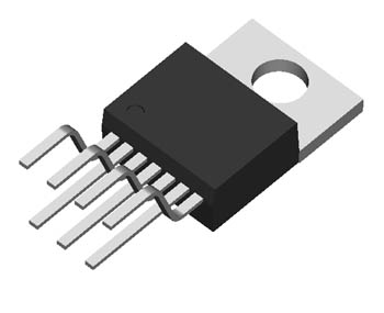

    Now, consider what a typical one of these power transistors looks like. It ain't no ball grid array:
    That's a slab of metal on the bottom of the transistor: Your actual transistor in the Prius may not look exactly like this one, but that Big Metal Tab on the bottom is not for looks, the silicon transistor is pretty much welded to it, under the black plastic. The idea is that the silicon transistor dumps it heat into that slab of metal, and the slab of metal is soldered to the heat sink. Metal everywhere, got it? Great thermal conductivity to the coolant, right?
    So, what they're getting is cracked solder joints on the bottom of the power transistors.Amazing. What that means: When the boost is first turned on, so much heat gets dropped onto the transistor tab that said tab expands, before the heat sink warms up and it expands, too. Stress builds up, and enough stress to break the transistor off the heat sink. Which also breaks off its electrical connection as well.

    Therefore, I am going to suggest that the Boost Converter problem in the Gen3 is not hardware related.
    I agree that it almost certainly uses IGBTs (rather than diodes) to control the power out of the inductor into the capacitor as per your diagrams and explanation. This will presumably allow for the regeneration mode to operate, but even if not, it provides for greater efficiency and more control. So, for the sake of the discussion, let's say that D1 is now replaced with M2, another IGBT that controls the current out of the Inductor (L1) into the Capacitor (C2).
    What I'm going to suggest is that the issue is a timing problem with the switching of the IGBTs, somewhere.
    I agree that it's likely to be a PWM system, and that the pulse width of the signal to M1 increases to increase the power / voltage to C2. With D1 replaced by M2, another signal is required which switches M2 On at the correct times to allow the voltage / current from L1 to discharge into C2.
    Now, what say they made a miscalculation in the timing of the signal driving M2?
    For example, what would happen if, in going to full power, as the signal driving M1 gets wider (longer, as it will), the signal to M2 doesn't move out correspondingly?
    At some point, both M1 and M2 will start to overlap, so that both devices are momentarily ON together. This may only be for a nanosecond or so, but that is not good. Instead of a controlled flow of current out of the inductor into C2, what will happen is that 650V DC from C2 will start to flow in reverse through M2, and through M1 back to Ground (the other end of C2). This, effectively, is a short circuit across C2, through M2 and M1 in series, and as I know you can well imagine, massive currents will start to flow.
    This is the kind of current that could easily lead to "deformation" of the IGBTs, which I interpret as marketing speak for transistors going BANG!
    AND, it may only happen in extremely rare conditions, due to a tiny software bug, which can be so easily fixed by a software (firmware, if you will) update, as they are doing.
    I can't say that this is the specific problem - it could also be the opposite, where M2 is being turned on late, allowing excessive inductive spike voltages to be developed across M1 (and to some extent M2), but this fits less with the description involving "deformation". This kind of overvoltage on the IGBTs would cause high voltage breakdown, which damages the transistors in a slightly different, often more subtle way, leading to loss of performance, and eventually, most likely, a complete breakdown as above.
    Whatever the problem is, it doesn't really matter, so long as the fix is correct, and there is some kind of testing to determine that the IGBTs haven't been degraded, and there is some kind of Warranty Extension to cover failures in this area. Would you agree?
