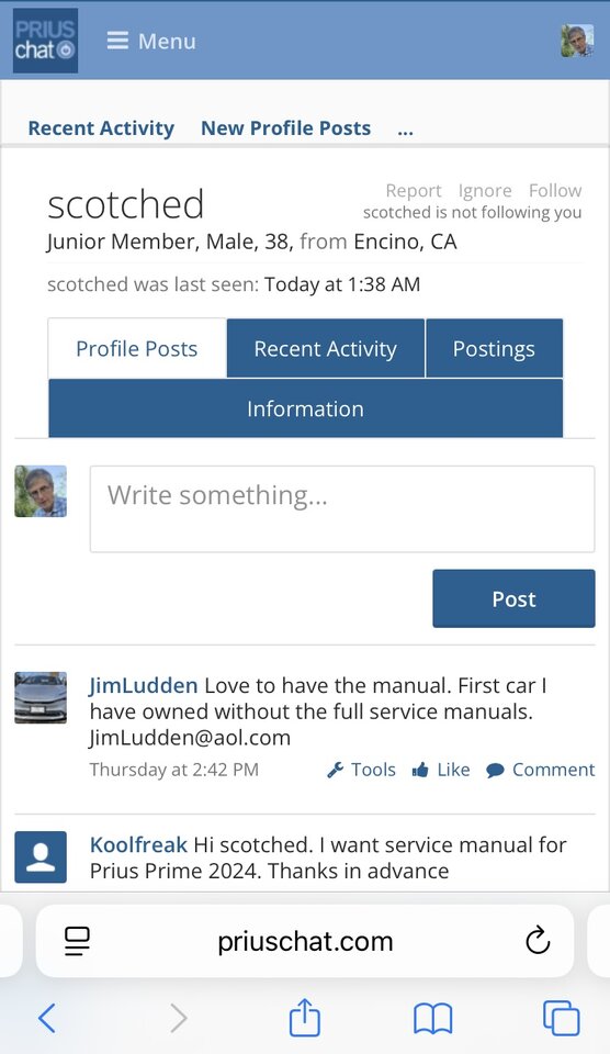

    could you please guide me a little in how to send a privet message to scotched. This message board is not as intuitive as other message boards i am a member of. I see an option "start a conversation" but i do no think this is it. Thank you in advance.

    The Start a Conversation is the right way to initiate a Private Message. Semantics.

    You could click on first word in post #47, then enter a message in “write something” field. Looks like lots are doing that.
