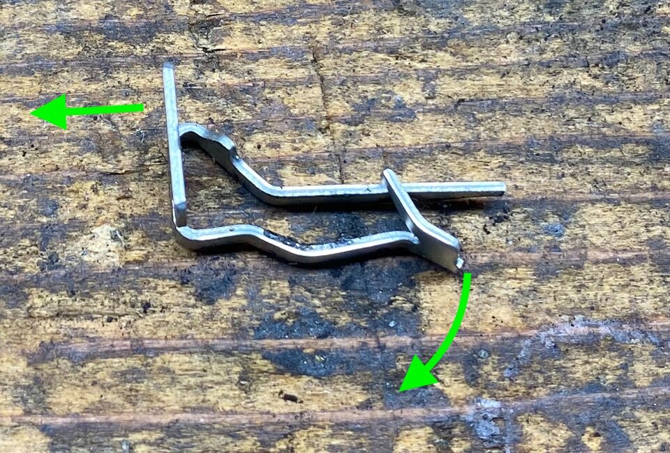

    Pedal Retainer Clip
    My brake pedal to actuator retainer clip looked different than most video I saw. Still goes through the pin hole but need to pry the open end while pulling the clip.
    Normally not much of an issue but you are upside down body twisting position looking up uncomfortably while trying to figure this out

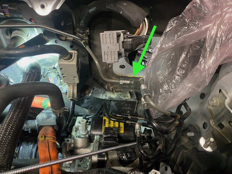

    Threading in the bottom most brake line
    Looks like many people have trouble threading this in ( link ) including me. I think the trick is not to tighten the 4 nuts in footwell area so the actuator can move a little.
    I finally looked from the passenger side and realize need to tilt the hard line tip (upwards? Can’t remember) to catch the threads.

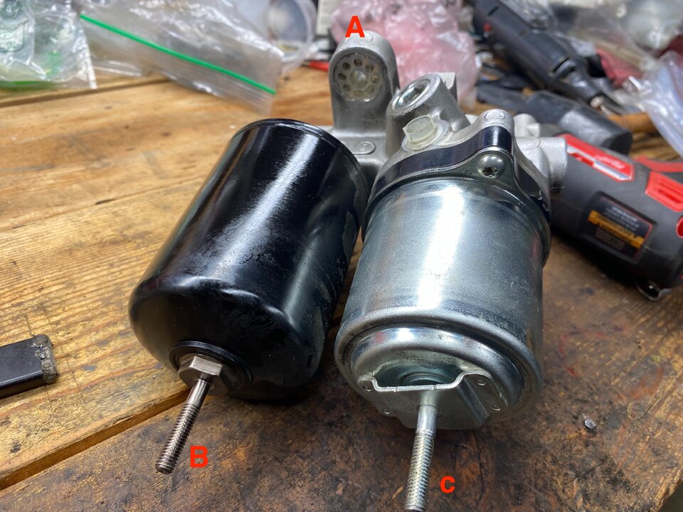

    Fought this thing for 2 hours doing it first time. Here is a picture upside down. Installation involves blind install the underside.
    Mainly due to
    • No space to remove and install the nut on B
    • Silicone bumper on A and B require sliding motion to install. Installing B easily cause A to dislodge and plastic clip to fall out.
    • B silicone bumper install/removal is blind underneath the unit causing multiple problems.
    • Removal and install requiring sliding towards the passenger side with a plastic hose clip and wiring harness blocking the travel. During install, unclip the hose clip to make more room. Can’t unclip the harness as the release require blind access on the backside.

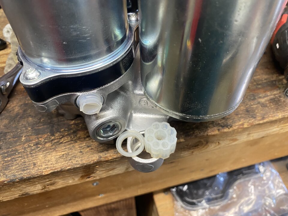

    Silicone bumper A
    This bumper often bind and stays on the metal shaft for first timers not knowing the sliding angle. When this happens, the plastic stop inside falls off and drops. Luckily found it on the belly pan.
    Installing this is blind. Shaft can easily go into one of the surrounding revolver cylinder holes. Need to inspect with mirror+light after both A+B bumpers are in to confirm properly installed.
    Silicon bumper B
    When install this bumper, very little space and access. Natural to pull the unit towards passenger side to create more room. This cause A to come off its shaft… and losing its plastic stop.

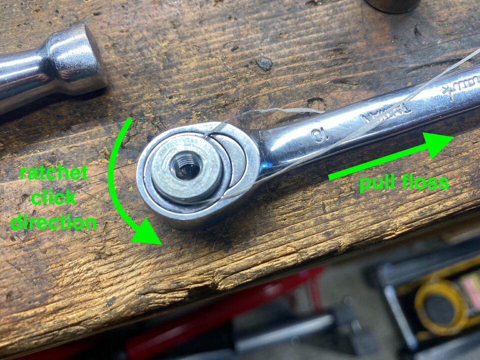

    Install nut on bumper B shaft

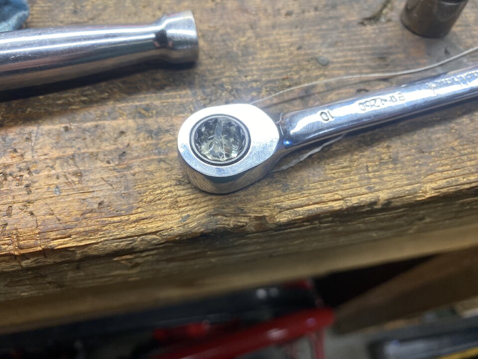

    Quite impossible to thread the nut onto this shaft. Finally heard of the dental floss trick and it worked like magic.
    • Nut is hot glued onto the 10mm ratcheting wrench to avoid losing from falling out
    • Floss is wound 4-5 loops so when its pulled, the ratchet rotate clicks
    • Just place nut over the thread and pull the floss
