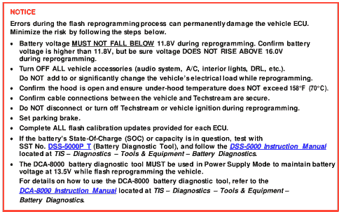

    That news does not please me, as (at least here in the US) Toyota has released a sequence of TSBs laying out increasingly stringent precautions for reflashing. The latest one that I know of (it is hard to keep up!) is T-SB-0134-16 Rev2, which includes this list:
    I try to remember to pull my own fuses for electrical accessories I have added before driving in, as the dealer technicians would not know about them.

  10. Lares_Mat
    Lares_Mat Member
    May 17, 2014
    199
    59
    Oh boy!
    Good, that I did not know about most of these precautions!
    Now I can say, he dit it "without hands" :eek:
    My 12V battery is _not_the_best_ - this is, why I kept my fingers crossed...
    The AC was off (I switch it usually off before turning the ignition off), but navigation was on.
    The hood was closed, the temperature thereunder was below 70 degrees C for sure.
    No parking brake.
    Maybe he checked the SOC via TechStream - maybe.
    No DCA-8000 ;)
    But - it went OK!
    I doubt, he is doing the job for the first time, so, possibly the precautions are _very_ conservative?
    Now, as I know, how it should be done, I will think twice, before I let them do anything like updating on my car...
    Mat
  11. ChapmanF
    27,737
    18,323
    I'm sure the recommendations are conservative.
    One big attraction of letting them do the work, whether they follow the conservative precautions or not, is if the ECU doesn't work when they're done, they have the honor of supplying a new one.
