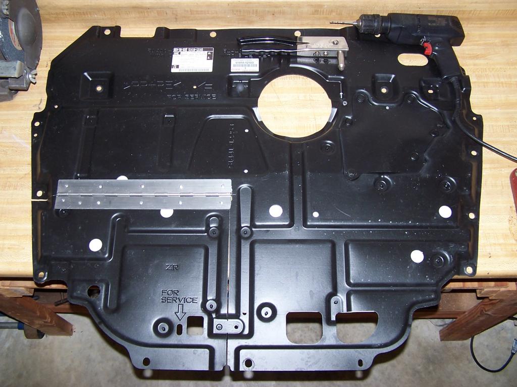

    Actually, it's more complicated than that. I found a picture of the improved part 51410-12103 posted by Den49 in this thread: Oil Change Door - Permanent Solution | Page 2 | PriusChat
    It clearly shows the transaxle holes covered. While the part I have 51410-12104/51410-12105 (not sure which) has them uncovered. Weird!

  8. Den49
    Den49 Member
    Oct 25, 2010
    498
    272
    Maryland
    The odd shaped approximately 8"X9" cover you are seeing in the upper right corner of the above new engine undercover photo is one that I fabricated to cover the two openings in question. It did not come with the new engine undercover. I did it as an experiment. Those two openings allow a lot of road debris to come up into the engine compartment. The openings also seem to counteract the thermal insulating function of the undercover by letting in heat from the road in the summer and cold in the winter. It seems to be working as intended with no negative effects. If you look at those openings, you will notice that they appear to be made to accept covers.
  9. Former Member 68813
    Oct 3, 2010
    3,524
    983
    US
    They sure do. Den49, thanks for explaining the little hole mystery. Since my new cover is labeled "with silencer" I'm thinking what we are referring as thermal insulation could be actually sound insulation. No wonder Prius' engine is barely audible, unless pushed to work hard.
    I'm going to leave the holes open, sounds like they can help with tranny cooling. I live in hot climate. I can see why people in arctic climate may want to cover them.

  11. Mendel Leisk
    61,533
    42,345
    Here's a pic of the older version of the undercover, for comparison. This one is viewing the face that's towards the engine, so mirrored from above. 5D_054-007.jpg
  12. xs650
    xs650 Senior Member
    Jul 2, 2010
    4,539
    1,436
    Northern California
    If those black patches are sound absorbing material, that explains the "with silencer" nomenclature
