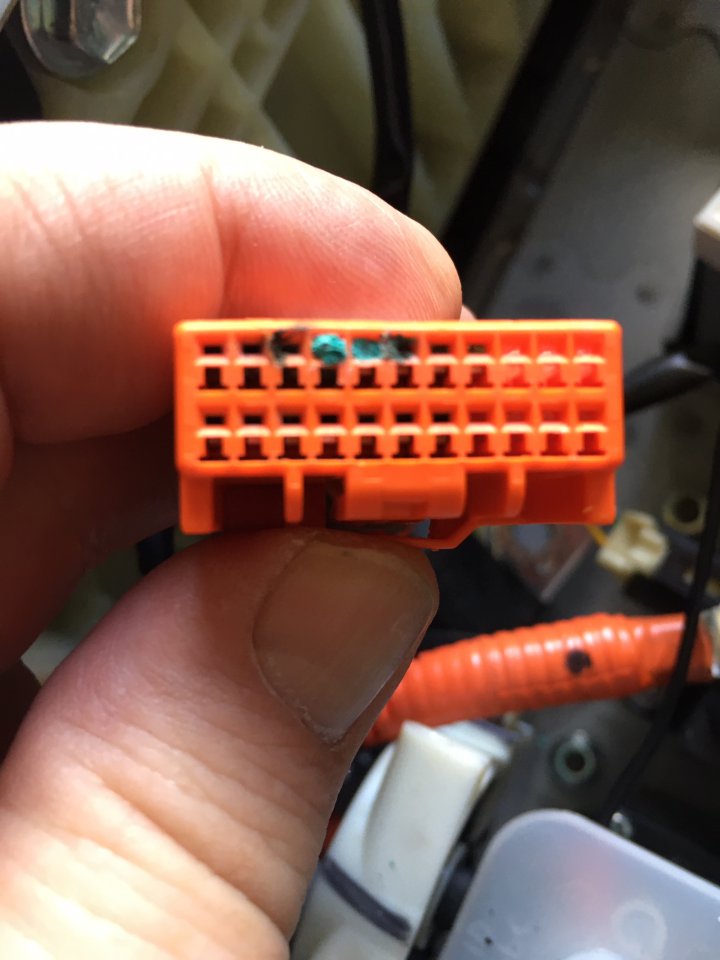

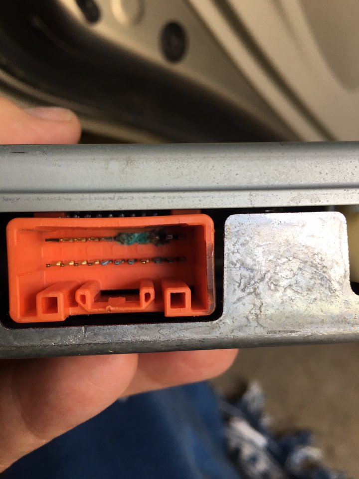

    For DTC P3000 that points to the HV battery assembly, have you checked the connections for corrosion, including the HV battery ECU?
    Have you read this thread? : Help! Prius 2007 error with P0A78 P0A7A P0A94 PA040 PA041 | PriusChat
    If you have the back apart, check for corrosion at the HV battery fan connectors (and clean the fan if needed) :
