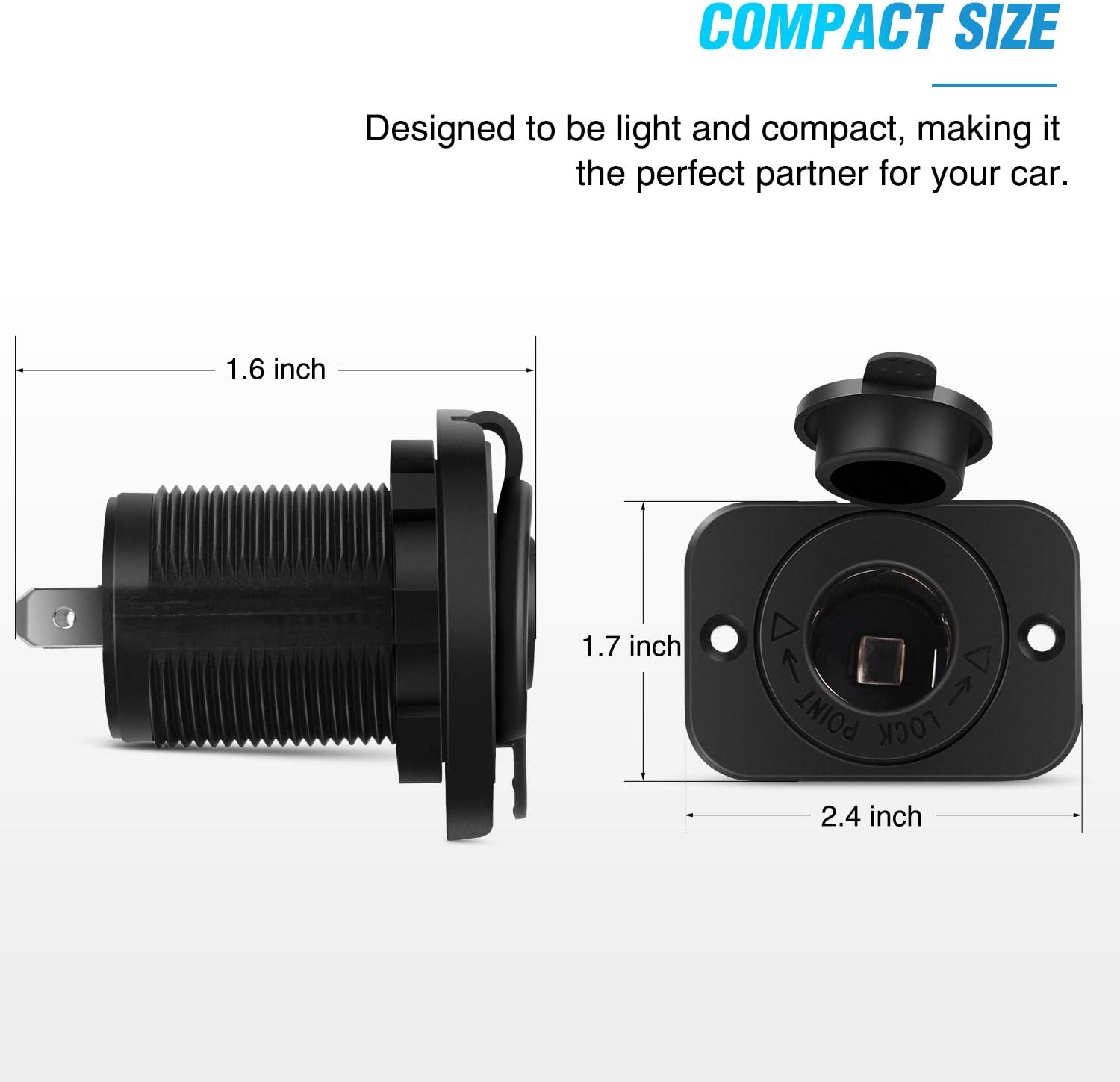

    Do you remember if there's space in there to splice one of these in (without that mounting plate it comes with) and leave it in there with a USB PD charger plugged into it?
    12V DC socket:
    USB PD charger:
    It's going to be for a MagSafe charger that will be semi-permanently mounted.
