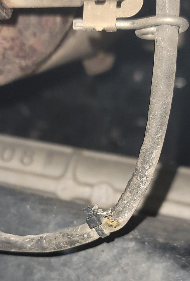

    Pretty sure that was it. I don't know if this is "normal" but there's a tight zip-tie on the O2 sensor cable. It cut through the insulation over time. :(
    Since a complete replacement is ~~$100+...
    As an Electrical Engineer myself, comfortable with making and rebuilding cables for decades...
    • Is it reasonable to attempt a repair? (I'm thinking: disconnect each wire from the big connector, use high quality waterproof / adhesive shrink tubing to seal it up, and reassemble.) OR
    • Is it likely the water intrusion has caused some kind of harm to the sensor itself, and it's just not worth trying to save $100... buy a replacement.

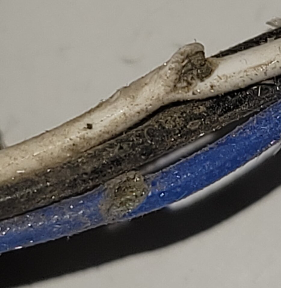

    Something chewed through the O2 sensor signal (blue) and ground (white) wire insulation. No wonder getting wet caused issues!
    Fixed... hopefully for a long time to come.
