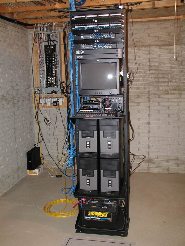

  3. Judgeless

  17. Judgeless
    Judgeless Senior Member
    Jun 30, 2009
    1,821
    257
    Cleveland, OH
    A 1KW generator is 1/3 the size of engine used on a lawnmower. It is close to the size of a weed eater. It might make a little less noise but less then a hair dryer. I think you are thinking of a big generator that needs wheels. 1KW is q few pounds and super small.
    The servers take up all the space. The inverter and batteries use very little space. A lot less than Prius takes up in the garage or the driveway. This entire setup is less then size of a filing cabinet.
