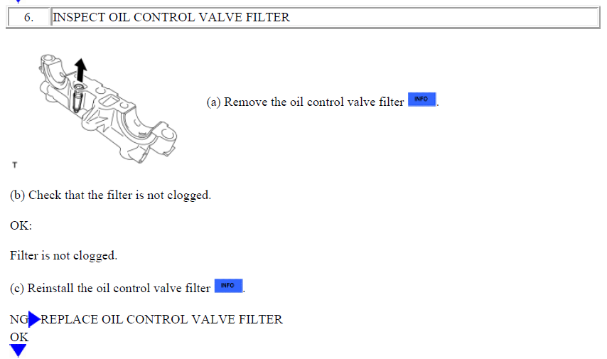

    Northern California
    The post with the Gen3 filter location (below) doesn't offer easy access. Hoping @Mendel Leisk can update us with any new knowledge.

    Looks like valve cover has to come off. Probably good idea to buy a new valve cover gasket at the dealer and an excellent time to replace the pcv valve as its screwed into the valve cover. Easy to take that valve off with the cover off the engine. of course the cops have to come off and when you do pull them off take a picture of the spark plug well see if any oil is seeping into that hole which is pretty common. the new gasket will fix that. Its like $17.
  12. ChapmanF
    28,742
    19,039
    Also, be careful and observe the torque specs when removing/reinstalling the cam bearing cap.
