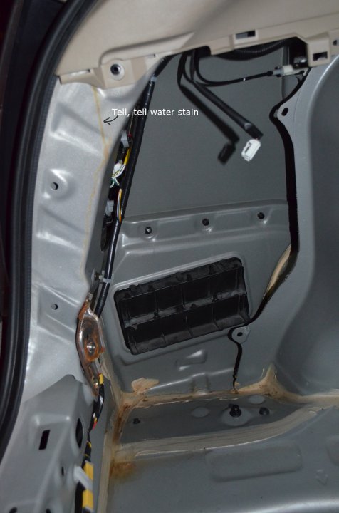

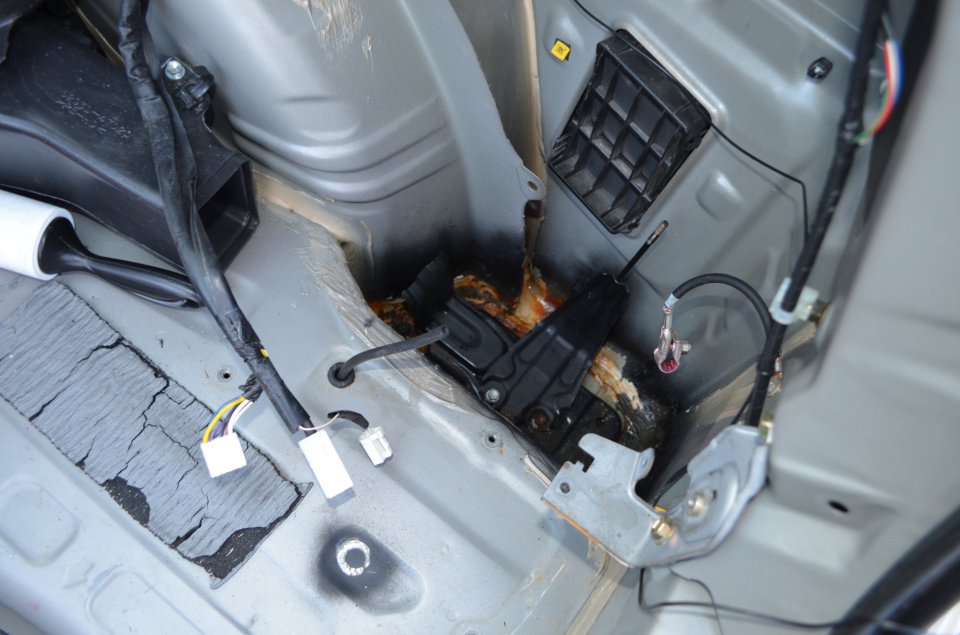

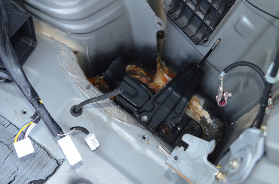

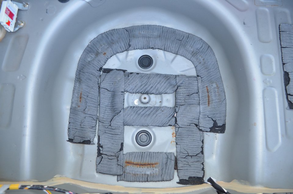

    Replaced my spark plugs today, and when I disconnected the 12V battery, found a surprise.

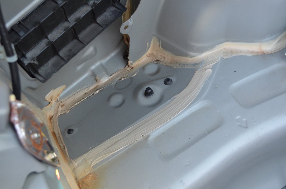

    In the 12V compartment, there was ~1 to 1.5 inches of water in the bottom, and rust. After removing all the pans, trim, and spare tire, I found ~1 inch of water in the spare tire well, and~0.25 inches of water in the left compartment (where I usually store small tools). So, all three of the low spots in the rear of the vehicle were wet. Checked the gasket / weather seal of the hatch, but it seems like new. No deformations, or damage, and is just as pliable as it was 10 years ago. The only evidence I could find it a stain left from a water trickle on the left.... but could find no evidence on how it could make it from the left, to the spare wheel well, and then to the 12V battery compartment (where the most water was found). I have uploaded some photos, from left to right, with "Left2.jpg" showing the water stain.
    Has anyone else had their hatch leak, and in such an odd fashion?

    very common. it's usually a seam weld between panels, or the hatch hinge points. one guy did have a broken rear windscreen washer line though.

    Yep u probably have a body seam leak.
    Right next to the hatch hinges in the corner valley you will see where the quarter panel meets the roof and the seam is not painted over .
    It may be a crack also that travels from there to under the black plastic trim piece that covers the roof valley. That just pops off.
    In the meantime take out the black rubber plugs under the spare tire so the water can drain out.
