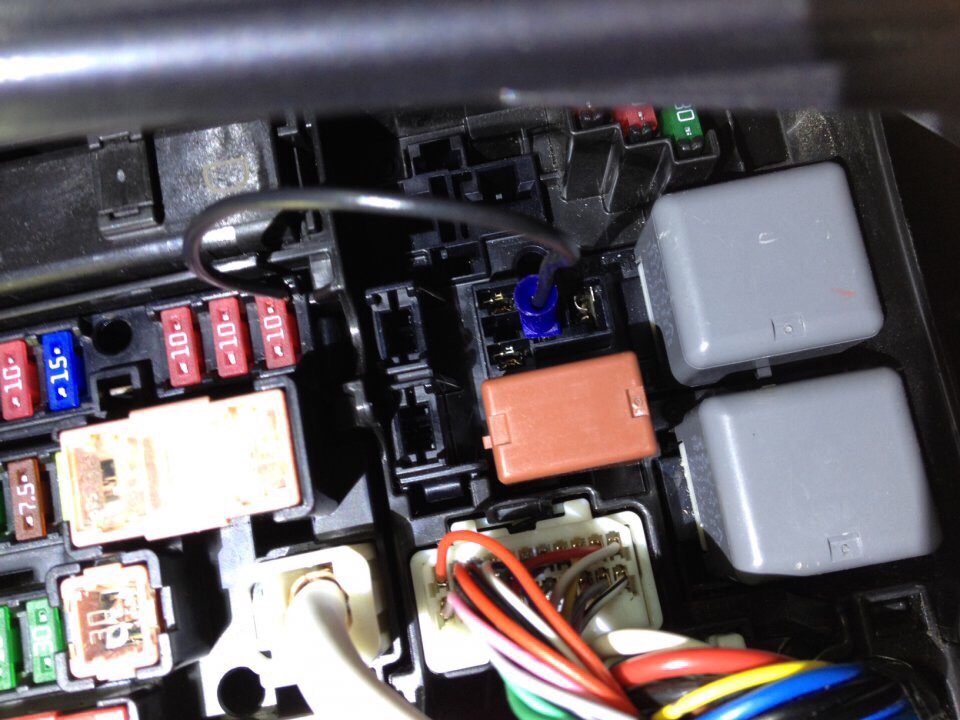

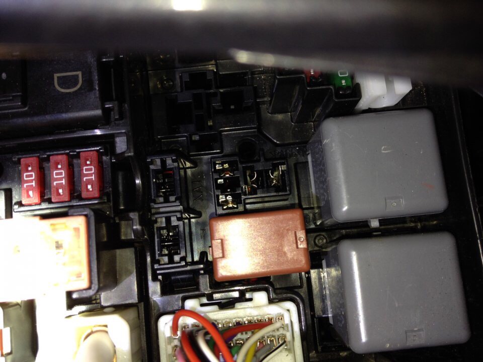

    Here's where I found the link from a previous thread... So basically your running constant power to the led relay...by doing that your taping in to a fuse with constant power as shown on the diagram. Follow instructions on the previous post and u shouldn't have any issues... [​IMG][​IMG][​IMG][​IMG]How can I mod the DRL to have it on at all time? (for 2013 models) | Page 3 | PriusChat

    So without the mod how does the DRL work? I always thought DRL's were on any time the car was in gear.

    Without the mod the DRL on the 2012 prius only works when it's switched to DRL mode. When the low beams are on the DRL turns off. With the MOD your providing constant power so when the prius is on "ready" the DRL is on, as well as with the low beams being on.

    Only works when head light is not on

    Exactly @Xterra72

    But with this mod it's on with the headlights being on
