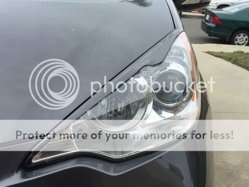

    Headlight eyeliner fitting, the final VHB stuck on pic looks basically the same. I'm happy with the differentness of the look.

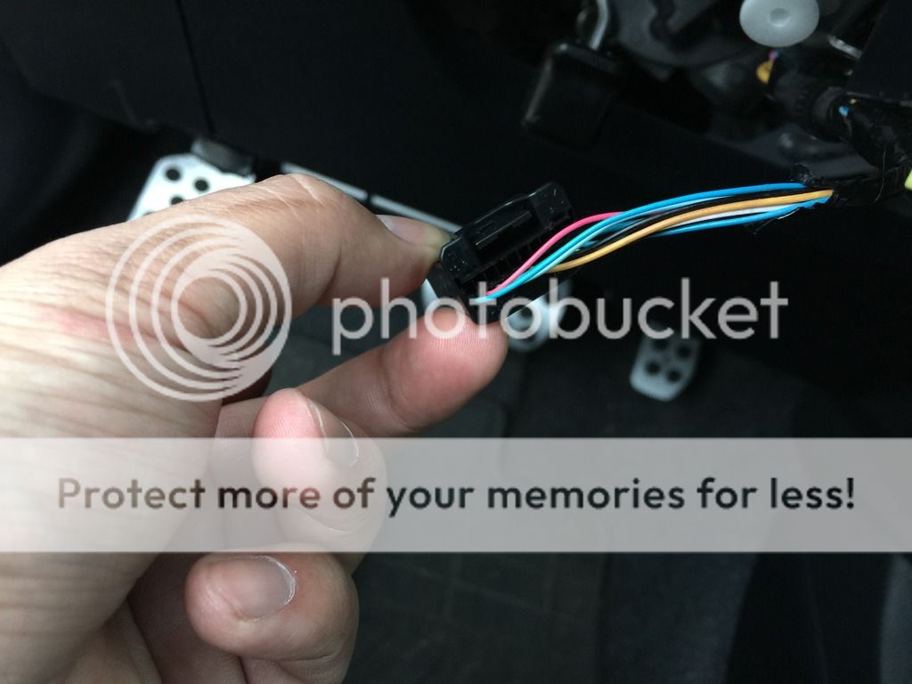

    Haven't completed this yet, but tapping the Lt Blue ground line that enables the headlights. While I was swapping out the steering wheel and the battery was disconnected, it was a good chance to get at that connector. Finished miniaturizing the external relays and making a led indicator for when the auto headlight function is on, but haven't gotten around to putting it in. Images of that here if curious.

    The mini ckt is me wanting to make the rest of it smaller, but I used this thread as a dominant source for what I needed and for that lt blue gnd line to enable headlight on. Plug N Play Auto Headlights for the Prius C | PriusChat

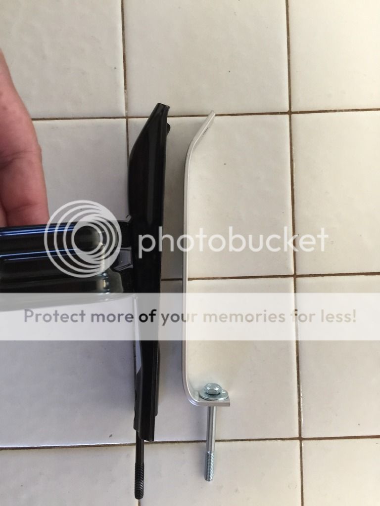

    Tried to replace original battery with yellow top optima battery but battery bracket not fitting
    After a quick trip to Home Depot, some effort with a vice, pliers, a Dremel, and a drill, one bracket that appears like it'll fit. I considered dremeling off the side of the bracket that was in the way, but I didn't feel like dremeling steel.

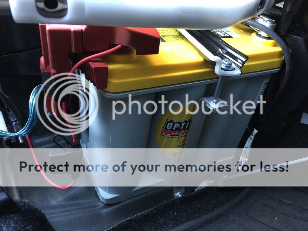

    Battery held in place with a properly fitting bracket.

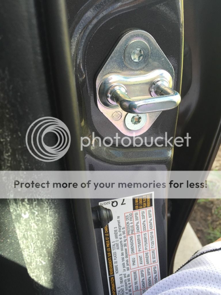

    Original door locks

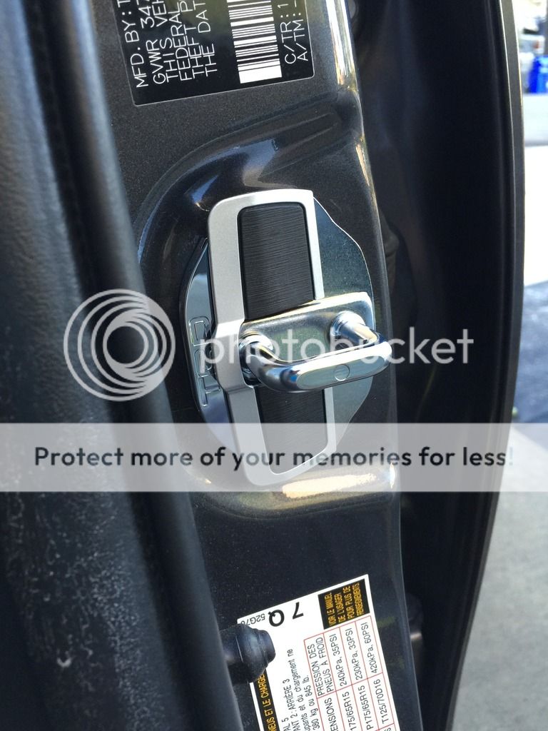

    TRD Door stabilizers installed. For anyone curious, I notice very little difference with them in. Maybe I'd notice if I actually drove my car more aggressively.. however, it's still a Prius. Mostly blingy, luckily I got them 2nd hand.

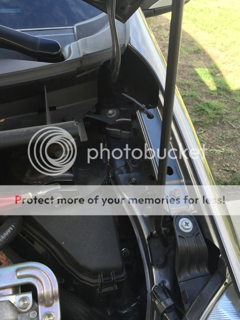

    Before Hood Dampers installed
    Hood dampers finally installed. I got these some time ago via the trade forums, just got around to putting them in.

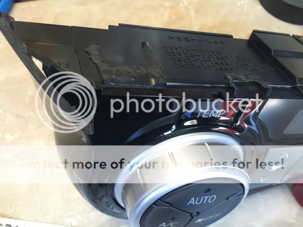

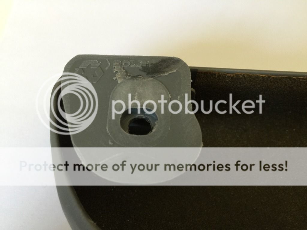

    Bits of the 2015 AC control I had to cut off to be able to fit in my 2014 properly.

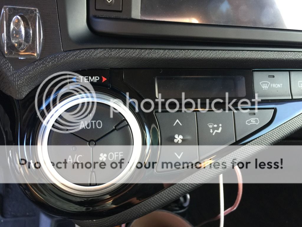

    New AC control installed

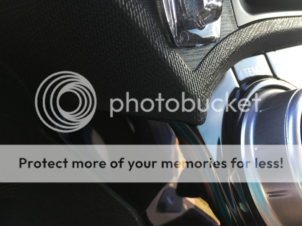

    Side shot of mostly flush AC controls. I'm happy with the new dimable screen and matching with the steering wheel pianoness. Credits to TheTimob for being a guinea pig and trying this out first. Original thread here: Climate Control Unit Change - 2013 to 2015 | PriusChat

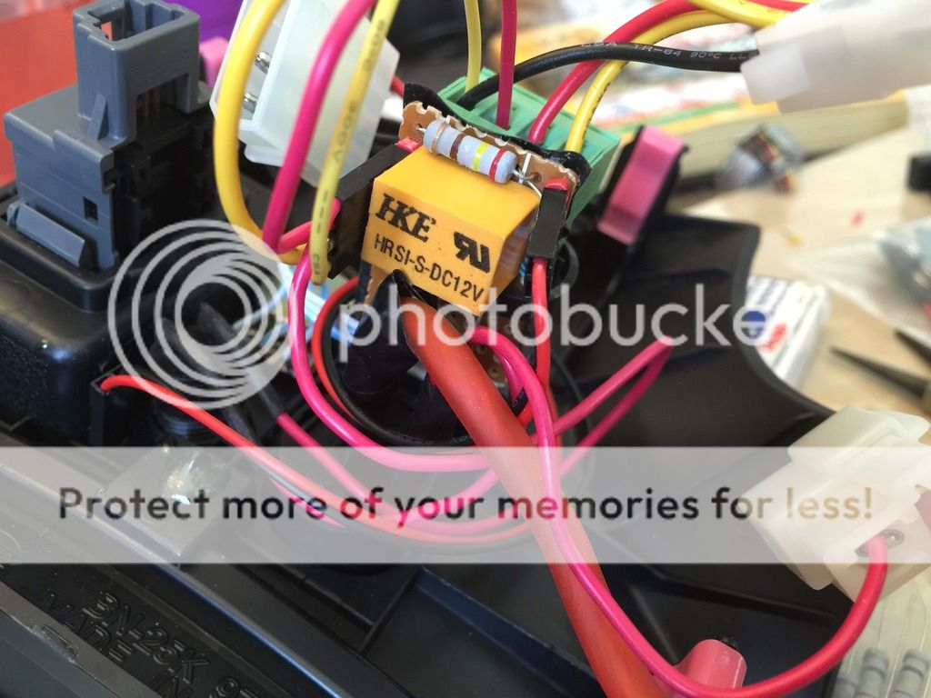

    PWM module via eBay to dim red lights
    Opposite side of the PWM. Relay that enables the PWM to turn on, turning on the red footwell lights,when the fogs are turned on.

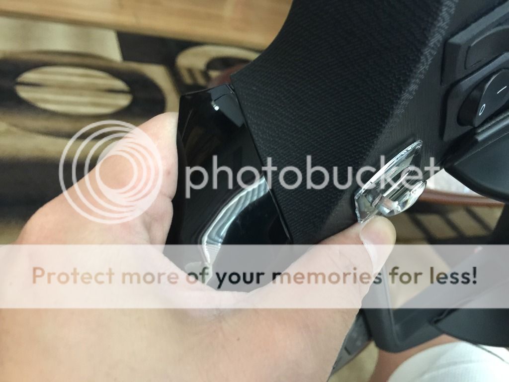

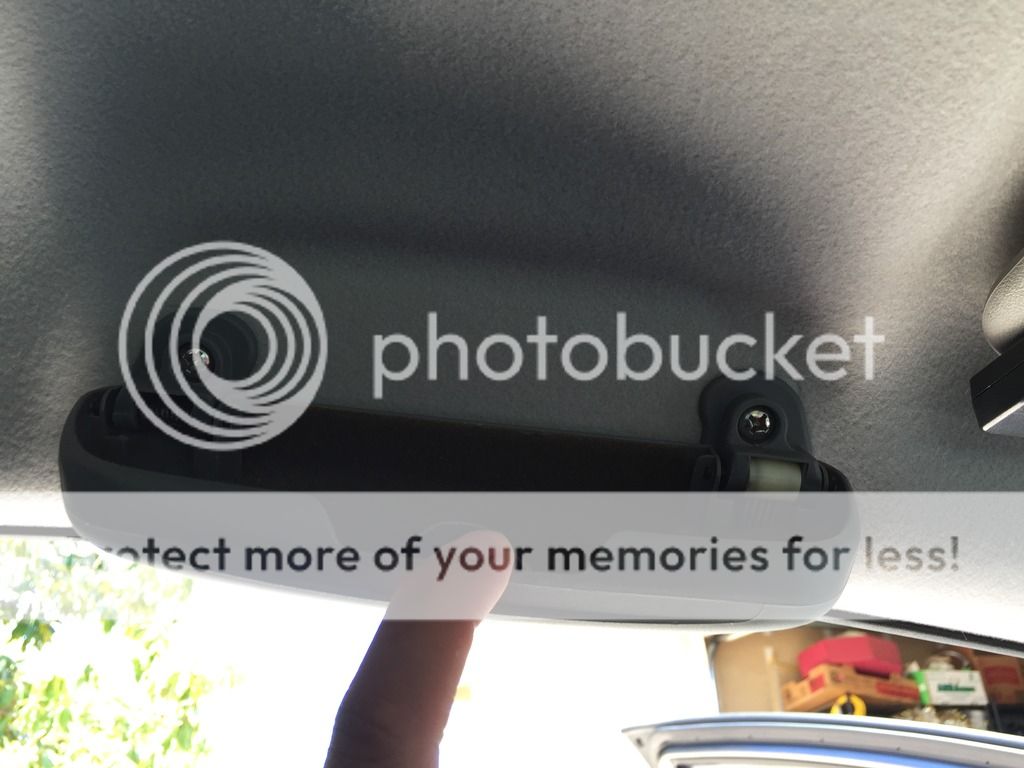

    Overhead glasses storage to replace handle that never gets used.
    Bits i needed to cut off to make it work

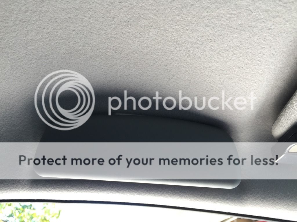

    Overhead glasses/sunglasses storage closed. Nifty. For those interested, I used a Suzuki glasses holder, part number 78114-85Z00. I got the idea and part number via this thread: Grab Handle Sunglass Holder | PriusChat

    I was looking into eye lids for my c also. My friend in Japan said currently there isn't any for 15-16 models. I'm looking into the trd door stabilizers also. The price tag isn't appealing to me just yet rather invest into a strut bar. Other than that looking good

    You did a lot! Where did you find the eyelids?

    Strangely for me I found mostly the 2015+ models. I almost got the wrong one because the 12-14 ones have a weird reflective bump half way up, I assume for DOT/legality reasons we can't cover that up so I chose to get one that left it exposed. There is one that full on covered it though. From when I looked around, the 2015+ later models are smooth and have options for a more distinct and cooler looking brow. Some are less pronounced. Here's one for example.
    http://item.rakuten.co.jp/carshop-nagano/airain_aqua_b368_color/
    Hiya, and thanks! Tbh not entirely sure where I got them, I tend to buy stuff over time and later install in bulk over summer/winter holidays, wife/family obligations permitting. I figure either amazon.co.jp or rakuten.co.jp.
    I didn't get this exact listing, but here's is one example. The prices I ran into at the time ranged from $80-$110 USD. This one seems to be on the mega cheap side.
    https://www.amazon.co.jp/gp/aw/d/B00HFLD4BY
    If it helps, here is the search parameter I used to find the eyeliner on Japanese sites. Nhp10 アクア アイライン
    "Nhp10 Aqua Eyeline"
