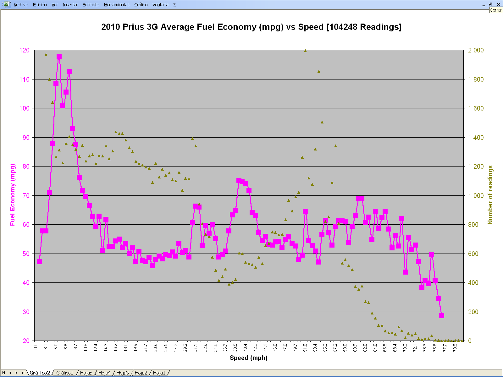

    Here is a graph by Frank Tiger of OBDII mileage.
    Graphics of average fuel economy vs speed | PriusChat
    (this, unlike Bob's theoretically best mileage, is Frank's actual mileage over 1 hundred thousand data points. You could do better or worse depending on driving skill)

    Thank you for reposting these graphs! Do I assume correctly that Franks data are the instantaneous car-computed mpg data he collected in normal driving?
    If yes, the high mpg point at 5-7 mph would be in part due to heavy use of the motor generators in that speed range, especially if he drove gently and the ICE was off for many of the recorded data points.
    The secondary peak at 40 mph may represent the maximally efficient speed with mainly ICE use that I am searching for.
    I would like to test steady-state 20, 30, 40, &50 mph and have found a level non-interstate multi lane stretch of road at least 7 miles long with no posted minimum speed limit where I can conceivably make the test runs using the approach Bob W suggested when traffic conditions permit.

    His peak near 40 mph is near the point where the Prius won't let you run electric only on level to downhill grades. I doubt it is related to the peak for the gas engine I would say it is an anomaly due to high state of charge from prior regeneration.
    If you want highest MPG on flat ground with steady speed it will be much closer to 20 mph. If you have the time to test I'd start at 10 mph and go up in 2 or 5 mph increments until you reach 40 mph. I think you'll find your peak below 25 mph.

    You would have to know Frank's typical cruise speeds, for me, I cruise at 61 and 48 MPH a LOT, so my MPG for other speeds would mostly accelerating though that speed, while MPG at 48 and 61 would be steady state.

    A British PC member pointed out that a steady speed of about 35 MPH yields 90MPG or so. The ICE comes on periodically to re-charge the battery. Using the battery advantageously can still results in big numbers.

    The chart may be right. My best ever fuel economy was filling fuel and resetting the trip meter on entering a state park where speed is limited to 35 mph. The 7+ mile loop in the park with speed never exceeding 35 mpg indicated 95 mpg average.
