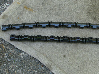

    The hose is connected to two long collecting tubes (28875 and 28876 in the picture above) that run the length of the battery, fitting over the safety vent valves on the modules. There are two tubes because the modules face alternate ways (− to + and + to −), and the vent valve is nearer one end of the module, so each collecting tube fits over the valves for half the modules.
    You can see that in the diagram, right?
    The two collecting tubes join into the single rubber tube, and that does not go to any "plastic container". It exits the car through a grommet right through the floor, pointed at the road.
    That's where any of the potassium hydroxide will go if any of the modules should ever vent.
    Do you want more pictures? This forum is teeming with pictures of people's battery disassembly projects. Why not search some up?
    later edit:
    Did you find the label 28885 in the illustration in #10?
    Photo by hobbit of the collecting tubes removed from the battery:
