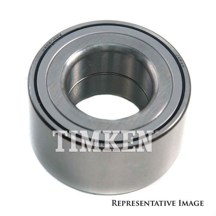

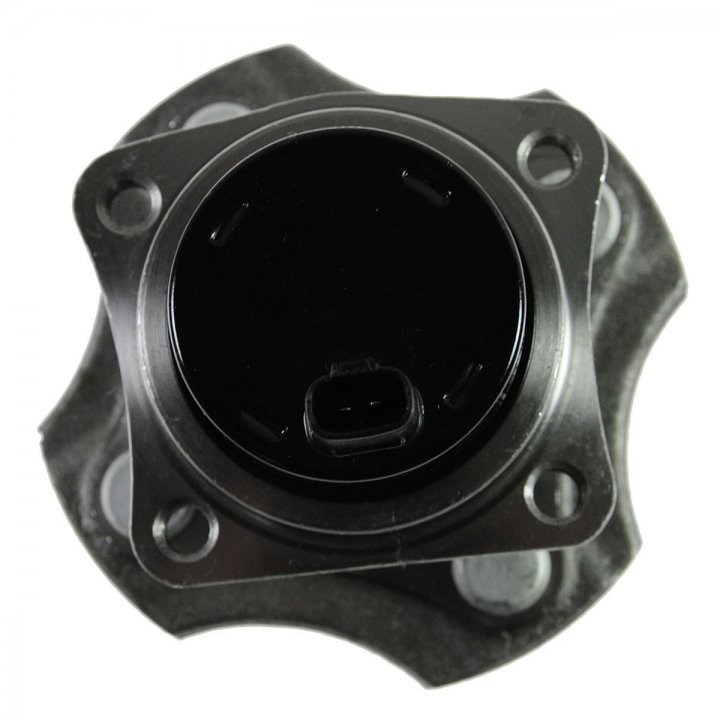

  10. aswresm
    aswresm Junior Member
    Aug 19, 2014
    2002 Prius
    I
    So which one of these two pics do I need to change my rear wheel bearings?
    Please advice ....Thanks

  11. valde3
    valde3 Senior Member
    Jun 28, 2014
    2,002
    751
    Finland
    Just like I and ChapmanF told gen1 Prius has generation 1 wheel bearings on front and generation 3 wheel bearings on back. Upper one of your picture is generation 1 and lower one is generation 3.

  12. 3prongpaul
    3prongpaul Hybrid Shop Owner, worked on 100's of Prius's
    Jul 18, 2010
    956
    735
    Boulder Hybids, Boulder, CO
    Too bad bearing design uses terms like Gen1 & Gen3. I bet this is all confusing for some Prius owners.
    Top photo is the style of bearing for a Gen1 Prius front wheel/hub. Bottom photo is for Gen1 Prius rear wheel hub.

  13. ChapmanF
    28,754
    19,061
    That about covers it. Don't forget that, if you're doing a rear, all you need is the rear hub assembly shown in the bottom photo, but to do a front you need the item in the top photo plus several miscellaneous parts that were listed in the other post I linked to earlier.
