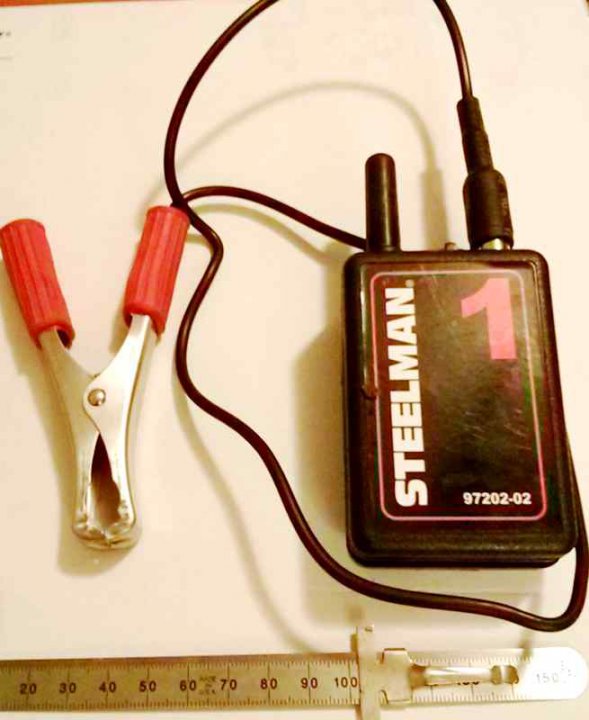

    Not as small as you might hope, and that limited how many directions I could choose for clipping them onto those bolt heads and not interfering with the wheels. They really look a lot like the standard-issue stamped spring clamps on cheapo 12V battery chargers, right down to the red ribbed plastic handles. I've got no doubt that's exactly what they are, and JS Products just buys them from Acme Cheapo Battery Clamp Company and jams audio pickups (very thin, probably piezo) under the springs.
    I was sort of wishing they had used the next smaller size of cheapo clamp, but then I'm sure you'd run into something chunkier you wanted to listen to and the jaws wouldn't open enough.

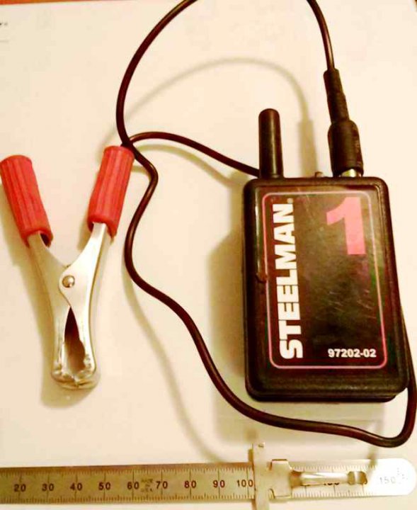

    Chap, can you pls take a photo or two showing a sensor and the wireless transmitter positioned next to a ruler? Thanks!

    Ok, I'll see if I can get to that in the next couple days.

    pickup.jpg Ok, here's what a pickup and transmitter look like.

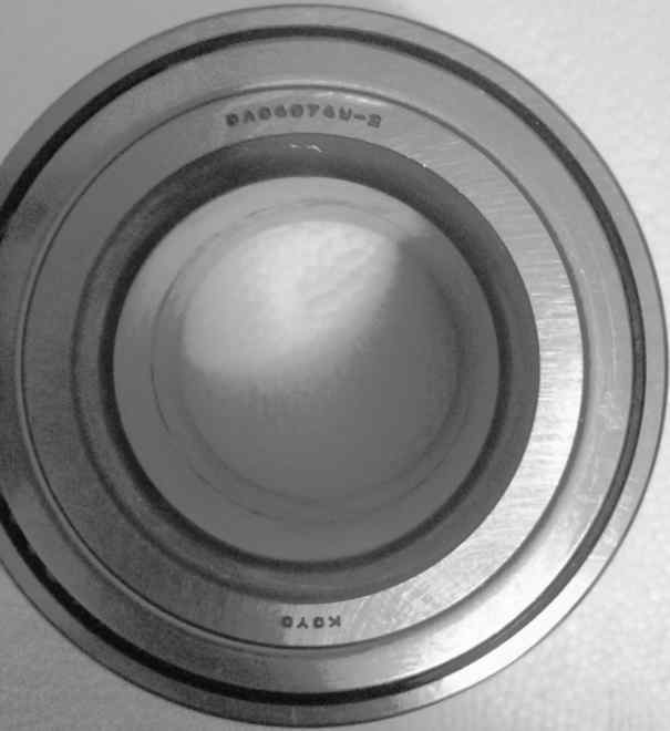

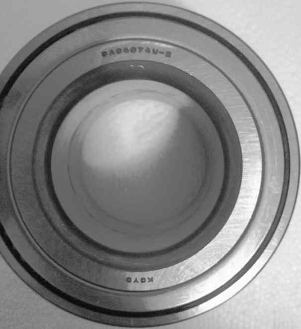

    newfh.jpg Here's a new bearing fresh out of the box. Everything's nice and quiet now, so the left front was definitely the one. That means the temperature test really wasn't effective for tracking down this problem: the hub on the bad side actually showed up a couple K cooler than the one on the other side. I was aiming an IR thermometer at the hubs through the wheel center holes. Maybe it would have been better to crank the steering and try to get behind the wheel and aim at the knuckle near the speed sensor, I don't know. There always seems to be a little drag with disc brakes, and that might just heat the rotors enough to mask any bearing effect unless it's really bad.
    By comparison, the multichannel sound pickup was dramatically effective in identifying the bad bearing.

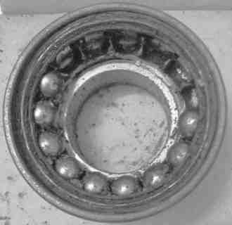

    I was curious about the inner details of the bearing, wondering whether the sound I heard in the cabin (at a frequency around 12.8× the wheel revs per second) might be a reliable characteristic. Conveniently, when the machinist pressed the hub out, one side of the split inner ring stayed with the hub, leaving the bearing open to view:
    He didn't save me all the balls that got away when it came apart, but it's easy to count the empty spaces in (what's left of) the plastic cage, and see this is definitely a 15-ball proposition. (Per side - this is an assembly of two matched bearings back to back, in a one-piece outer race.)

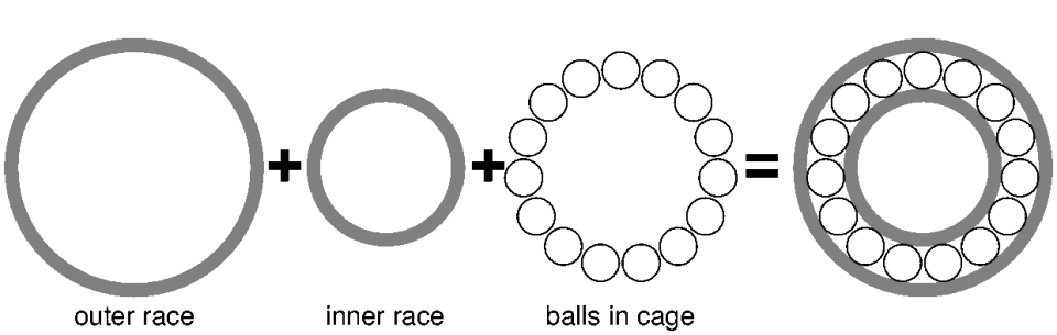

    My quickie measurements are 5.55 mm for the ball radius, 34.65 mm radius of the outer race, giving 23.55 mm for the radius of the inner race (which I didn't get back from the shop to measure directly).

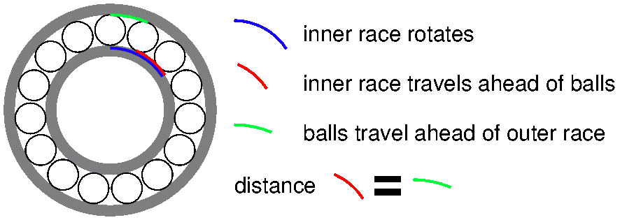

    In this application the outer race is fixed, the inner race goes around at wheel speed, and the ball cage goes around in the same direction as the inner race, but more slowly. In an earlier post I was half-convinced that the cage speed would be ½(wheel speed)(inner race radius)/(inner race radius + ball radius). Now I'm more than half convinced. Think of spinning the inner race clockwise by some amount, for convenience let's say one radian:
    The ball cage rotates less far, so there's a difference (shown in red), the distance the inner race got ahead of the cage (by rolling under the balls). The green distance is how far the cage advanced along the (nonmoving) outer race, again by the balls rolling. In a good world the balls don't slide on either race, so the red and green distances are equal.
    We spun the inner race by one radian, so the cage went along through some angle θ < 1. The green distance is just θ(outer race radius) and the red distance is (inner race radius)(1 - θ). For outer race radius substitute (inner race radius + 2 × ball radius), set the distances equal, and find θ = ½(inner race radius)/(inner race radius + ball radius).
    Plugging in the dimensions of this bearing, the cage goes around at ½(23.55)/(23.55+5.55) ≃ 0.405 × wheel speed. There are 15 balls, so if there's some defect on the outer race, it's going to get whacked at (15)(0.405) or 6.075 × wheel speed. That's not very close to the 12.8 I was hearing.
    But what if I was hearing the second harmonic of it? 12.15 is sort of in the ballpark. And there's some room for slop, seeing as I got my 12.8 by ear matching pitches with a tuner, going by the speedometer display and the nominal revs per mile of my tires. But I'd prefer not to have to handwave away more than 5% of slop....
    But there's one thing about this bearing I've left out. It's an angular-contact ball bearing. The races are shaped with higher shoulders on one side so the bearing handles thrust along the shaft axis, and not just radial loads. That means the balls actually don't roll in the same plane as the bearing, but at an angle to it:
    And that means, effectively, the outer race radius is a little smaller, and the inner race a little bigger, than what I physically measured. The radii that matter are where the races meet the green line.
    What that angle is, I can't easily measure. A Koyo document gives standard contact angles for their bearings as 15, 30, or 40 degrees. If I had to guess, I'd guess 40 - the shiny path on the race goes pretty far down the shoulder. So what does that do for the dimensions?
    I'd better start by taking the cage radius to be my originally measured outer race radius minus the original ball radius (no correction yet): 34.65 - 5.55 = 29.1 mm. But from here out, my 'effective' ball radius is going to be (5.55)(cos 40), or 4.252 mm, and 'effective' inner race radius 29.1 - 4.252 = 24.85.
    Now the cage speed will look like wheel speed × ½(24.85)/(24.85+4.252), or 0.427. There are still 15 balls, now making whacks at 6.405 × wheel speed. I still think I could have been hearing the second harmonic, which is now, hmm ... 12.81. Now that, I don't feel a need to handwave away.
    So for those keeping track, if you find yourself with a speed-dependent growly tone around 12.8 times wheel speed (or g, c, and d, slightly flat, at 30, 40, and 45 MPH on stock tires), I'll vote for a front wheel bearing. I never got to take my old rear apart to see if the 10.8 I heard there was also characteristic of its dimensions, but I'm thinking probably yes. That'll be e, a, and b at 30, 40, and 45, again slightly flat.
