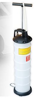

  5. nedear88
    nedear88 My 1st Prius.
    Mar 12, 2011
    246
    142
    San Bruno, California
    I've been using this oil extraction pump pump.JPG from Griot's Garage since 1999 on all my vehicle. it's really easy and less messy. I just jack up the front on jack stands, changing the oil filter is a breeze with the same oil filter wrench for my 99 Corolla.
    The only issue is you need to bend the access door for the oil filter in order to have enough clearance. My best oil change time is about 35 minutes from start to finished.
    AAA likes this.

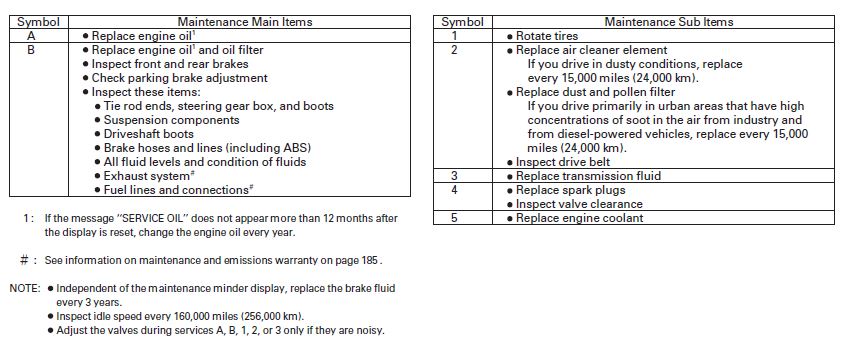

  19. Mendel Leisk
    60,262
    41,461
    For reference, here's an excerpt from the 2006 Honda Civic Hybrid Owners Manual. Note, the Maintenance Minder always alternates: one time it'll be Service A, the next is B. I also checked a 2010 Pilot Owners Manual, it's similar:
    My take: Honda's engineers found the filter was far from clogged at the first oil change, accordingly made this policy. It's got several benefits: less used oil filters in the environment, less cost, and less labour.
    When I was doing oil changes on our Civic at service A I would remove, drain and reinstall the filter, to get out the cup or so that would hang up in it.
    AAA likes this.
  20. frodoz737
    frodoz737 Top Wrench
    Aug 26, 2010
    4,699
    2,497
    Sorry...but Toyota says don't change the ATF and Brake fluid on a Prius either. There's a reason the Honda dealerships treat you like you're nuts if ask them to not change the filter...and it's not for the profit lost on a $5.00 filter. As a Mechanic I say they are both wrong as it applies.
    To each their own, but cheaping out on preventative maintenance for a piece of equipment that cost tens of thousands of dollars makes no sense at all.
