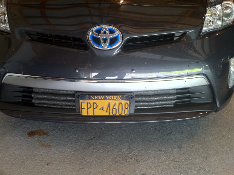

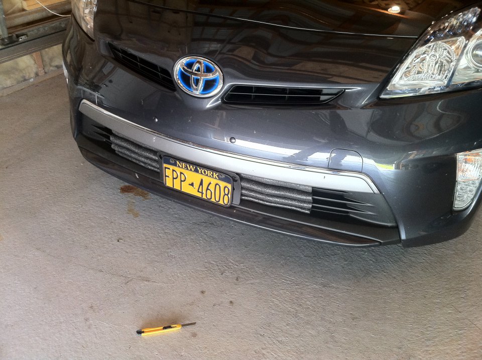

    did mine a couple weeks ago....seems to help keep ICE from running more and also can run heater longer before ICE fires...
    My plate is lowered so I have less area to block...have not fallen out yet even on hwy!

    rockerdan, You Rock! These are just the kinds of photos I was hoping to see. Thank you.
    I live in the SF Bay Area where it never hits freezing temperatures. I'm going to hold off on this mod, but I will keep it in mind for friends who live in colder areas.
    Stay warm!
