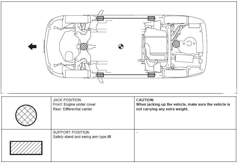

    I know "engine crossmember" are just words and can maybe be defined differently, but the thing I jacked from, and shown in that graphic above is not even really under the engine. I would definitely not call it an engine crossmember.
    I did, from a quick google search, find the graphic I had previously seen, which shows the GEN 2 jack point, which is what I would call under the engine, and that thing might be called an engine crossmember on most cars, or a cradle, or maybe a front suspension crossmember.
    But regardless of words, that point is slightly aft of the front wheels, so it's very different from the Gen3.
    Here's that pic claiming to be for Gen2 as found on priuschat by google, not sure of the original source or correctness:
    When I got down there under my Gen3, needing to jack, I was expecting to find something like this ^^^ (now known to be for Gen2, probably). On the Gen3, that front jack point is covered with plastic (what I would call the engine under cover) (*). Luckily I was correct in estimating that the jack point a foot behind the front bumper would be strong enough to jack from, and proceeded that way. Then earlier today to my great surprise, I found that it is more than OK. It's correct, for Gen3.
