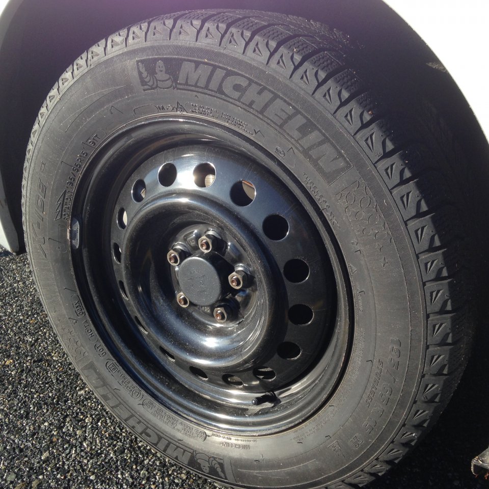

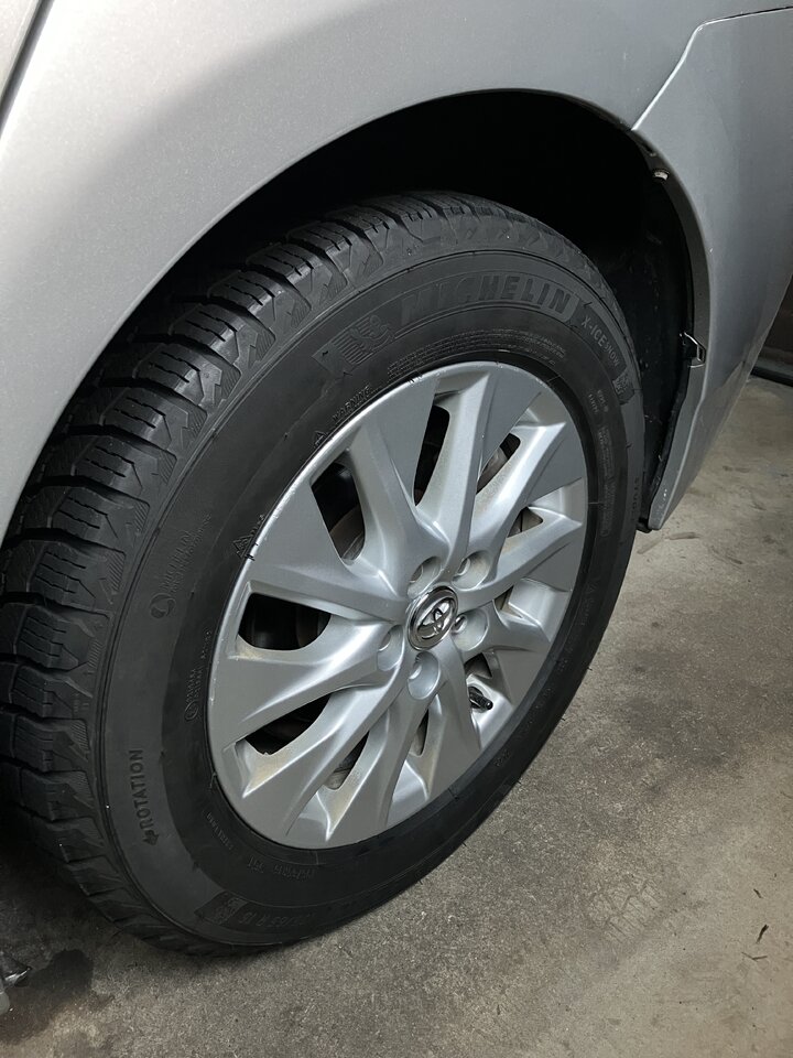

  8. Mendel Leisk
    61,482
    42,305
    I started our ā€˜10’s snow tires with Corolla steel rims, they were $70 CDN apiece, in 2010. One thing I learned: the exposed centre hubs rust badly, and quick. Ended up employing 2ā€ ABS end caps, looked a bit better too:
    Sold - Hubcaps / Wheel Covers - 15" - off of a 2011 Prius (Free + shipping) | PriusChat
    when I replaced that first set I swapped in some Prius Plug-in (2012-2015 model year) rims I’d acquired, for $400 USD, definitely more photogenic:
    winnertakesteve likes this.

  11. Mendel Leisk
    61,482
    42,305
    Stock 3rd gen 195/65R15. Used to be plenty. If I wanted a 5th gen Prius (hybrid) up here, 19" rims are the ONLY option. Plug-In version you can get 17", with black plastic wheel covers.
    Still have those Corolla steel rims. If there's a next time, toying with putting all-seasons on the pictured 15" alloys, reenlisting the steel rims for snow tires.
    Our current all-seasons on 215/45R17, on the optional 17" rims 3rd gen rims. Mpg actually improves in winter lol.
