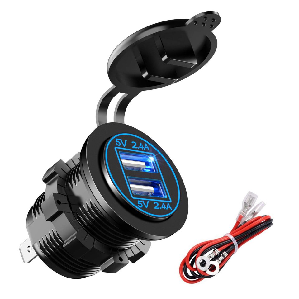

    Will this void my warranty? I would like to install this USB socket in the area above the ODB2 port, so I have to cut out a round hole in the plastic and add a fuse tap from the fuse box to give it power which is right in the vicinity. Will Toyota void my warranty if I install this?

    2.4A or 4.8A total doesn’t seem like a lot. As long as it’s below the fuse amperage, it shouldn’t cause any problems.

    It shouldn't be a problem. However, "piggyback" fuse taps need to installed correctly. The bottom fuse is the original one and the top fuse is the one for the added circuit. It must be installed so that the new circuit is fused. You need a test light to determine the "hot" side of the original fuse socket. The lead out side is then protected by the new fuse.
    You need to decide whether you want the socket to be connected to "live battery," accessory or the "run" terminal.
    I would, however, not cut into the plastic panel but use an attachment bracket, less you will later need to replace the panel. It would not look much different as it is under the dash at the OBDII location.

    Much appreciated. Great info on the fuse tap I had not considered so thanks a bunch. So you say use an attachment bracket instead of cutting into the plastic. What sort of bracket would this be?

    I'd just make a bracket with a hole saw in a 1/16 inch thick piece of aluminum with two holes to existing screws on the underside edge ot the dashboard.
    That would make it easy to remove and reinstall the entire setup and make it look as it was NEVER THERE, if you take it to the dealer.

    Remember that the SRS Driver Knee Airbag (Lower No. 1 Instrument Panel Airbag Assembly) is nearby. As far as I know, Toyota doesn’t publish detailed information about the airbag deployment interference zones (keep-out areas). The Owner’s Manual (PDF) has a diagram on page 36 that shows general locations, but the actual deployment volumes may be different. Page 42 warns, “Do not attach anything to or lean anything against areas such as the dashboard, steering wheel pad and lower portion of the instrument panel.”
    Consider, also, the potential for injuries, during a collision, from contact between the driver’s body and anything you install, not only the USB socket itself but also any connected devices or cables.
    For the installation itself, see the Repair Manual (more info) for important precautions against personal injury and property damage while working on or near the airbags and other supplemental restraint system (SRS) parts. At the very least, disconnect the negative (–) terminal of the auxiliary (12 volt) battery and wait at least 90 seconds before starting any work.
