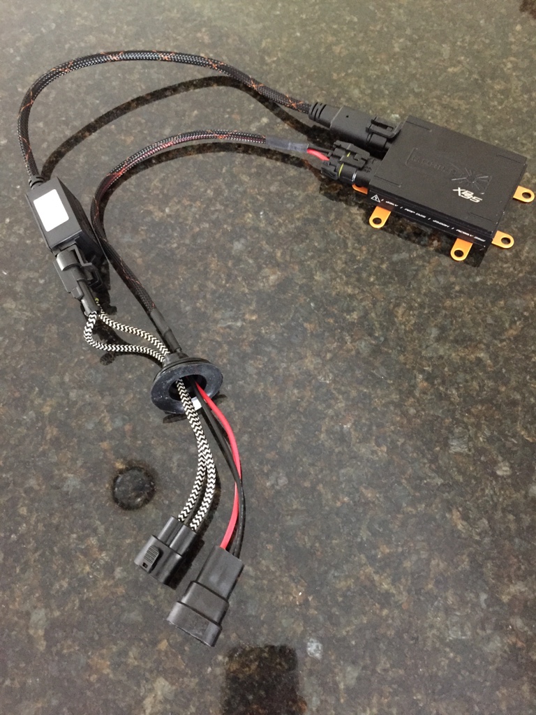

    Ready to install this bad boy.

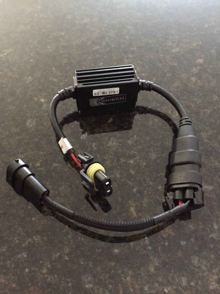

    I'm lost on how the Canbus relay gets hooked up. Any help is well appreciated.
    Here's the Canbus.
    #36 4rpr15, Jul 23, 2015
  17. xliderider
    xliderider Senior Member
    Apr 19, 2012
    8,140
    3,276
    Honolulu, HI
    The Canbus relay just goes between the ballast and the factory plug to prevent errors. So still plug and play.
    You don't need the Canbus relay though.

    I have everything plugged in without the Canbus, but the HID's won't turn on.
  19. xliderider
    Apr 19, 2012
    8,140
    3,276
    Honolulu, HI
    Common problem with Toyotas. Flip the plug connecting to the factory light harness, the one that would've gone to the original headlight bulb.
    It's the reversed polarity causing the problem.

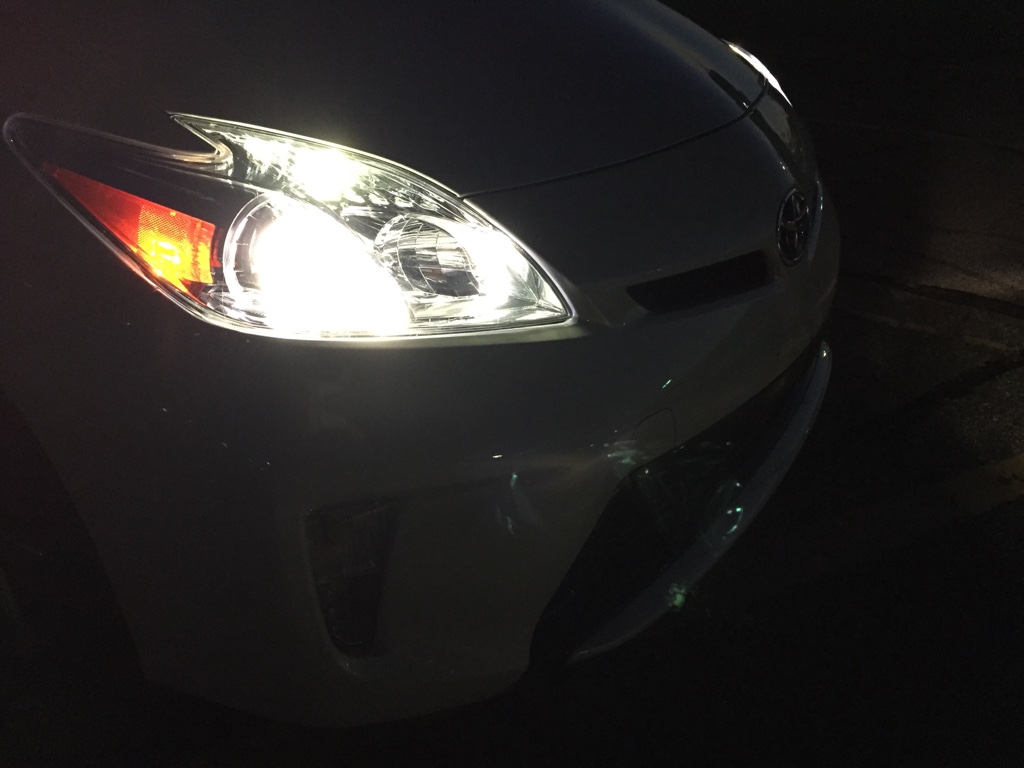

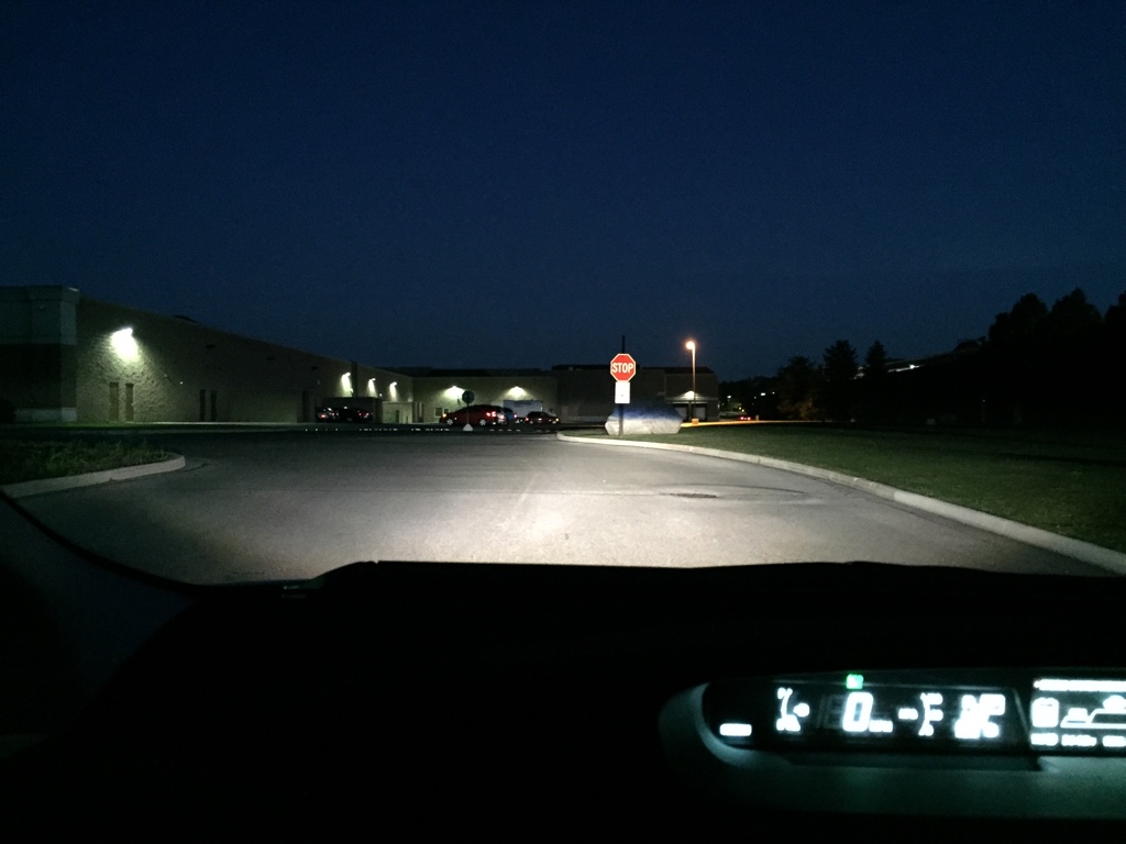

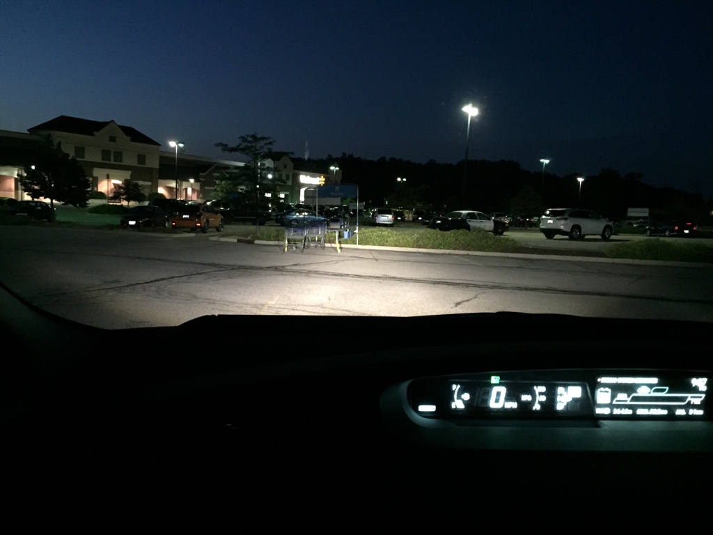

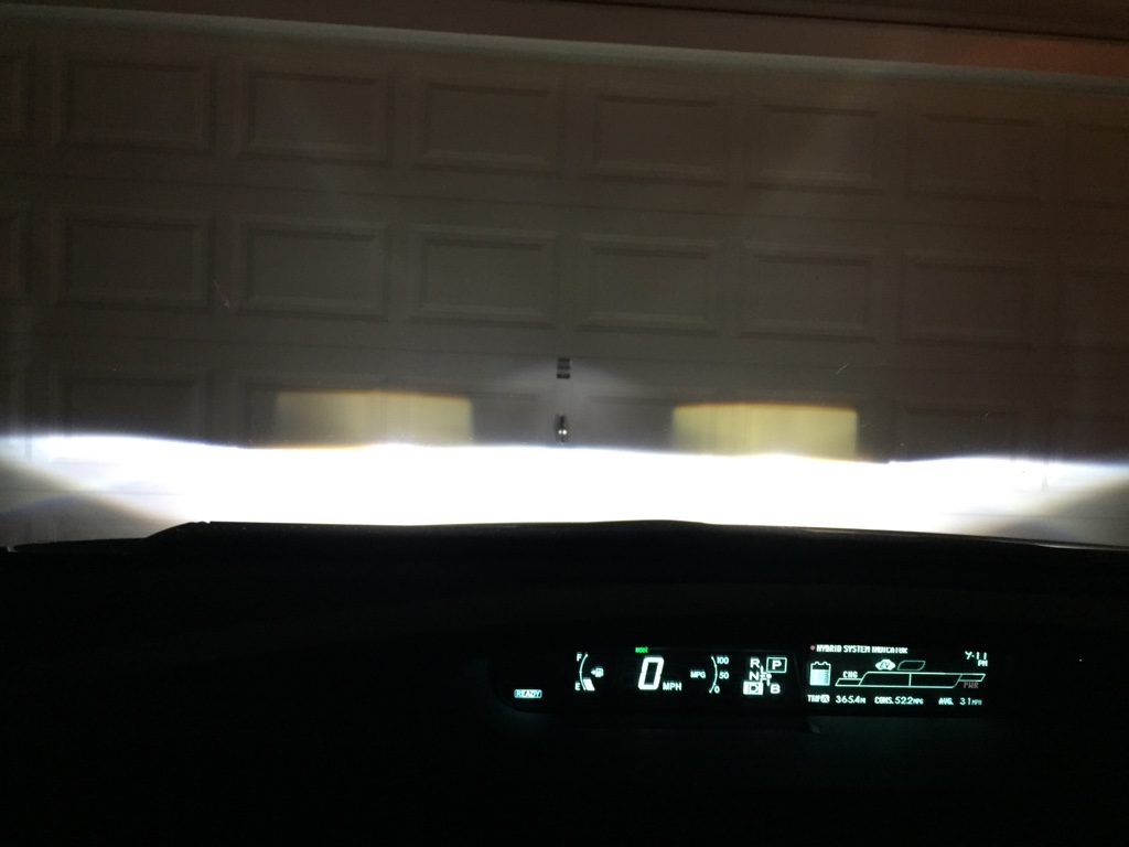

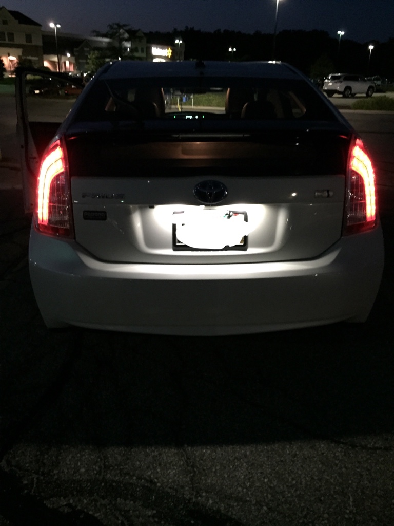

    Canbus is needed. Works now. What's he best way of mounting the ballast? I can't believe they didn't supply me double sided 3M tape!
    Just got done with the HID's and LED parking lights and license plate lights.
    HID 5500k with Canbus relay.
    H11: Morimoto Elite HID System - HID Systems from The Retrofit Source Inc
    LED
    T10 XB LED Headlight marker turn signal interior COB bulbs blinkers T10 194
