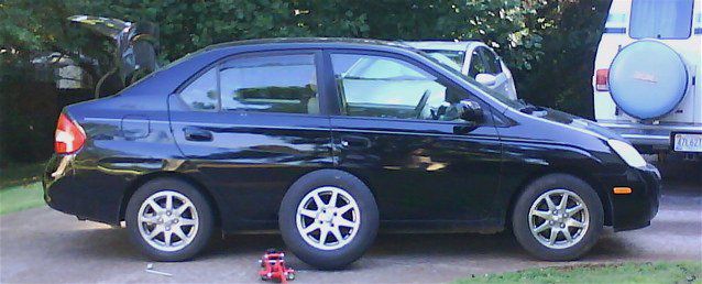

    I appreciate the review but I've taken a different approach to replacing the worn out Sumitomo T4s on our 2003 Prius. Our 2010 Prius tires remain in good shape but at 30,000 miles, nothing lasts forever. Fortunately, we have our first Prius, a 2003, NHW11, which has been our primary experimental vehicle.
    I have been running 51 psi, Sumitomo T4s on our NHW11 since 2005:
    Originally bought for low rolling resistance based upon a Consumer Reports article, sets of T4s have met my requirements over 110,000 miles. Experiments included 4-wheel alignment and the effect of tire pressure on tread temperature. But as the first set wore out, I experimented with larger T4 diameter, a tire-based overdrive and discovered the largest T4 that fit in the rear wheel wells dramatically improved 2003 straight-line stability on the front, drive wheels. The improvement was so dramatic, I kept them there until 'they wore out.'
    So these are my requirements for the replacements for the Sumitomo T4s that are no longer available:

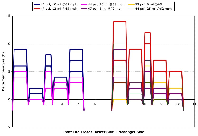

    • 51 psi - testing revealed tire pressure makes a significant difference in tread temperature, the heat lost in rolling resistance: [​IMG] Equally important, higher pressure appears to equalize the temperatures across all treads.
    • Lowest revolutions per mile (rev/mi) - the tire specifications P111/22R33 do not accurately report the true tread width nor tire diameter. But rev/mi is accurate as it also incorporates tread depth and actual geometry. Lower rev/mi on the drive wheels means lower spin rates that reduce lubricant stirring losses and more time to keep the tires cooler. Every revolution, the contact area flexes which generates the heat and drag loss so a slower turning tire has more time to dump this heat. It also slightly reduces the flex angle at the contact patch edges to reduces the amount of flex.
    • Ignoring Low Rolling Resistance (LRR) - a term without metric or numbers, we do not see any sort of coefficient of drag. LLR applies only between tires of identical P111/22R33 specifications. In contrast, revs/mi and tire pressure do not 'guild the lilly' (i.e., lie.)
    Eventually our 2010 Sumitomo T4s will wear out and have to be replaced but I had to make a decision for our NHW11 and found:
    1. Yokohama still makes a 51 psi tire in 14" diameter needed for our NHW11. So I bought two for testing.
    2. Yokohama P195/70R14 does not work in rear wheel wells that the Sumitomo T4 P195/70R14 do. The true size, wider tire tread hits the wheel well when driving over a local street dip at the posted 25 mph speed. The front wheel well has more space for steering and the Yokohama P195/70R14 works just fine even at speeds over 25 mph . . . uncomfortable speeds.
    3. Yokohama P195/70R14 are 107.2% oversized, the slowest turning tires to date. The Sumitomo T4s are at 105.2%, down from 105.9% when new.
    4. Untested, ordered Yokohama P185/70R14 for the rear tires.
    5. After alignment, 4-wheel, will switch to left-right rotation with tread metrics every 10k miles. The P195/70R14 on the front and P185/70R14 on the rear makes front-rear rotation impractical.
    6. Even at 35 psi and before alignment, the Yokohama P195/70R14s demonstrated an expected, true, 80 MPG, for 50 miles.
    I appreciate F8L's review because it is fact based. He did the heavy lifting as purchasing and testing tires is not cheap and takes attention to detail. Just I have a different set of requirements and methodology so it is not surprising that results might differ. Add to that his posting dates from March 2012 and this post is September 2014 after the tire market has changed.
