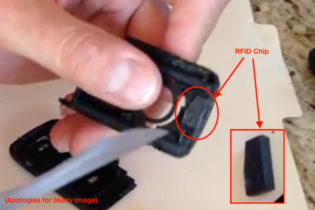

    The best guess I have had so far goes like this, which would explain why it works when not in the FOB slot
    Someone had one old FOB, they bought a new fob CASE
    They removed the innards from the old fob and moved them to the new fob case, and didnt know there was a small RFID part in the old case and did not move that into the new case.
    So far, this is the only explanation that makes sense, and explains how someone got a fob to even work SKS only and not in the slot.
    Assuming this is the case, where does one go from here to fix this.

    OK, so this is kind of funny, the seller really put one over on me
    So when he started the car he left the fob out, i had tried with it in the slot, he pulled it out, pulled the fob apart, played with the battery, then started the car with the fob out.
    Then he handed me another fob in a new bag and said here is a new one it has not been programmed yet.
    So i just opened the working fob that has issues, and indeed it is missing the RFID chip, its new looking so someone took the insides and placed in a new case and didnt know about the rfid and probably tossed it in the trash
    So out of curiosity, i opened the new one to see if it had an rfid, lol it has NOTHING, the new fob that needs programming is a case only lol.
