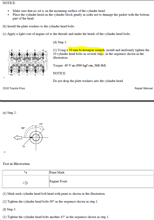

    Toyota says 10 mm double hex, for the head bolts. There is a slight difference. One of my signature links has some relevant Repair Manual excerpts. Also, some specifics on the double hexagonal (aka bi-hexagonal):
    New head gasket replacement video from Gasket Masters | PriusChat
    And cylinder head excerpts from Repair Manual:
    New head gasket replacement video from Gasket Masters | Page 2 | PriusChat

    Elektroingenieur kindly posted a comparison a few years ago, including the Toyota part number 09013-7C310 for the specified ten millimeter bi-hexagon wrench.

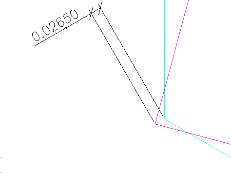

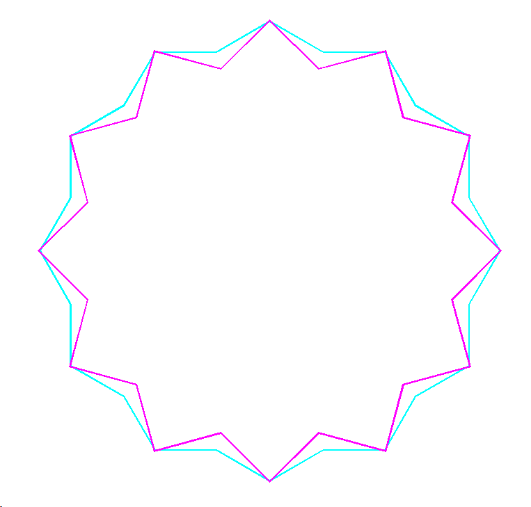

    Mendel also did a drawing several months later, showing the two superimposed. The twelve millimeter triple square (the wrong one) is the one that is pointier here. You can see its faces are not in good contact with the walls of the bolt head, and it mostly has to transmit force through its points.
    Note that Mendel has superimposed a ten-millimeter bi-hexagon and a twelve-millimeter triple-square, so when talking about which size is right, you can see that it matters which shape you name.
    Mendel also screenshotted the repair manual, and Avi suggested a source for the proper tool, CTA Tools 9295 Toyota Head Bolt Wrenches –Double Hex.
    Is it possible there "may be a misprint in the manual on the sizing"? Well, never say never, but he who bets against the Toyota manual doesn't win much of the time.

    The triple square "will" work, Gasket Masters use it, but it's not right. @ChapmanF really came to my rescue; I couldn't find where I'd posted that info before. If you look at the pics of the two socket drivers, you'll see the points of the triple square are obviously pointier (90 degrees) than the double hex (120 degrees). And I believe the triple square points jut outward very slightly more. So basically you've got a square peg in an hexagonal hole, and the sharper corners are slightly greater protruding, allows it to "work", but it's not ideal: you're digging into the corners some, and that's the only place it's contacting.
    Yeah from the link @ChapmanF provided, this is the difference in the corners:
    It's somewhat akin to using a Phillips head (cross pattern) screw driver, to drive a Robertson head (square) screw. In a pinch you can get away with it, if you press hard. But you're totally relying on the screw driver biting in at the corners, it's not a uniform fit.

    I can believe it's quite snug, as Mendel's drawings showed the triple-square's point-to-point dimension is even a tiny bit more than that of the bi-hexagon.
    So it is not going to feel sloppy by any means when you set it in place. Where the shape may matter more is when you are cranking on it, and you would like the force to be delivered face-to-face, not just at the points.
