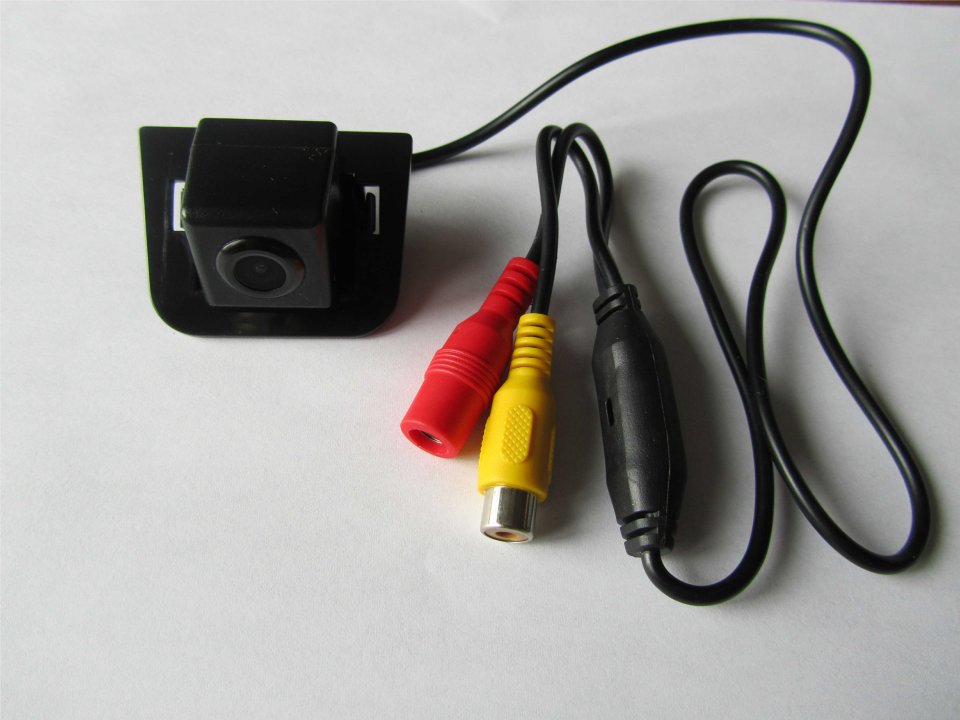

  12. Dylan Doxey
    Dylan Doxey Senior Member
    Mar 15, 2013
    1,389
    3,460
    92
    San Diego, CA
    There's a plastic slug that might need to be drilled. But ideally the camera in your kit should already be fitted to a bracket that replaces the slug.
    Here's a screen grab from the video that shows the the guy drilling the plastic slug.
  13. our1vue
    our1vue Member
    Mar 10, 2012
    313
    NY
    dabreeze21,
    On my 2012, I just removed the plastic slug and snapped in the camera. Some cameras are held in by a threaded rod and
    some just snap in. Dylan Doxey picture above is a snap in camera. I did have to drill a small hole to get the
    wires from the outside of the car to the inside of the car.
