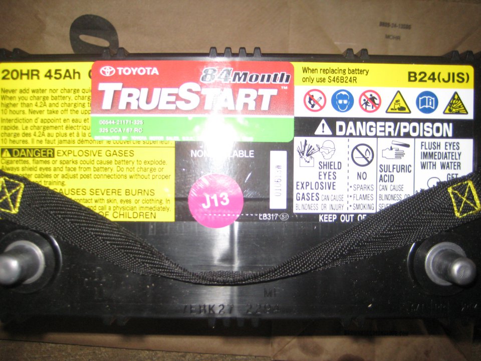

  9. exmetrodriver
    exmetrodriver Member
    Jun 27, 2014
    124
    16
    Puget sound, Wa.
    I have the same question as the last post. Is the OEM battery made by GS Yuasa? Will I get this brand if I go into the dealer today? If so, I read different story's on what the warranty is for this brand. Looking to get a new battery soon before I have issues (like when I'm on a road trip). I guess it would also be a smart move to test it before I leave the dealership.
    I think I'm out on an Optima. It was the best battery on the market at one time. On my truck forum I read that the quality really went down when they began to manufacture them in Mexico.
  10. bisco
    115,530
    52,917
    yes, the oem replacement is yuasa. i believe they have a good warranty, you can ask before purchasing. and yes, the optima seems to have gone downhill unfortunately.
