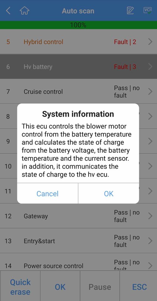

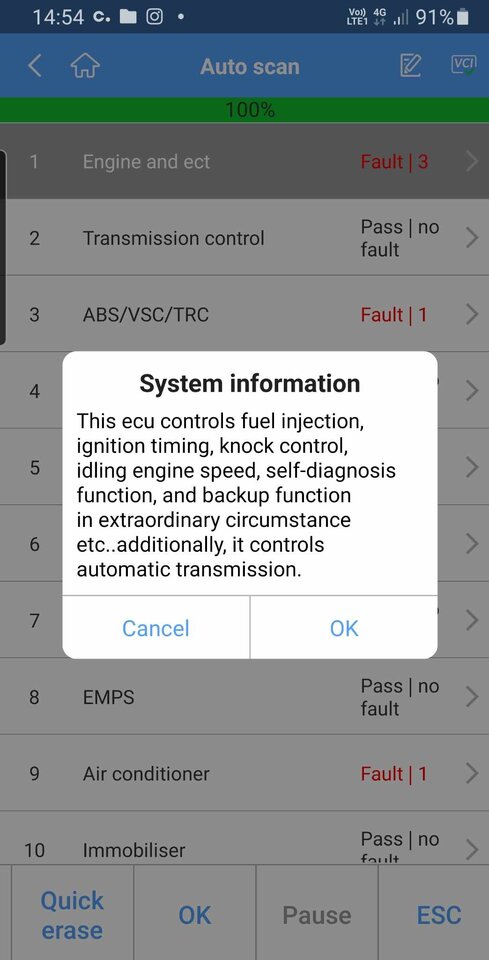

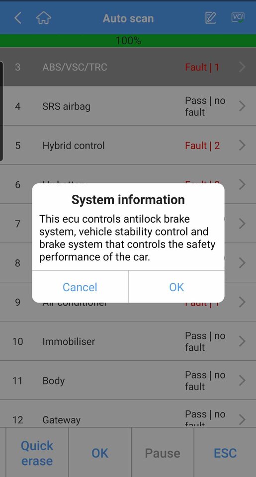

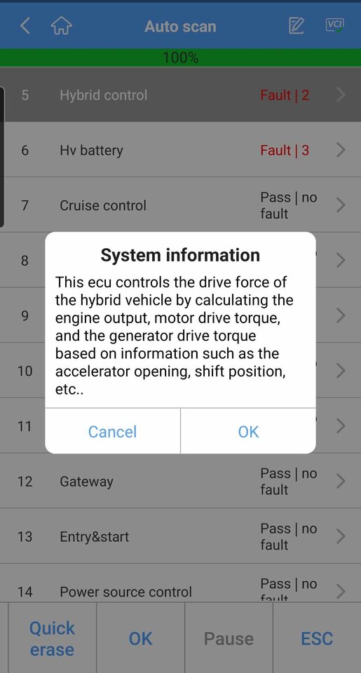

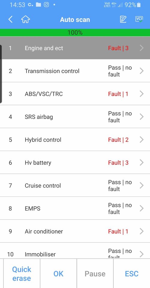

    drove around 5km home, parked it, ran diagnostics in Autel (see attached file) and now posting it to you guys here.
    What can the problem be? Is the car kicking the bucket? First thought was maybe the water pump needs changing but am not sure... please advise!

    The pdf file, it says Engine and ECT fault error,but no details. Can you click on that "Fault" and retrieve the codes and post it here?
    When my 2009 got this kind of lights, it was the throttle body errors,. First time was stuck and second time the sensor. It will go so "fail safe" mode and on start again, if good, it works fine. It can show this for any faults. The first one i got was with the inverter pump.
    So scan it by clicking the "Fault" and post it here.

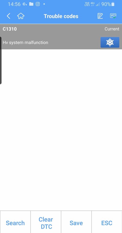

    I'll run the scan again when I get in the car tomorrow, looking in the "history" tab of the app it says:
    P3000
    System : Hybrid control
    Description: Battery control system

    The next time the warning lights come on, use your scanner to read the codes before you clear them. When the red triangle (master warning light) comes on, there is a problem with the hybrid drive system.

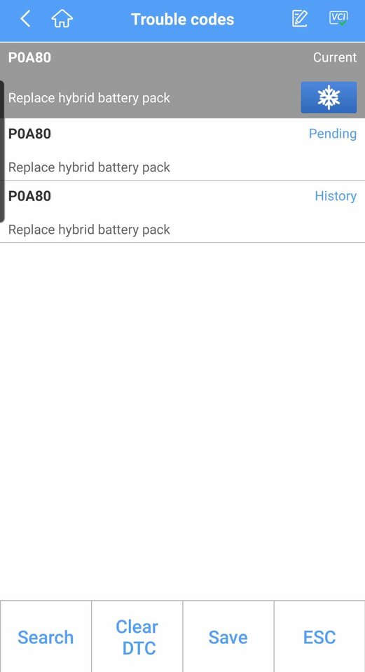

  6. Prius2006GuitarGuy
    Prius2006GuitarGuy Junior Member
    Sep 1, 2024
    Sweden
    Looks like it's the damn hybrid battery :(

    First, you can probably ignore the HVAC error,that is probably the sun sensor which fails if the test is done in the shade.
    12% vinegar? Pretty concentrated. However, you didn't use it like that, you diluted it, to what? Was it a warm day? There is a problem seen frequently on Prius cars that live in humid hot climates where corrosion on the connector to the little computer in the battery breaks the pack. Sweden wouldn't normally be very humid, but if you left a rag saturated with vinegar in the trunk on a warm day it might have resulted in "accelerated aging" of the component which is prone to corrosion. I mean, if I needed to see how fast a piece of metal would corrode in air I would have done something very much like that. So it might not be one or more modules which have failed, it could be that corrosion.
    Or the rag might have nothing to do with it and some modules have gone bad. How old is the pack? If it is original then it was living on borrowed time.
    Note: replacement pack does not have the electronic parts, those are transferred from the existing pack. If the little computer has gone bad you will need to get one of those too.

    I believe there are some indications of that corrosion problem from some of the voltage readings one can get with Techstream or, I assume, the AP200. P0A80 means the pack is seeing some out of range voltages. That can happen if the module is bad or the sensing wires for the module are bad - anywhere along their length, but usually at either the module end or the end that plugs into the ECU. For a diagram see the 4th post in this thread:
    Hybrid battery No. 2 Frame wire voltage sensor HACK | PriusChat
    When modules are failing usually it will be off by just a little, like .5 volts different from another module, whereas if the sense wires are busted it may read 0 volts or some crazy voltage.

    You can drain the battery down to 40% and see if any of the modules do not differ much in voltage in the torque pro app. By doing this test, it will be clear whether the code P0A80 occurred due to several weak modules in the pack or not. The code P0A80 usually appears when there are several weak modules in the battery pack.
