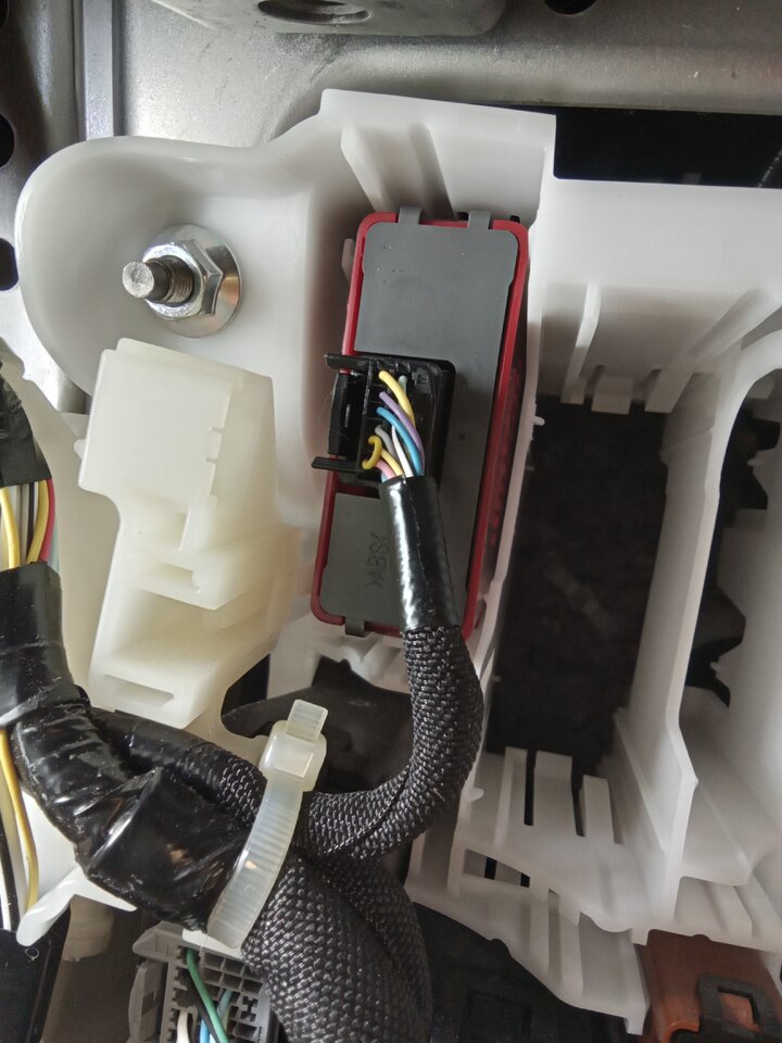

    My 2012 Prius ECU integration box doesn't look like the one in post #6. Is the black connector at the top-left the TPMS ECU? I shorted pin #5 with #7, but the warning light is still on,

    That connector looks like what I remember the TPMS connector looking like. The upper left box is the TPMS box. You can pull it out (with great difficulty), and it will have the part number molded into the outside of the box. My 2013 Prius V had a Red colored box.

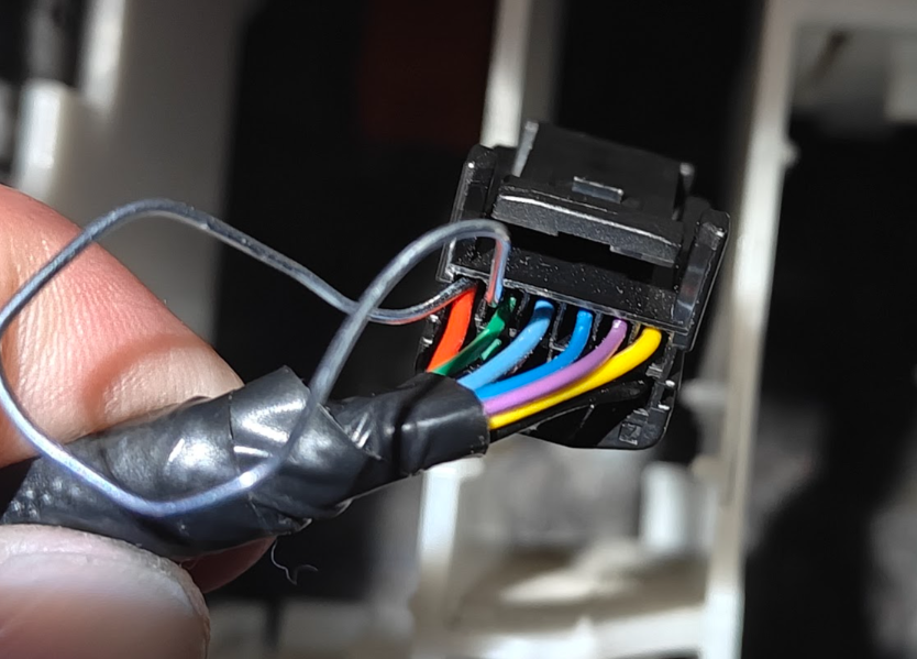

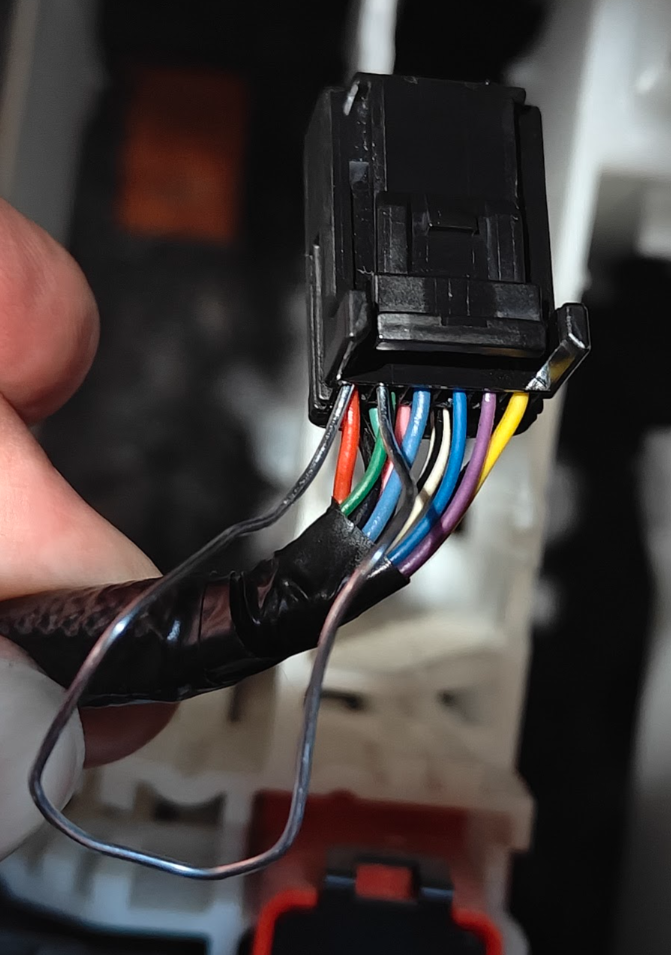

    I tried shorting the 2 wires together with a vampire clip like on my 4runner. Wires on the prius are smaller though...
    Ended up using a heavy duty staple from the junk drawer to short out the pins together.
    My 2014 V had the exact same pinout as my 2004 4runner.
    Running no TPMS sensors now.

    Can you tell me which two wires have to be shorted together at the TPMS module under the glove box area
  17. DutchJ
    DutchJ New Member
    May 17, 2025
    I have a 2014 Prius. I tried shorting TPMS pins 5-7 and that did not work.
    I found that shorting Green to Red wires (right next to each other) did the trick!! No more tire pressure light!
    I used a paperclip and made sure it's in there and making good contact with both. Could also cut back wrap and use "Solderless Quick Splice Snap Wire Connectors, 22-18 AWG Pressed Insulated Electrical Splice Wire Connectors (Red)" found on Amazon.

  19. Georgina Rudkus
    Georgina Rudkus Senior Member
    Sep 15, 2018
    3,576
    2,605
    Taylors, SC
    Its done. Jumped pins 5 and 6.
    It's the same location as on the Gen 3.
    Should have known. I tried over 60 different combinations.
