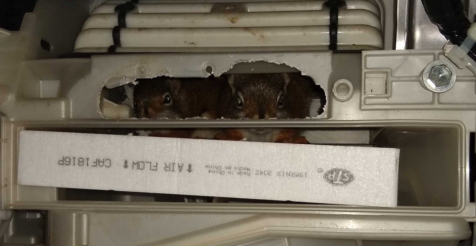

    Grateful for this thread. Have a 2016 and found out serious mice problem. What clued me in was hearing what sounded like an acorn drop inside console while driving. Opened glove box to see some chewed insulation. Went to change cabin filter- yikes! Huge nest on top of filter. What is worse is mice chewed holed through filter. This allowed acorn/nest material, mice poop to drop from top side of filter through filter to below. What really worries is lots of mice turds, AND some dark brown liquid on filter bracket, filter door.... This makes me think there is some pile of mice turds oozing liquid from above filter area. (???)
    • open to recommendations. Thinking something this dire might need to go to dealer ...just to inspect for any wire damage and hopefully clean poop, nest residue, etc that have dropped through large holes in cabin filter to below.
    • plan: I'll spray peppermint spray on filter -not too optimistic with that. I'll also aggressively trap around vehicle- snap traps /peanut butter. (vehicle spends lots of time idle in garage)
    • Hanta virus. Problem: I like to have fun. Dying of this virus does not sound like fun. Main worry:::!!!!!!!- virus spread when mouse poop stirred up and particles become airborne. Mice poop in my air vents which blow on my face which I breath. Qu: should the CDC be involved in forcing Toyota to deal with this???
    • would love it if someone could film to find how mice enter. Do they jump up to vehicle? or do they have to climb tire??? this seems KEY. was in place with bed bug issue. Finally realized one just needs to bed bug proof 4 points where bed legs touch floor. This prevents them from accessing food source- (you)...and they die. In similar fashion, if mice need to climb tires ...figure some way to mouse proof tires? maybe that honda rodent tape on tires? key is finding the vulnerable vector!
    • cant believe I had been breathing airborne mice poop blowing from vents. that brown liquid is so nasty.....
    • feedback welcome....thanks for letting me rant.

    So, went to dealer about mouse infestation. Was actually pleased with what they did.
    • They clean the AC evaporator. (AC refresher kit, element air refiner)
    • remove inspect and clean blower motor (acorn and debris in this-see pic)
    • inspect wire harness for rodent damage
    $352 total. I consider this relative good news.
    I mentioned hardware cloth over cabin filter and one rep strongly advised against , since no reason was forthcoming, that will be the plan. My impression is all inside fan air funnels through cabin filter....so hardware cloth over this will at least keep the filter uncompromised should another mouse enter. It's in a garage, already caught 2 deer mice in snap traps. I'll constantly trap, and perhaps call pest control to mouse seal garage. Thanks for all the advice here very much appreciated....not the greatest news to get, but certainly could have been much worse.
    Salamander_King and Mendel Leisk like this.
