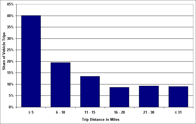

    What is the source of that graph? It is inconsistent with SAE J1711 utility factor. Per EPA, PiP covers 29%, C-Max Energy covers 48% and Volt covers 66%.

    Well if you need 5 seats, then its not about the efficiency but the space. Why people argue for SUVs too-- space, AWD and visibility. All good reasons for choosing vehicles.
    Premium vs regular is about cost, not efficiency.
    That is from the 2009 National survey, presented in a recent thread here on priuschat.. its using 2009 data.. SAE is based on 2001 data.
    Plug-In Prius misrepresentation | Page 3 | PriusChat

    Thanks, I forgot about seeing that. Nearly 80% of trips are 11 miles or under. There is a lot of potential for charging multiple times a day.

    49.1 MPG (well-to-wheel) is pretty good for a compact. 48 for midsize is just as good.
    You and OP have extreme EV ratio among Volt owners. The average from the realworld data is 61% EV (EPA estimated 64-66%, depending on model year) so that weights more than a few extreme data points.
    I don't know the actual EV ratio for PiP but EPA estimates 29%. I am not too far away from EPA estimates.
