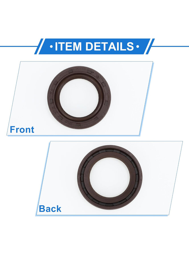

    The kit does come with the timing chain cover seal. Please kindly read the description of what is included to ‘nut’ get confused As for the valve steam seals, exhaust manifold gasket and EGR gaskets there is an option to add to the kit

    oh my bad, that look like the oil filler cap seal. Can't tell from that picture because thats what it looks like to me. I do see your listing also list the oil filler cap seal and the timing cover oil seal, but I only see one and not the other in the picture... unless it’s not in the picture? And the timing cover oil seal is brown and that looks black to me, so I’m not sure if its me or if anyone else see it is black or not. Also the kit is missing the exhaust manifold gasket. But overall, it is a nice kit, I wouldn't mind buying it.
