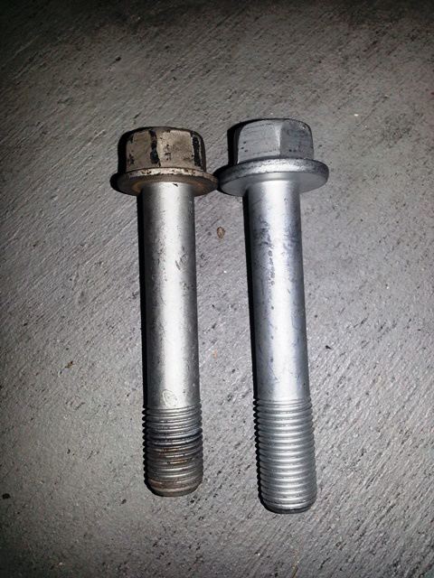

    Did the right thing and got the Progress rsw. Rides smooth but hear it clanging around. The factory bolts are too small or need something around them to fit tighter. Any suggestions or am I missing gaskets that should have come with?

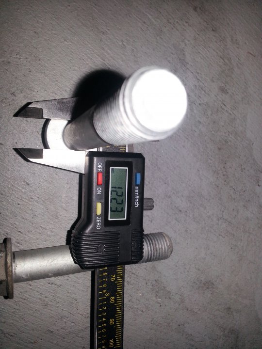

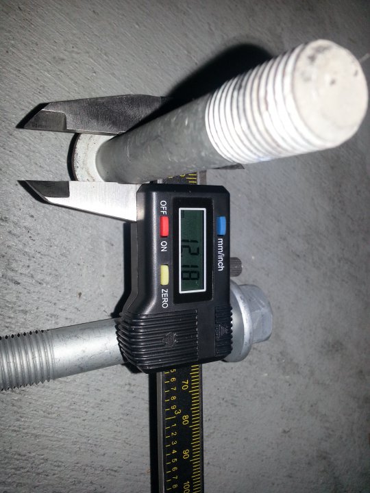

    Had to special order the bolt from Toyota. They are just a hair too big. Won't even slide into the sway bar holes. Tried heating up the holes but still can't fit this bolt. I'm stuck with $20 nuts and bolts since it was a special order.lol. Should I get a huge drill bit and widen the holes or cut my losses,put the bolts on ebay and go to the hardware store?

    Did you try inserting the bolts the the holes without the bar installed? You're inserting thru the bottom of the rear support right? I used these bolts on my 2007 and 2008.... i Can't imagine that they wouldn't work on a 2006. Can you take a picture of your bolts as a comparison?

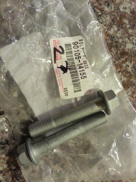

    Ugh. I'm sorry. I dug up old pictures of my install and I found the photos with the part numbers written on the bags. The ones I told you ARE wrong. :( These are the correct ones. 90105-14155
    I have attached the TRD RSB instructions as well.

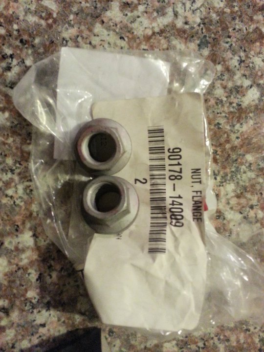

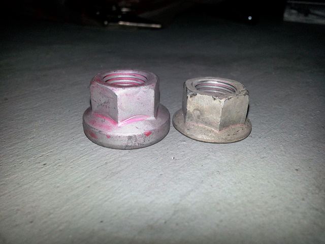

    LOL my luck :eek:.... Just ordered the NUTS 90178-14009 and BOLTS 90105-14155. Should arrive Tuesday.(y)

    The dealer's computers were down when I went to pick up my parts so they just swapped me out for my old bolts that were too big.Got the right nuts and bolts in!!!! So far no clanking and clunking. Thanks fellow Prius pals :):):):love:

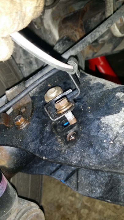

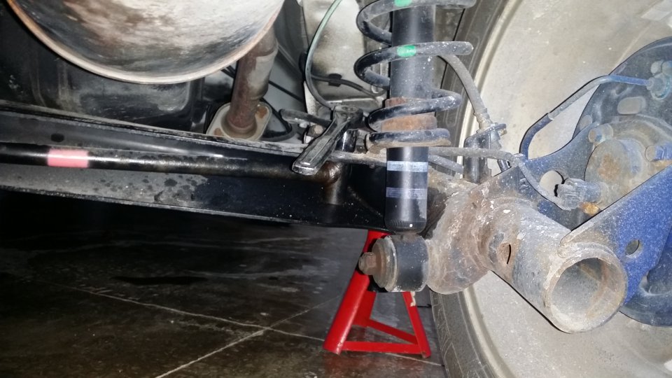

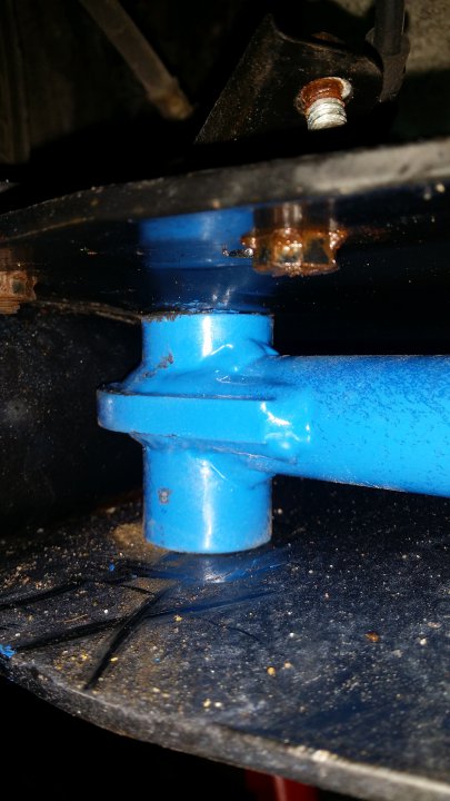

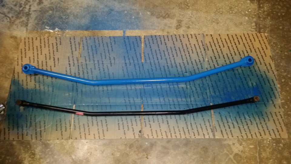

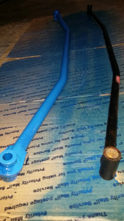

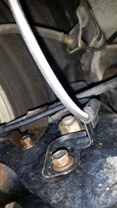

    Oh here are my install PICs with the original bolts. Sprayed it down with PB blaster.
    New one on top and old on bottom.
    Had some trouble breaking the bolts loose so temporarily removed this brake line thing to get more leverage. Still having trouble I heated up the bolts.

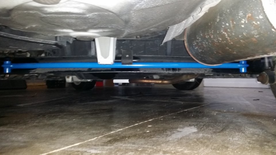

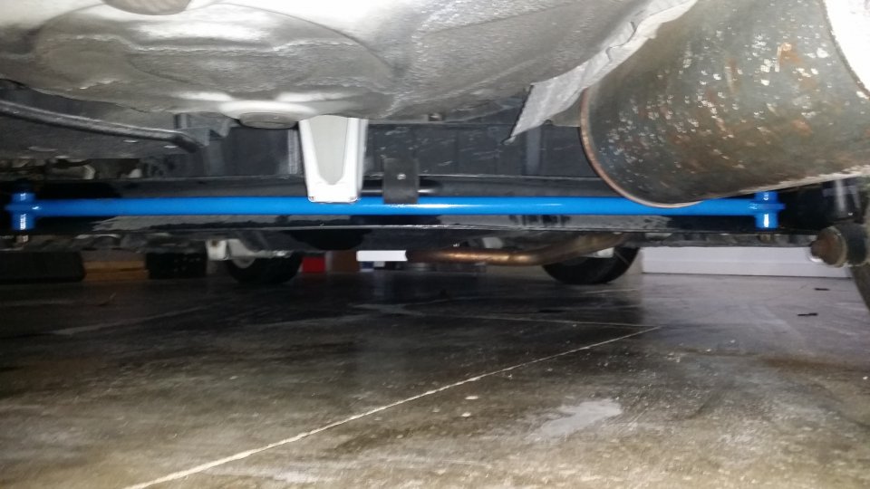

    Got the new bar in.
    Remember to tighten this back.
