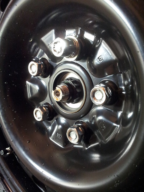

    James, you will see further down this page I have just put on my steelies...anyways...look here: (the hub fits just like it would fit on alloy's...
