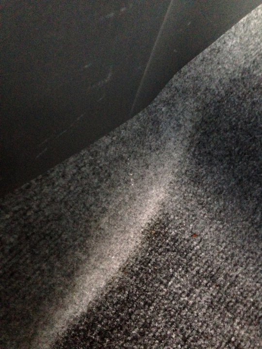

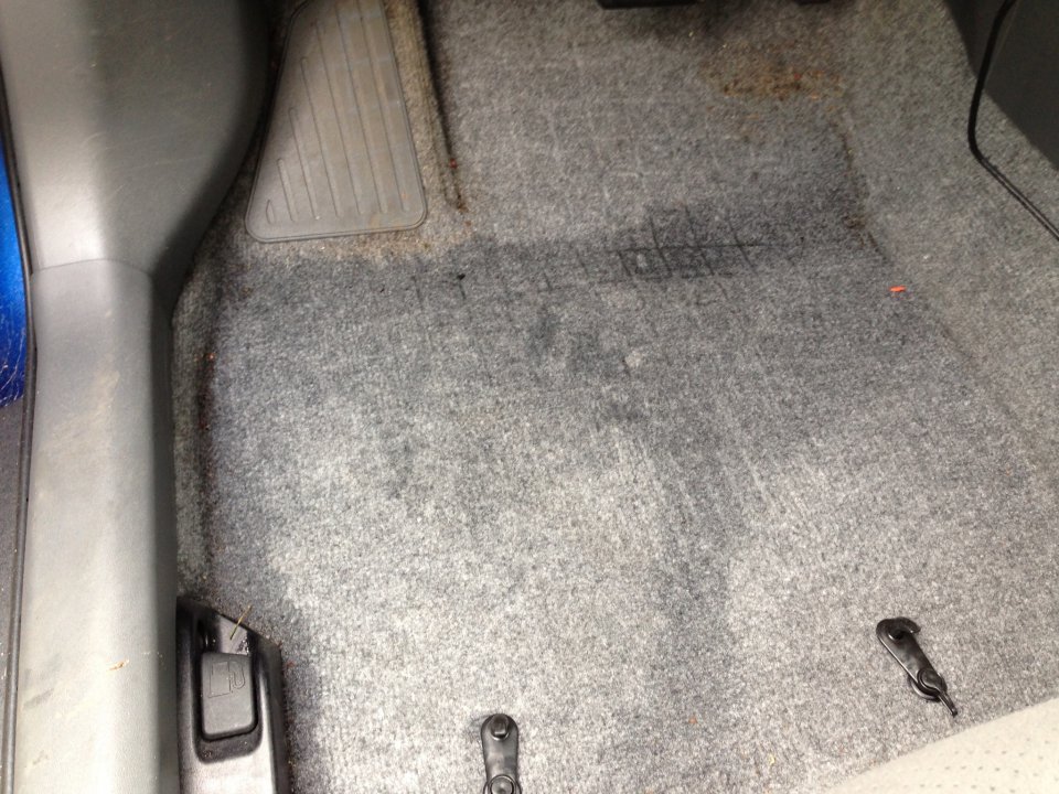

    When I turned the AC on, I get water leak inside. The water dripped from inside of the center console where shifter sits right above.

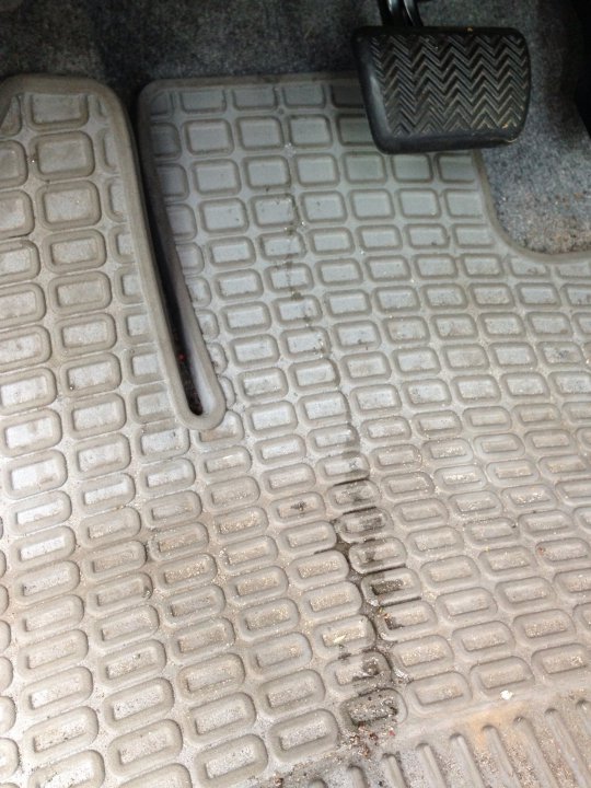

    The water sift into the driver carpet area and front passenger area. If I don't take up the mat, the inside smell like mildew.
    I took the car to the dealer and they said the drainer is clogged by the leaves and the water from the AC gets back up into the cabin.
    Are you serious?! Is this a design issue or what?! Should the cleaning be under warranty or I need to pay for it? If I would do the cleaning myself, how difficult will it be? What's the step to do the cleaning of the clog?!

    The evaporator and housing where all the heat exchange occurs for your AC is toward the middle of your dash, next to the glove box. It sounds entirely feasible that your drain tube is clogged and the water that normally drains out is backing up and leaking to your interior.
    Can you fix it yourself? It depends how comfortable you are working with a few hand tools and getting the diagrams or information on the assemblies that you will need to take apart to fix it.
    Also, there is the mold and mildew problem you have that will need to be addressed. Make sure you dry out the area that was affected completely or you might have further problems like rusting of the floor panels.
