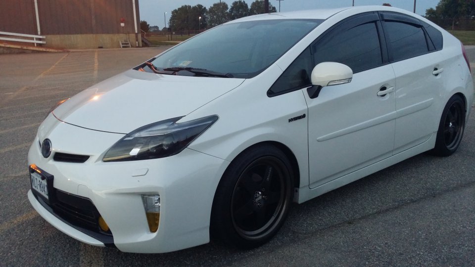

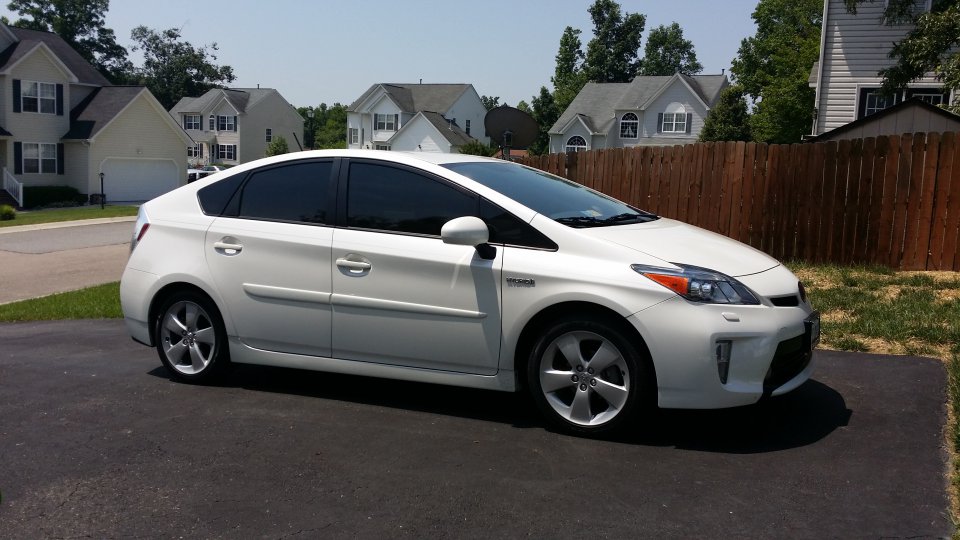

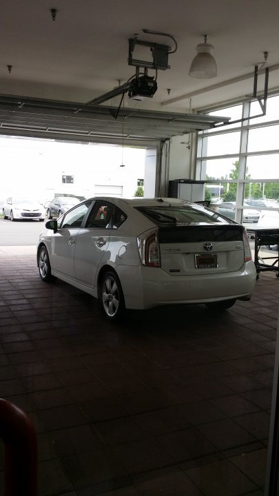

    In May 2014 I decided I wanted a Prius. I wont really going for top of the line but I ran across this 2012 Blizzard Pearl Prius 5. A older couple had it for about 2 years and put mainly highway miles on it. Full leather, Navi, rear back up cam, technology package and the list goes on. So I had to jump on it. I mean it was gonna save me so much $$$$$ right? (Wrong!!! WIFES voice)
    Picked up 5-10-14

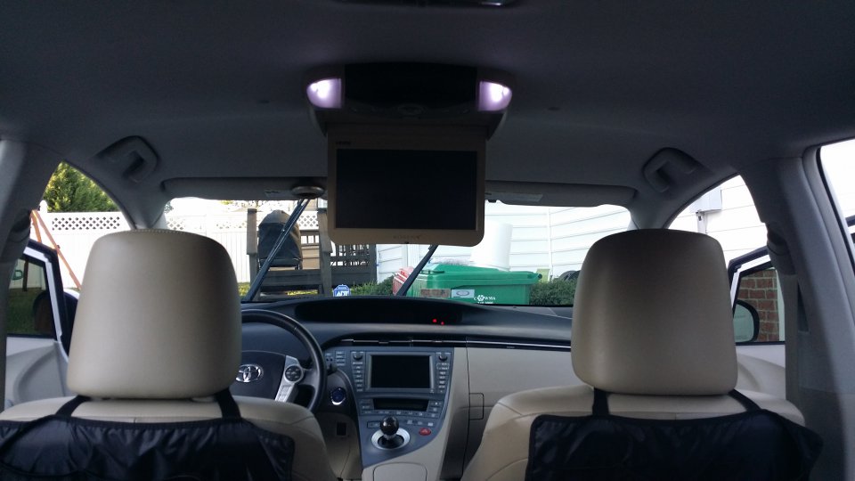

    I ended up having to dealer install a 10 inch dvd system for my kids. The color matches the bisque interior as well...
    I ended up purchasing the side moldings from a 2006-2012 Toyota Rav4 BP which happens to be a perfect match in color. I just searched online to find the cheapest place that sold Toyota parts to get these. Also got windows tinted 20% all the way around.

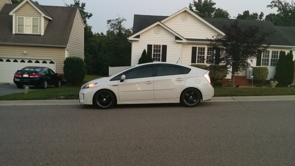

    I then got online and searched for some lowering springs. At the time is was the cheapest as I compared springs to coil overs ($165.00 vs $900). I Ended up getting the Tanabe Df210's from ebay. 1.3 drop in the front / 1.6 drop in the rear
    Tanabe DF210 lowering Springs 2010 Toyota Prius | eBay
    Spring install info....
    DIY: Spring Install | PriusChat
    After springs installed...
    After a little ride time it'll drop a little more after the springs settle.

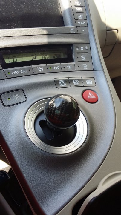

    Next, I got on ebay a decided I wanted to find a CF shifter ball, picked this one..
    After getting some longer set screws I was able to make this one work and fit nice and tight.
    Real Carbon Fiber Shift Knob Universal Fit Honda Acura Mazda Mitsubishi Nissan | eBay

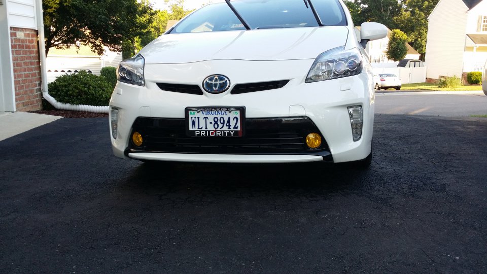

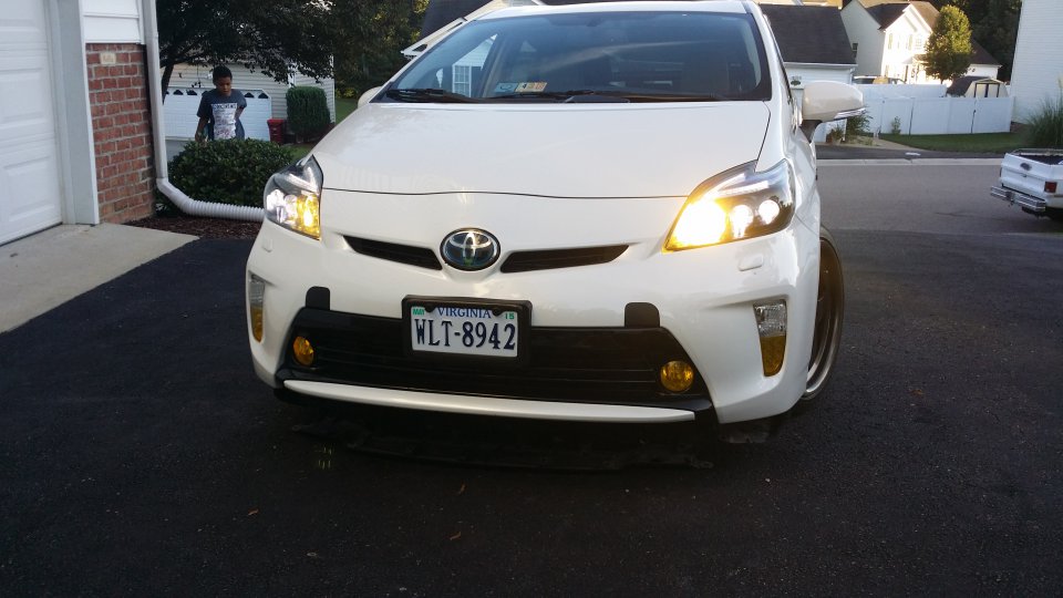

    I decided I wanted to give it a more of a JDM look so I picked up some JDM "Dark Yellow" lens vinyl from below. I took my fog lights off (after I tried to do this with them on the car) to install the vinyl as it was easier than on the car because the lens are oval and not just flat. I didn't want wrinkles!
    MetroRestyling High Quality Colored Lens Vinyl Films.
    Before the dark yellow vinyl on the fog lights I had changed my fog lights bulbs out to H11 30W Led CREE Bulbs and haven't had any issues what so ever. Nice and bright White before the dark yellow JDM vinyl of course!
    H11/H8/H9 LED Bulb | H11 CREE LED Fog Light Bulb

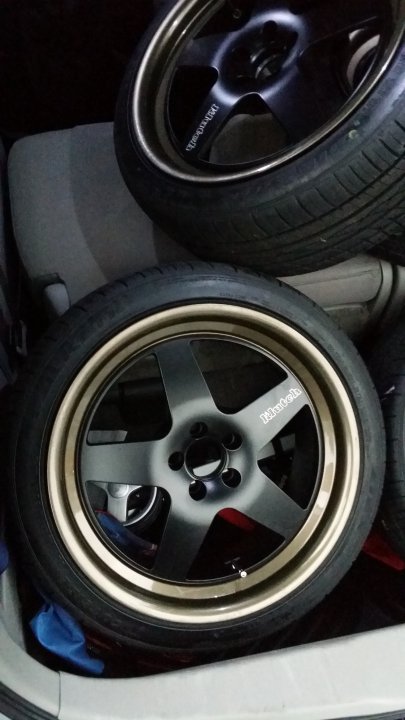

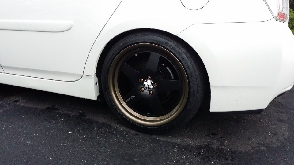

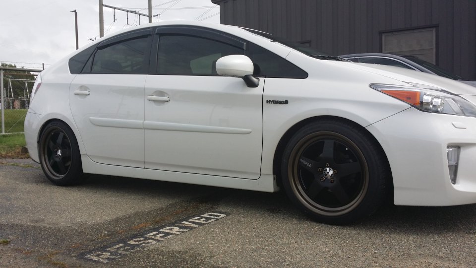

    I then search for some wheels. Ended up getting the Klutch SL5 in Matte Black w/bronze lip. 18 inch. Offset is +40. Got some matching aluminum lug nuts to match the lip! Tires are Falken 225/40/18.
    Klutch SL5 Gallery | Klutch Republik

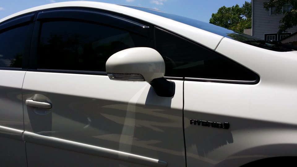

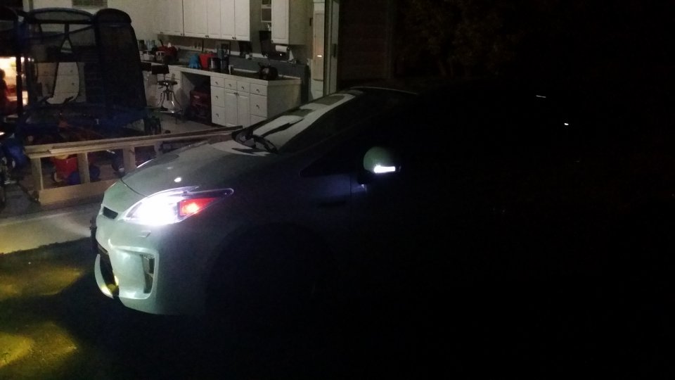

    After seeing some of the guys here on the forum with the LED turn signal mirrors I had to have them! Purchased on ebay from below. Very nice people to deal with!
    Toyota Prius 10 14 LED Mirror Cover Turn Signal Light Lamp White Color Painted | eBay

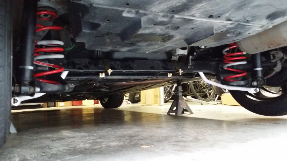

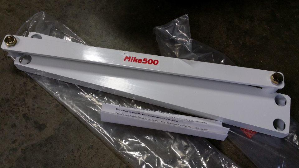

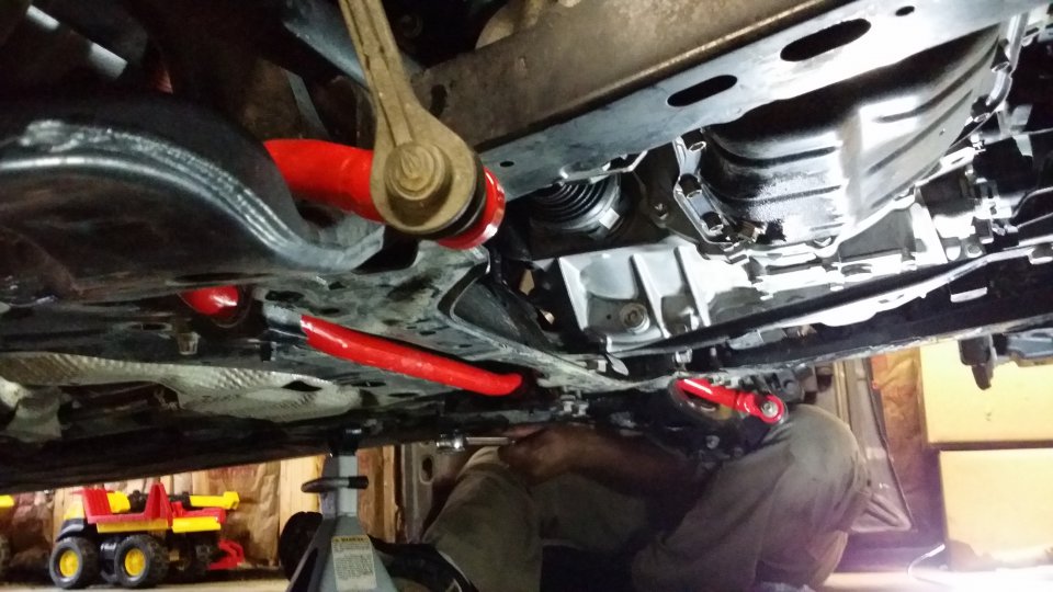

    After reading about the chassis bars that @Rude person's had made, I sent him a message and caught him at a good time as he still had a few left that I purchased from him. I also picked up the TRD rear sway bar from ebay and the Tanabe front sway bar from amazon. Went over a friend of mines house and he helped me install it all.
    Toyota Prius 2010 2014 GEN3 TRD Plus Rear Sway Bar New | eBay
    Install Instructions I went by...
    DIY: How to install Prius PLUS rear sway bar (PTR11-47010) | Balancing Act
    Tanabe USA R&D Blog | Front Sway bar for 2010+ Toyota Prius
    Rear Sway bar thoughts/info....
    Thoughts on TRD Rear Sway bar.... | PriusChat
    Some front sway bar torque spec info...
    Inexpensive front sway bar upgrade | Page 3 | PriusChat

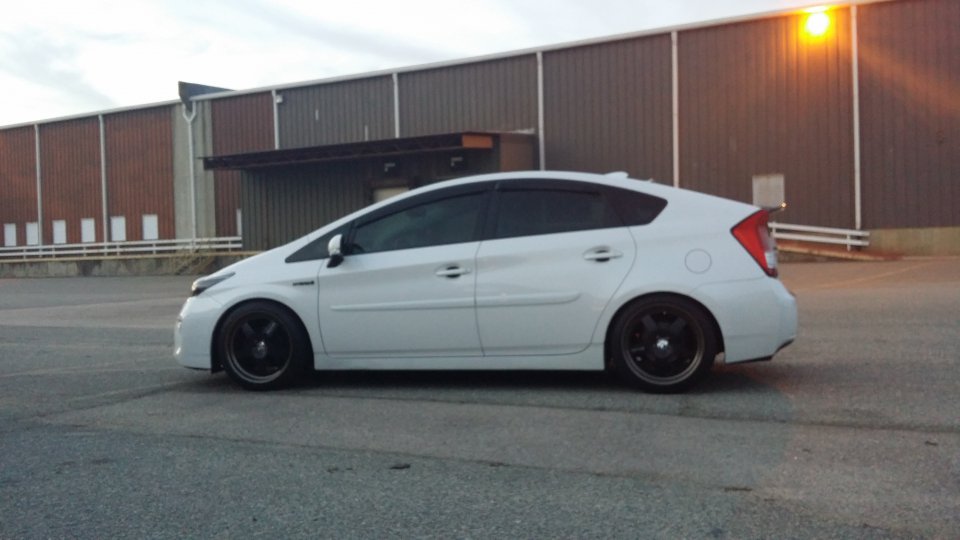

    Handling after installed all that was INSANE!!! Very fun to drive and handles like a beast! I picked up the Carmate cup holder tray in black off of ebay.

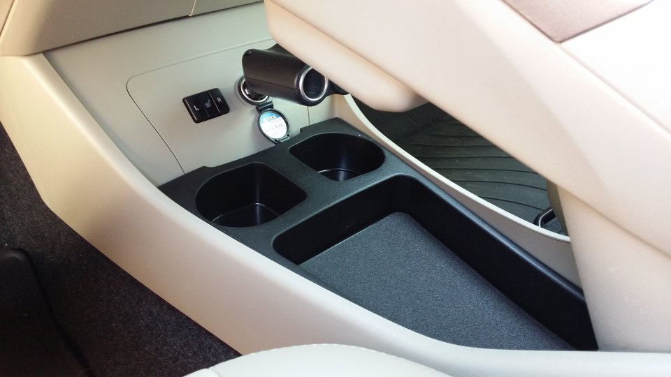

    Toyota Pruis Cup Holder Tray Genuine JDM 2010 2014 Prius Carmate Black Version | eBay

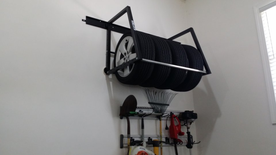

    Added a wheel wall mount for my factory shoes.....Found on ebay
    Kmart.com

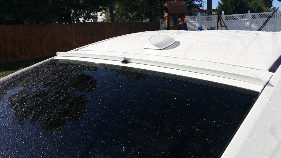

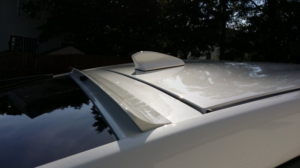

    After all that I had been seeing some of these guys with the shark fin antennas and the rear roof spoiler(thanks @burnaj for the info on the rear roof wing) Shark Fin antenna came from the prius chat store and the roof spoiler from ebay. Excuse the fingerprints in the pics.
    Toyota Prius 3rd XW20 2004 2009 Rear Window Roof Spoiler Polyurethane Wing â—† | eBay
    Shark Fin Antenna
    Shark Fin Antenna for 2010-2015 Toyota Prius - PriusChat Shop

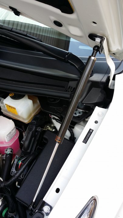

    Carbon Fiber hood struts purchased from ebay.

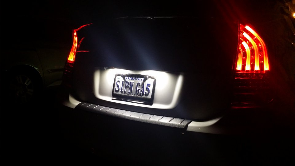

    Next up I ordered Valenti Taillights from @pansontw
    Install Instructions...
    Part II: Installation and Initial Review of Valenti JDM full LED tail lamps from TWP | PriusChat

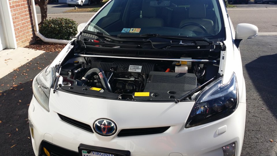

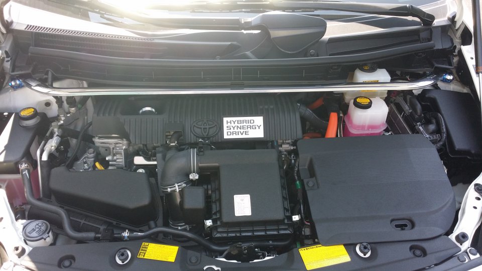

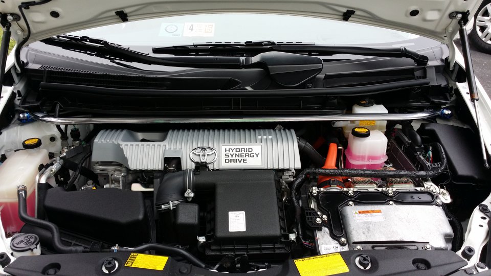

    Got the Cusco front STB from www.vividracing.com ask fro Sean ext 226 tell him Scott Jackson sent you and he'll hook you up with the best prices!
    http://www.cuscousainc.com/downloads/dl/file/id/131/951_540_alhd_strut_tower_bar_front_toyota_prius_prius_prius_v.pdf

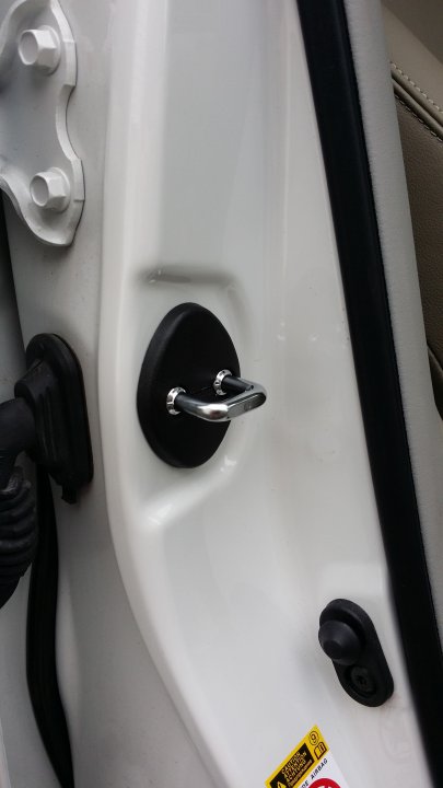

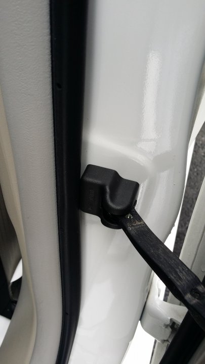

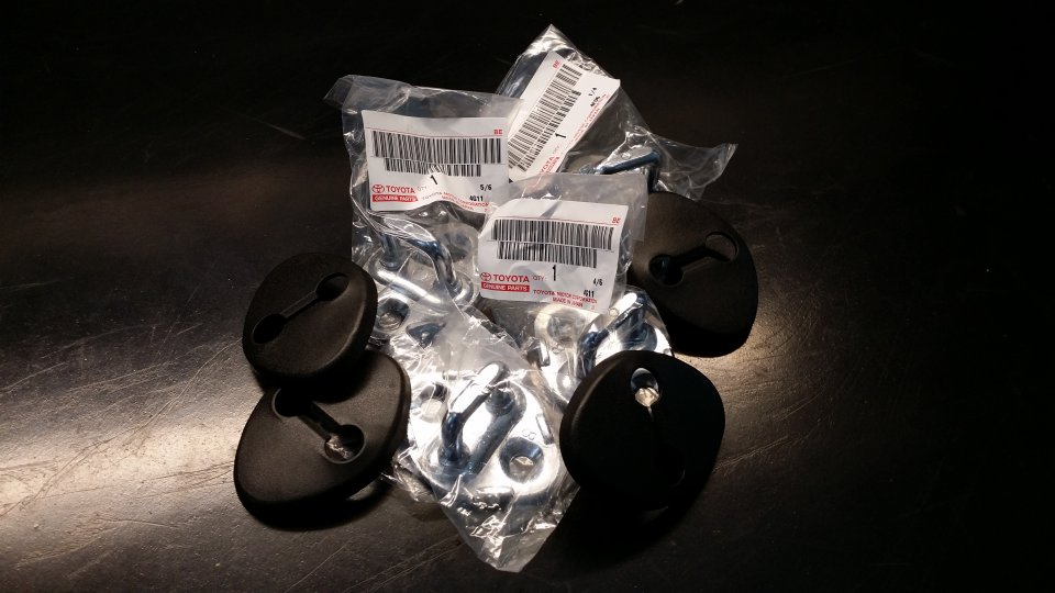

    zvw30 door strikers were next on my list from ebay
    Toyota Prius ZVW30 35 Door Lock Chrome Striker and Cover 2009 2014 | eBay

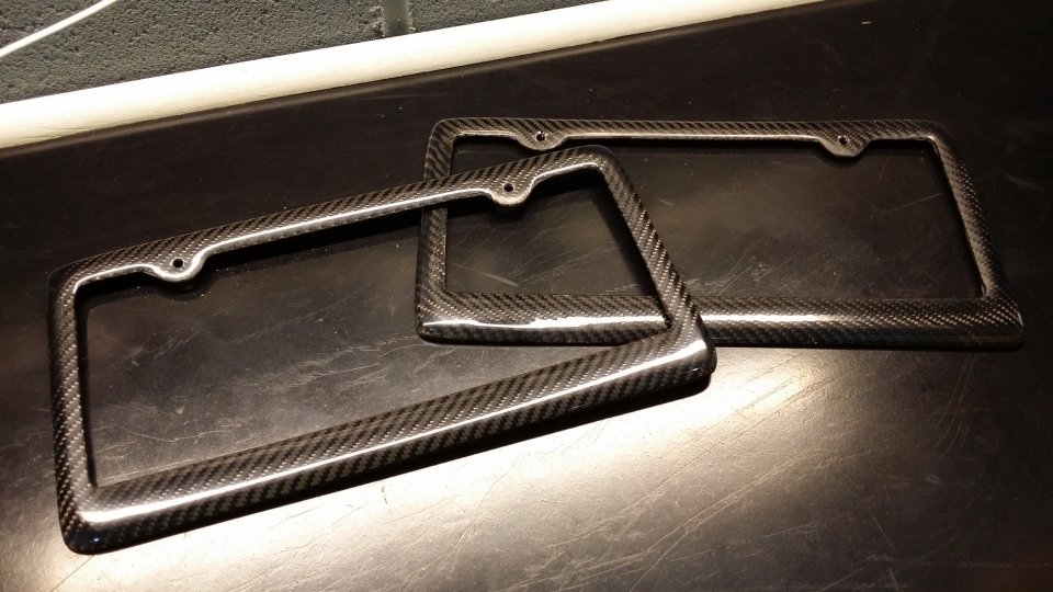

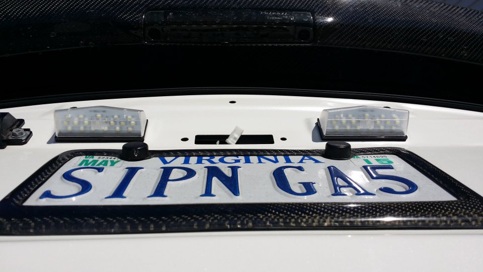

    Real CF License plate frames from ebay

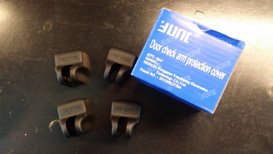

    Carbon Fiber Cupeez I added from ebay
    Carbon Fiber Auto Accessory Car Door Handle Scratch Cover Guard Fit All 4pk USA | eBay

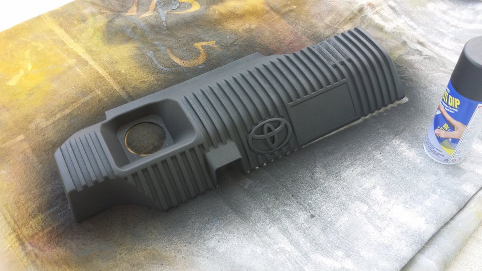

    Plasti dipped the engine cover next.....

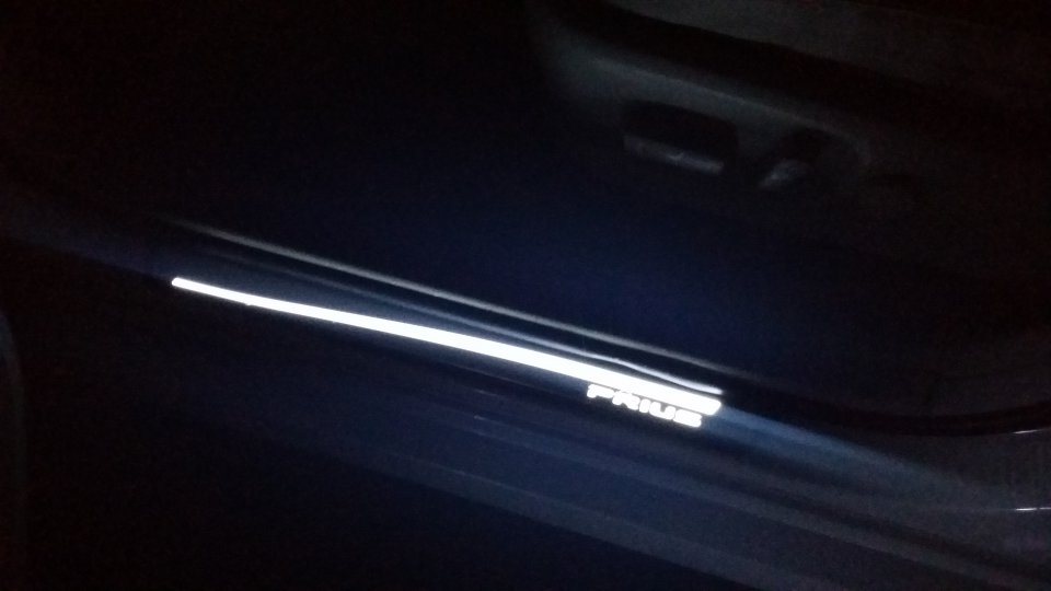

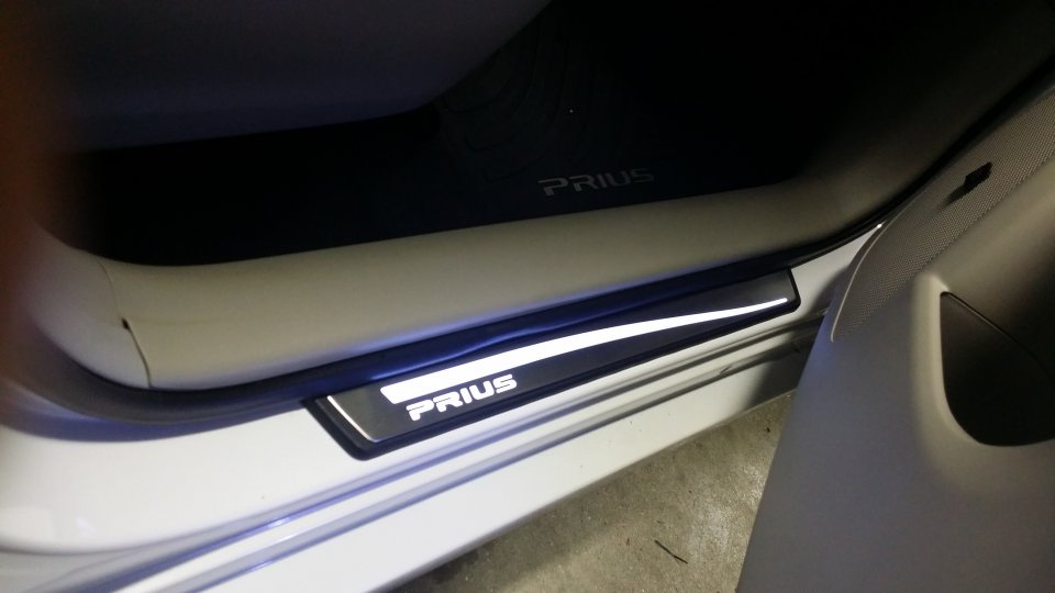

    Illuminated White led door sills install was next
    Toyota Prius ZVW30 10 Up LED Light Door Sill Plate Stainless Steel Scuff White | eBay
    Used the Install Instructions in the second post on this link below. As my back door ones lights up as well I had to wire the back doors to there designated door switch. Thanks @sfv41901 for answering all my questions on this job!
    Illuminated Door Sill Instructions | PriusChat
    More Illuminated Door Sill Info...
    Illuminated Door Sills | PriusChat

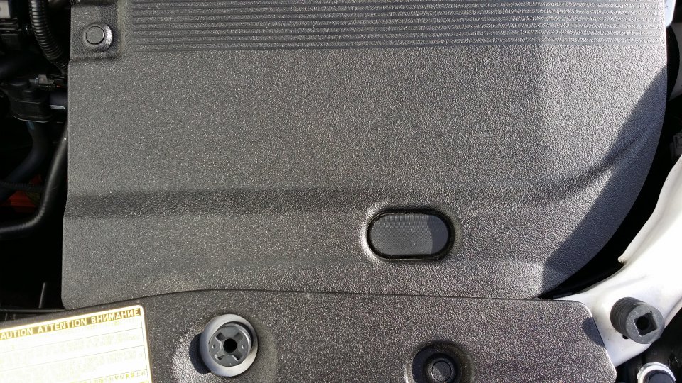

    Engine inverter covers etc from ebay...
    Toyota Genuine JDM Prius Prius V Engine Room Cover Set 2009 Present | eBay

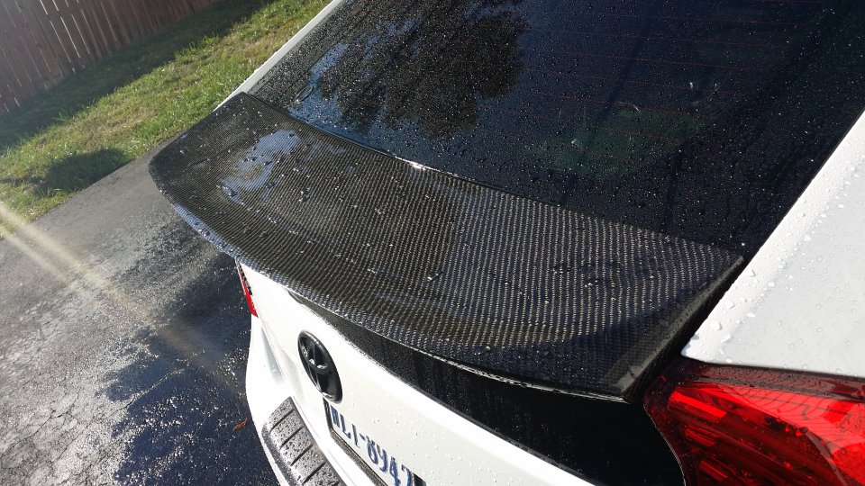

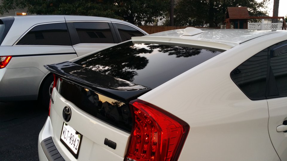

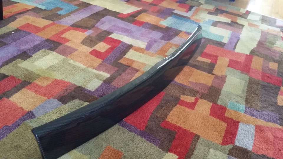

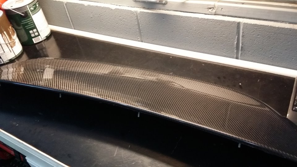

    Next on the list was Advan Carbon Fiber Duck Wing that I ordered from www.vividracing.com Sean ext 226
    Advan Carbon - The leading retailer of quality carbon fiber body kits, car body kits, rear spoilers.

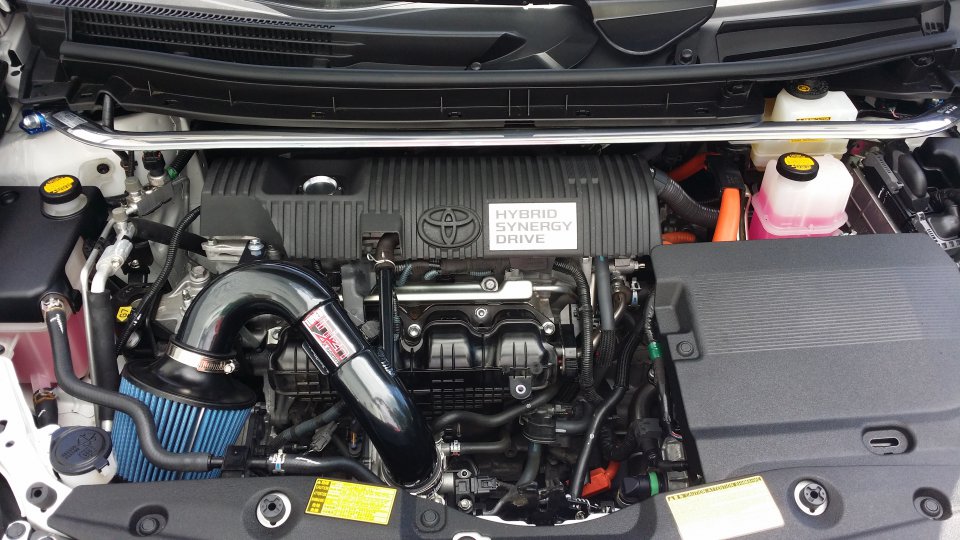

    Next was the Injen Intake I purchased from ebay....
    "In Stock" Injen Short RAM Air Intake 2011 2013 Lexus CT200H Prius Black 10HP | eBay
    http://www.juicedhybrid.com/v/vspfiles/assets/images/priuscai.pdf

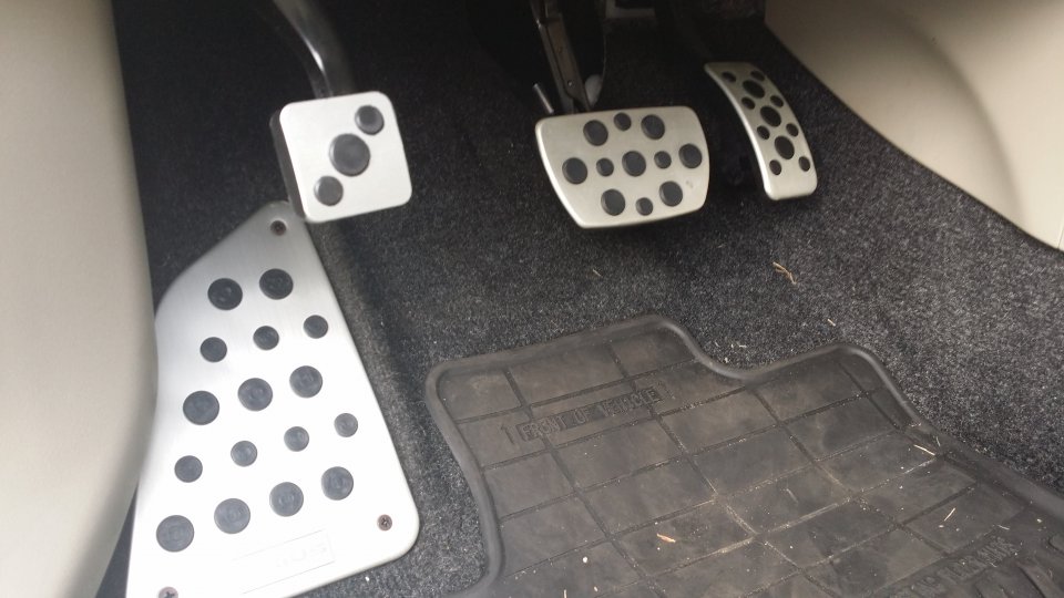

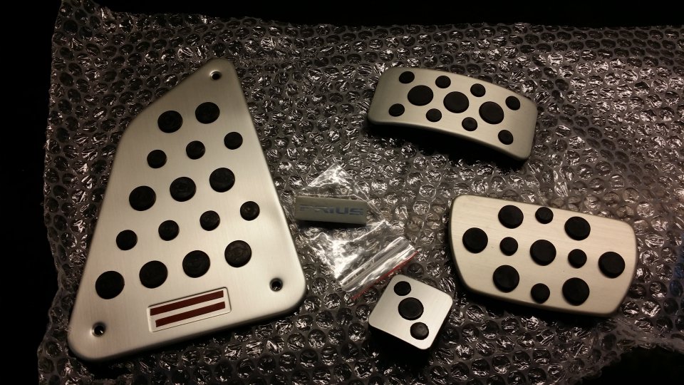

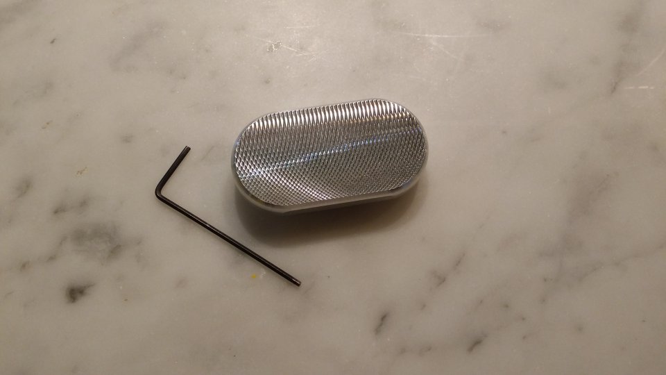

    Pedal Install was next...

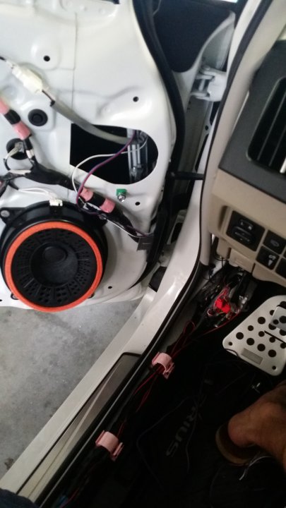

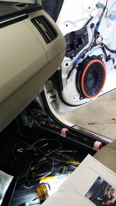

    After a long wait of finding someone to wire up my Led turn signal mirrors I finally found someone to do it. (Thanks to @sfv41901 for your help and answering my questions)
    Used these install instructions and since I don't have the power folding part, I skipped way down to where is says "If you've purchased a 3-in-1 combo welcome winker LED kit"
    DIY: How to install JDM Prius power folding side mirrors | Balancing Act

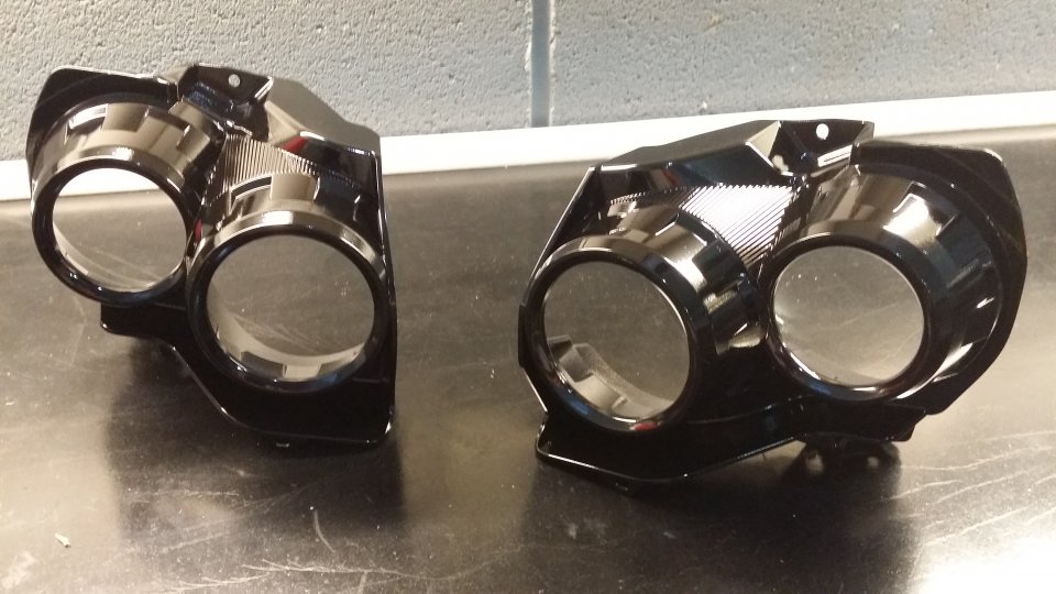

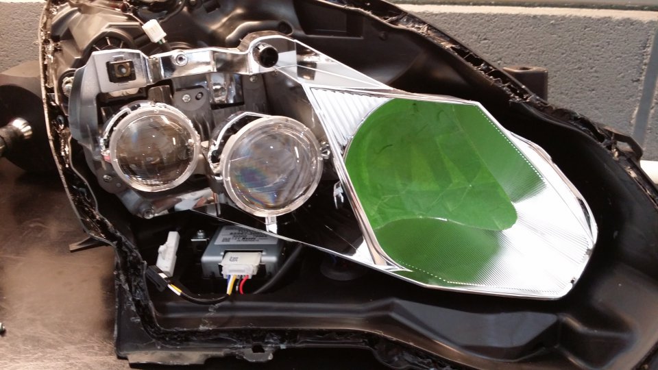

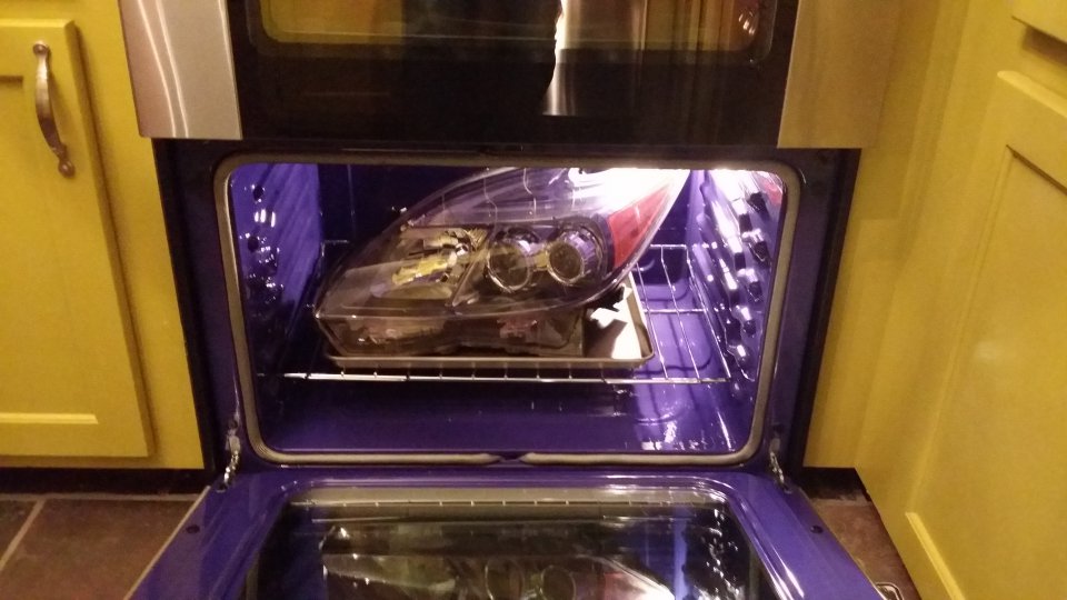

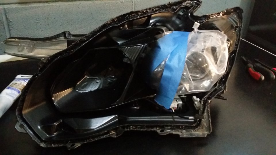

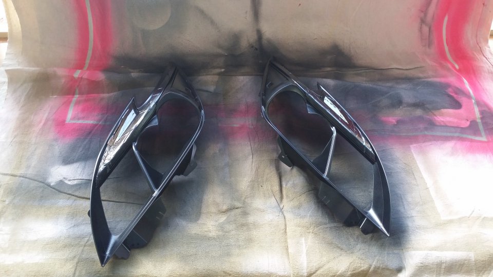

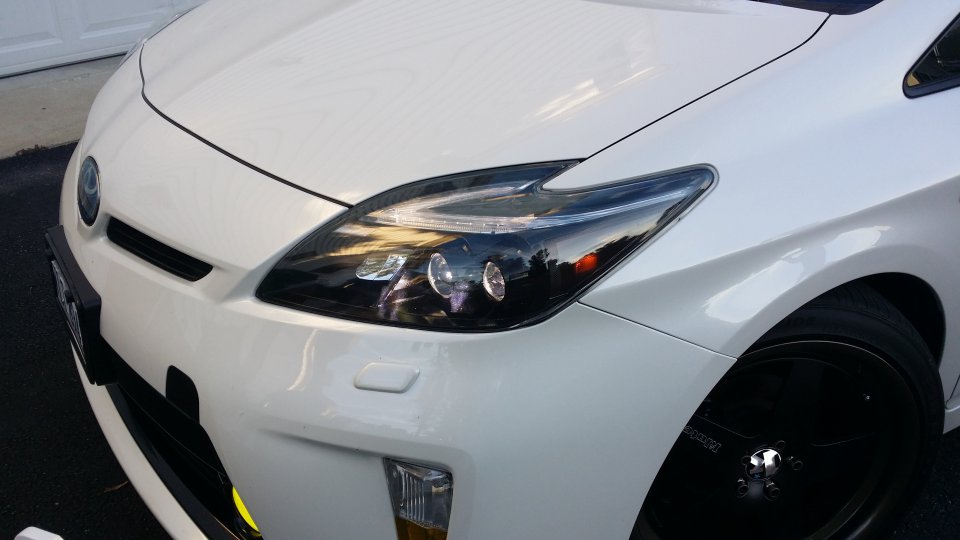

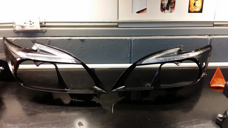

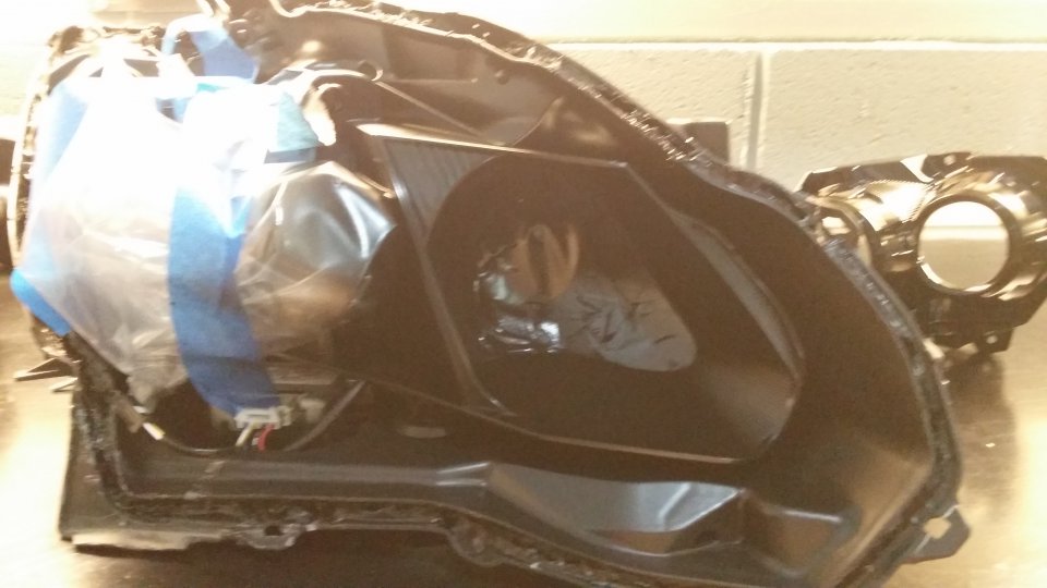

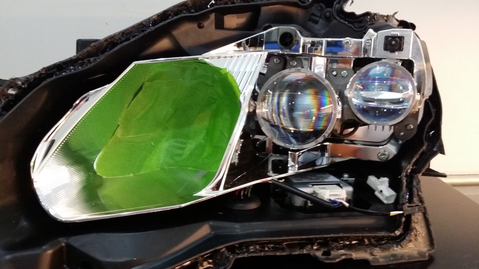

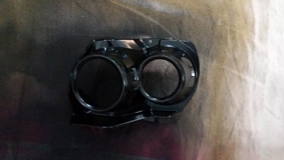

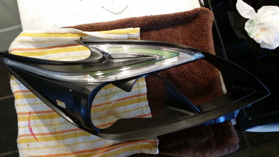

    It was time to give these factory headlights a better look...
    I decided to bake them and as I removed them from the oven and sat in my kitchen floor with a flat head screw driver to start the "pry" process I realized that this was way harder than I imagined because the sealant was cooling off way too fast and I was so ready to just go put them back in lol. Luckily my coworker had done it to his motorcycle headlight and used a heat gun. I ran the lights over his house and we used a heat gun and removed both lenses in about 45 mins.
    Very good write up for baking and blacking out the Prius headlights
    DIY: How to black-out the headlights on a 2010+ Prius | Balancing Act

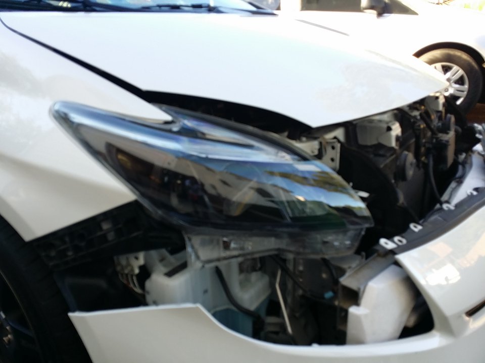

    Front bumper removal instructions...
    DIY: How to remove the front bumper from a 2012 3rd gen Prius | Balancing Act

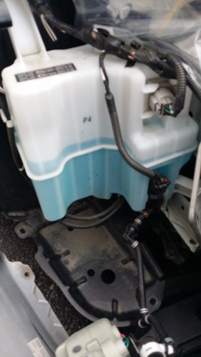

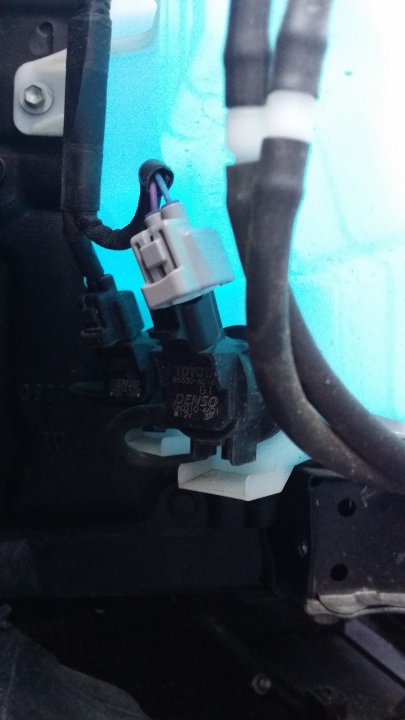

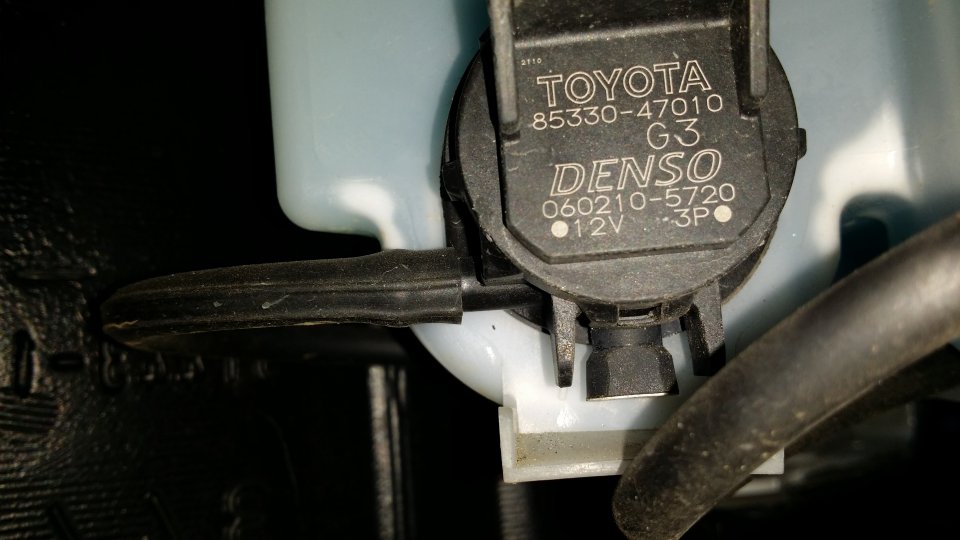

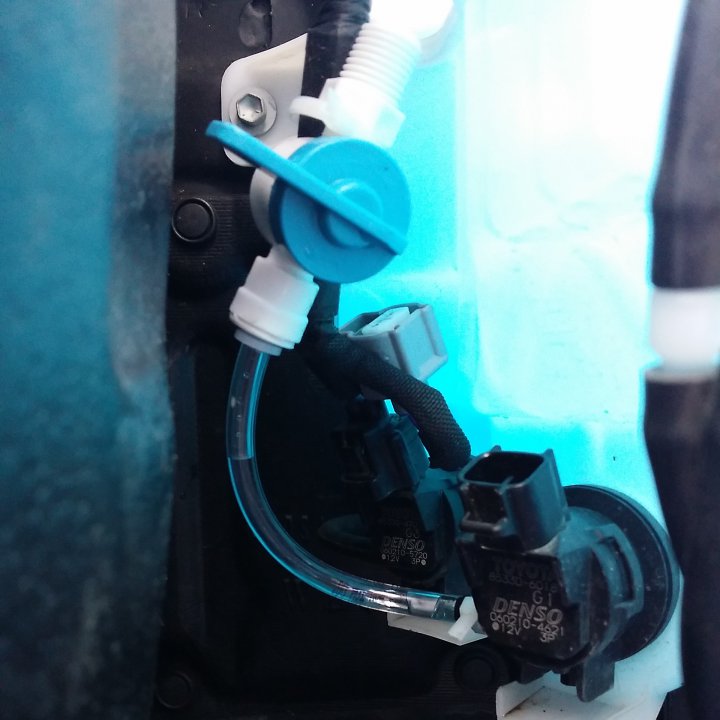

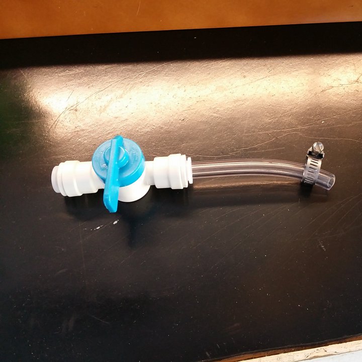

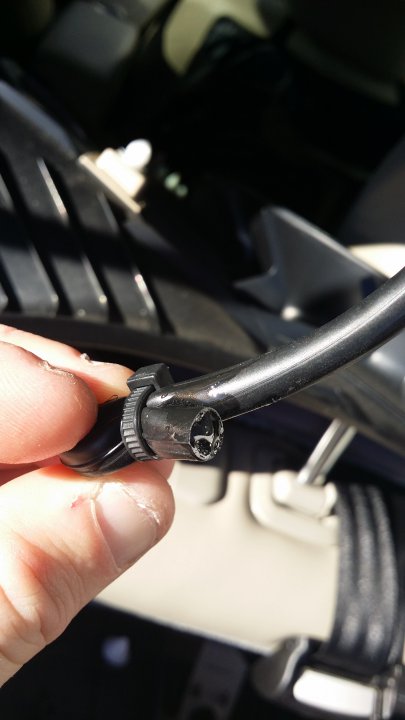

    I figured while I had the front end off I would figure out which line goes to the rear washer nozzle and unhook and isolate it so it would all be done by the time I mess around in the hatch area to remove the rear nozzle.
    The rear line is the one with the gray plug. I unplugged it, and no you wont get a dash light for unplugging....

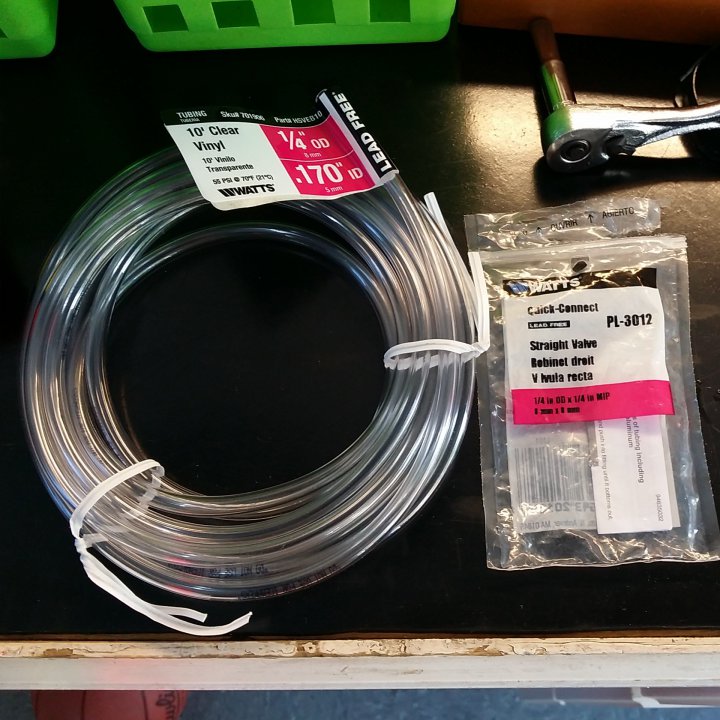

    So I was off to lowes for my homemade "try to figure out how to keep the fluid from coming out when I unhook the hose" project and this is what I came up with.....
    Its now "shut off" and isolated haha back to the headlights now....

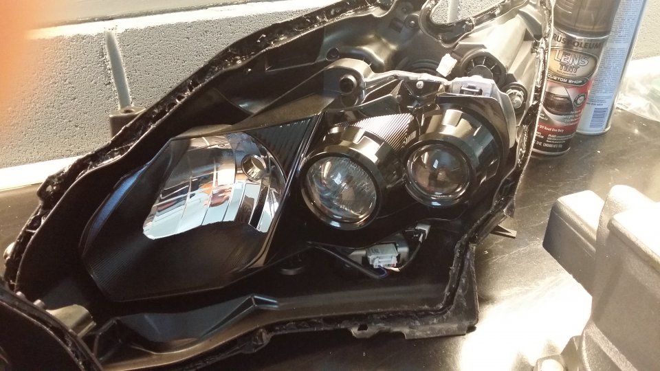

    I figured id be a little different and spray 2 coats of lens tint(from Walmart) on the orange headlight reflectors...
    Rust-Oleum Lens Tint Spray Paint, Black - Walmart.com
    Sneak peek....
    Finished product...

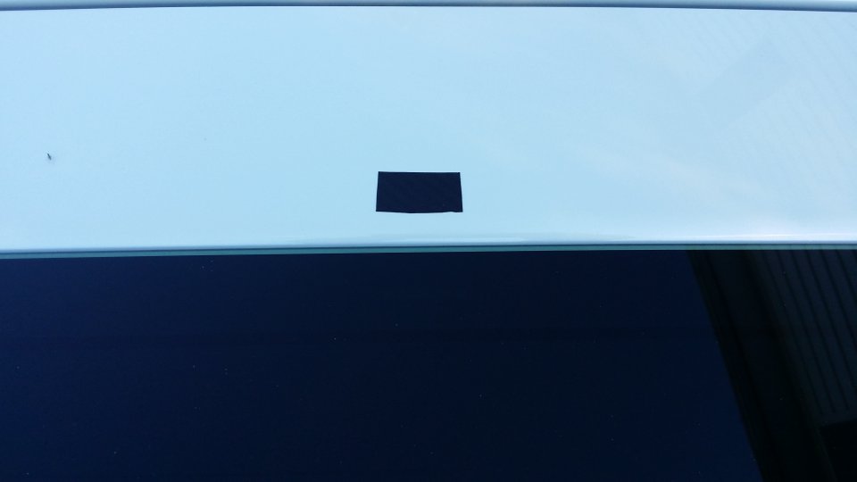

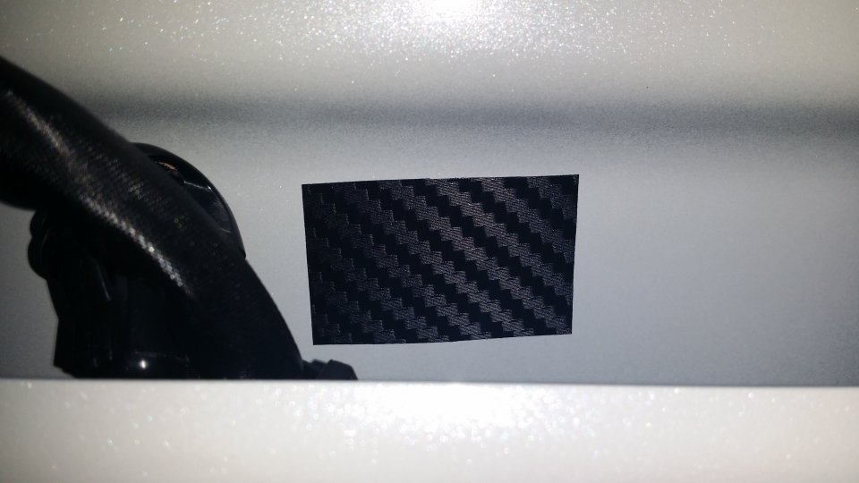

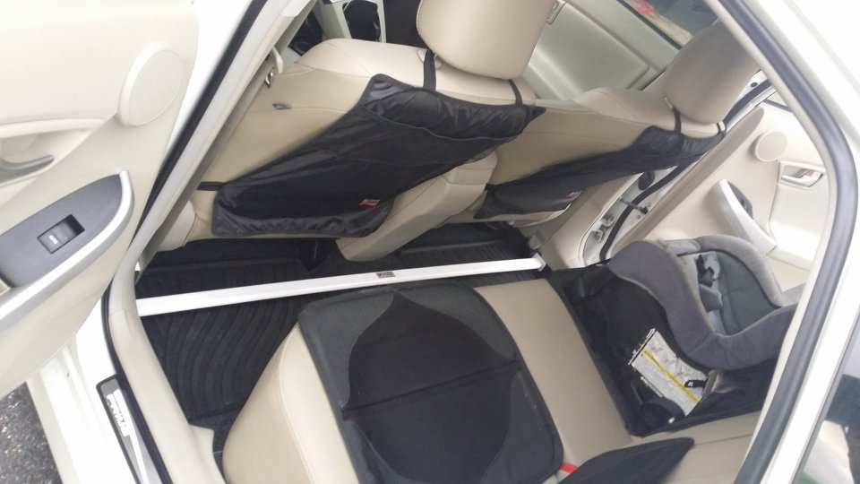

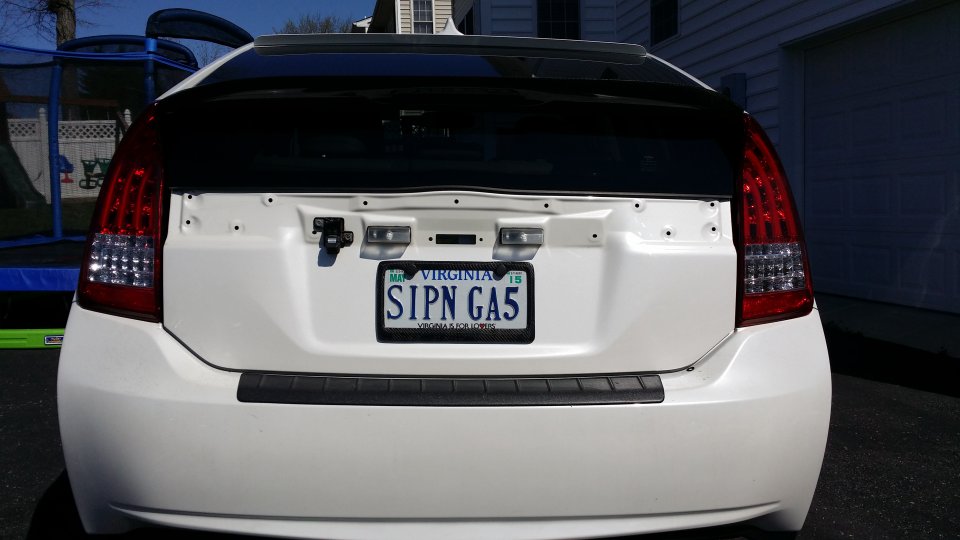

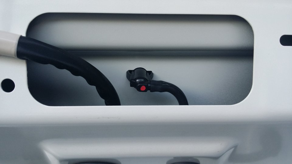

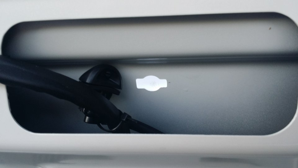

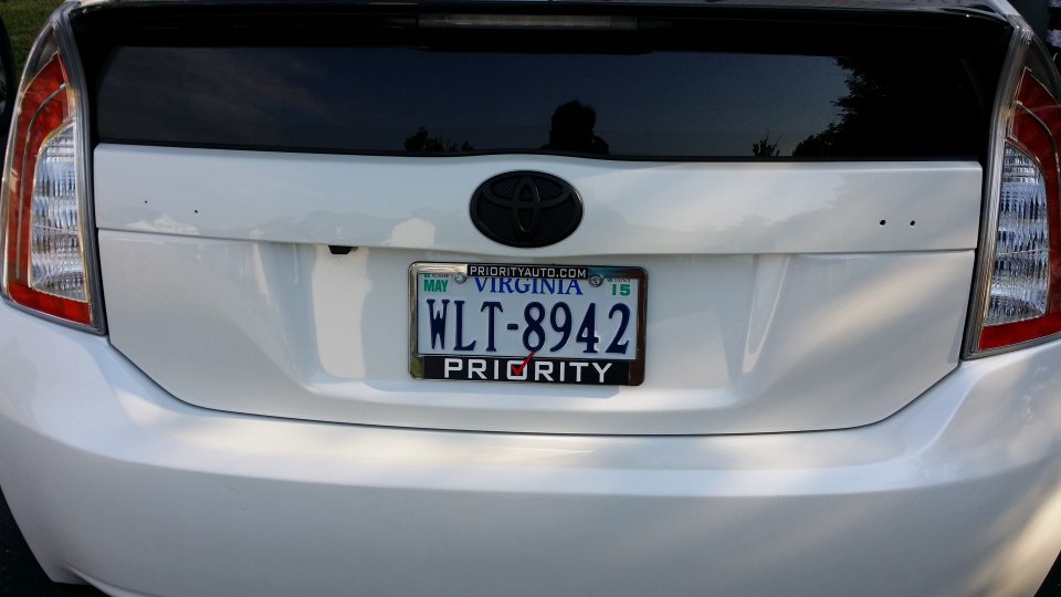

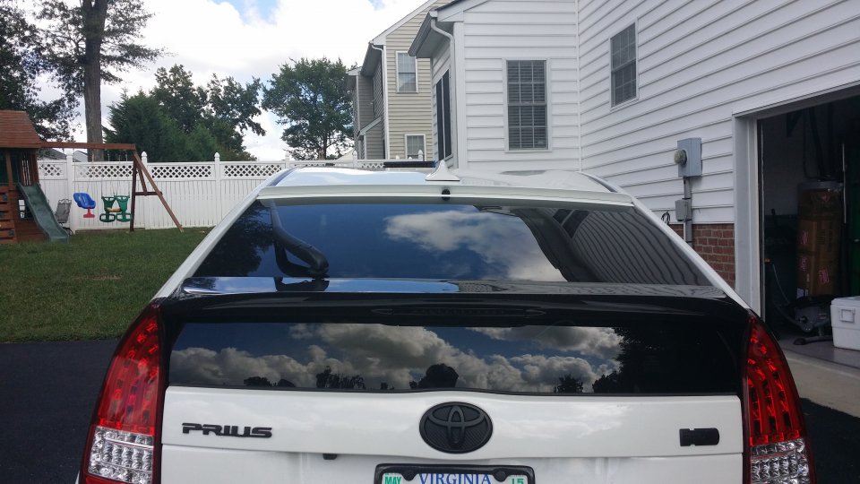

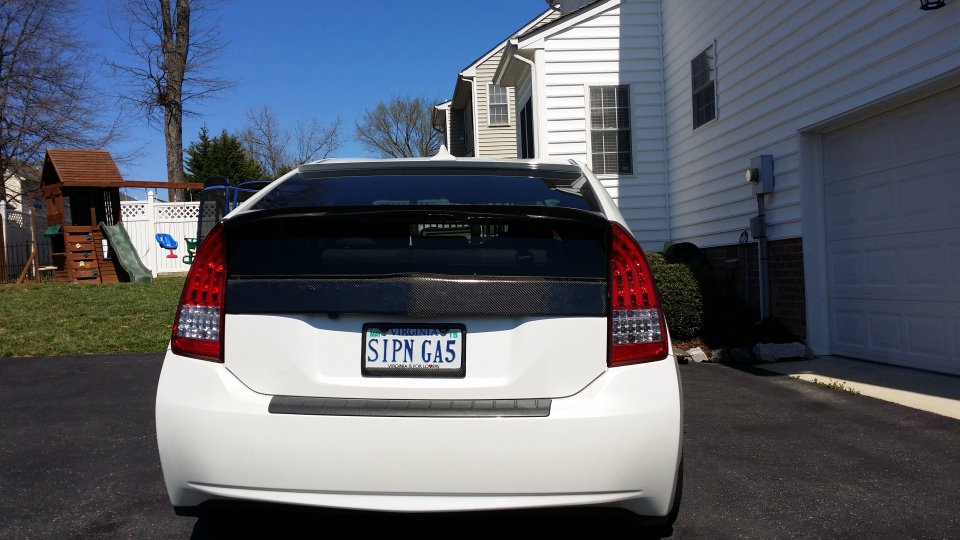

    Next I moved back to the hatch area to remove the rear washer nozzle. Once I removed it, I wire tied the rear nozzle to a wire inside the hatch area incase I ever wanted to put it back in I knew where to find it.
    All gone...
    Next I covered the hole on the inside and outside with some CF vinyl I had laying around as I bought enough to do my hood but then decided after doing the Advan CF Duck Wing how could I do that to myself! lol

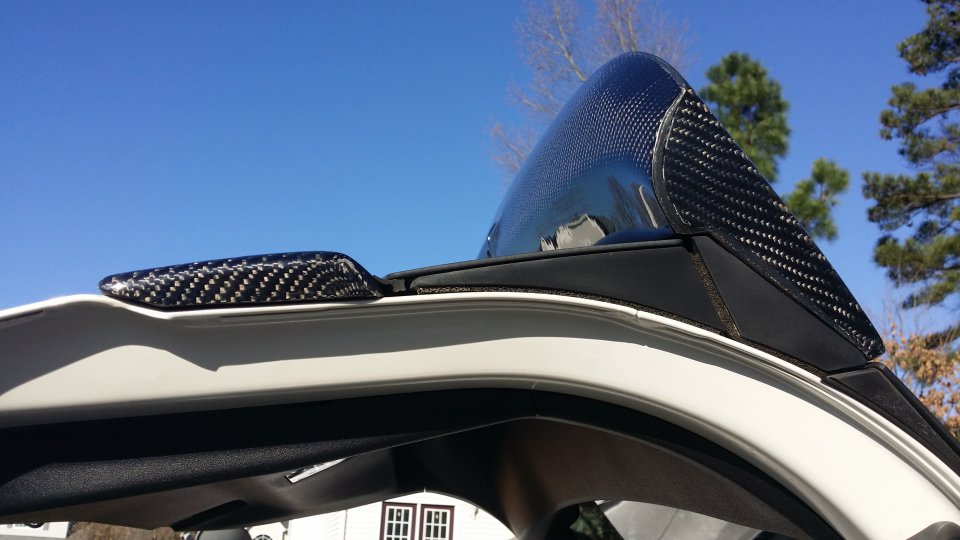

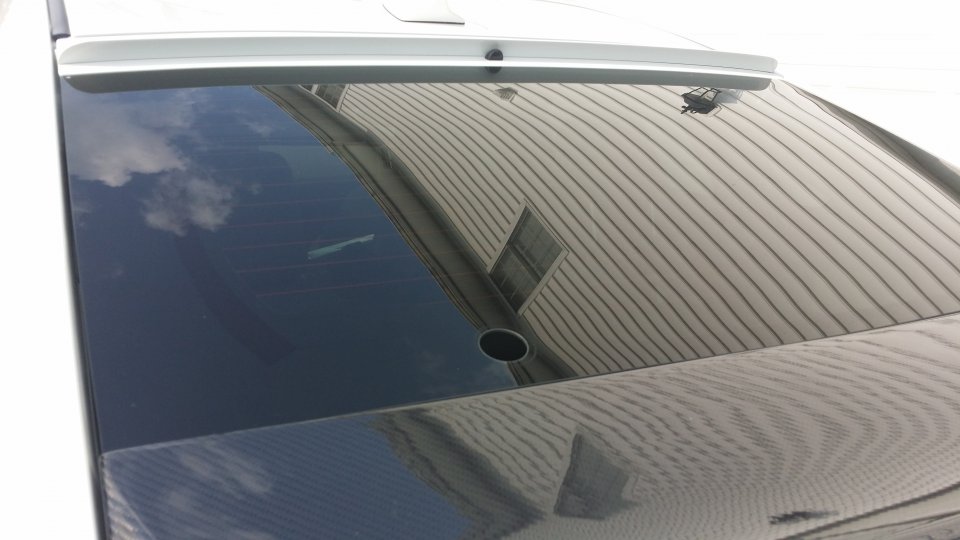

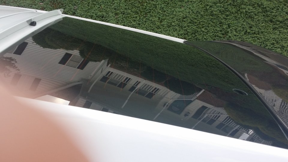

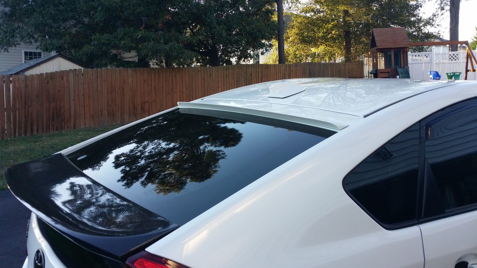

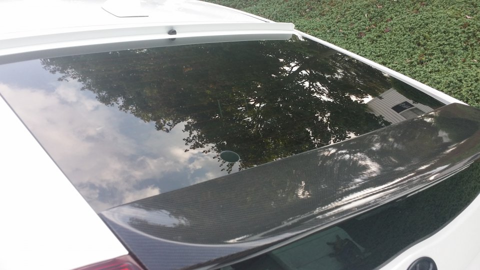

    After I finished that, I uninstalled my rear roof spoiler and got all the 3m tape off the roof of the car and the spoiler and cleaned it all up and installed new 3m tape on the rear roof spoiler and reinstalled it lower overtop of where the rear nozzle was....
    While I had all the hatch panels off, I pulled the rear nozzle line out off the hatch boot (right side hatch boot) and folded it and wire tied it and also put a dap of epoxy on the end of it even though I isolated this from the front end earlier when I did my headlights. I just wanted to be sure I wouldnt have an issue because this line is just laying above my headliner now. I decided to do this because my rear cargo LED lights came in and I installed them then also and had a hard time trying to run the LED cargo light wires through the hatch boot on the left side. Tried using a coat hanger and other stuff but ran out of patience and just decided to go this route!

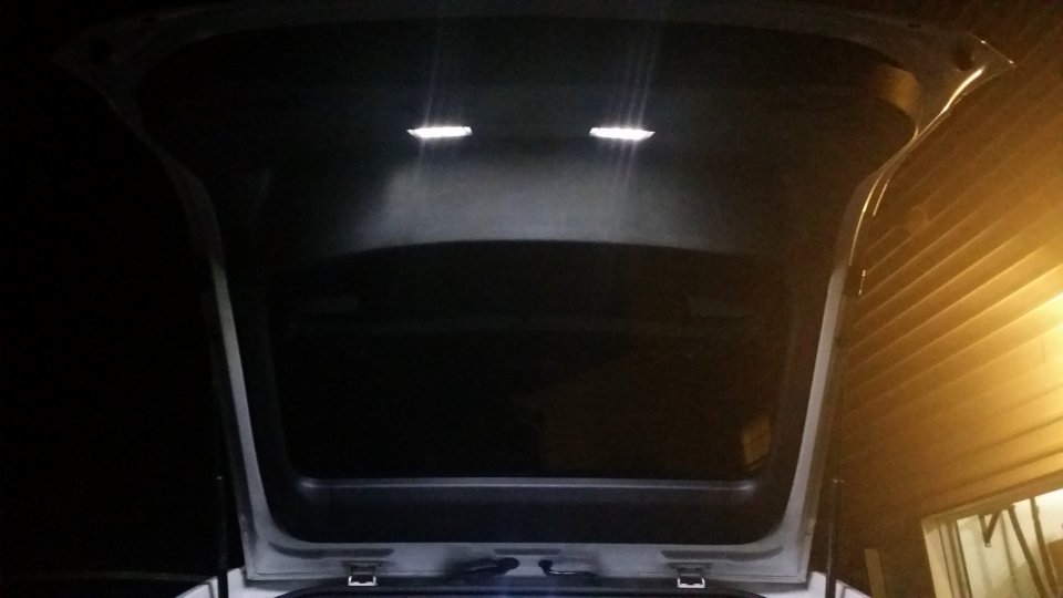

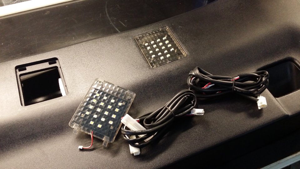

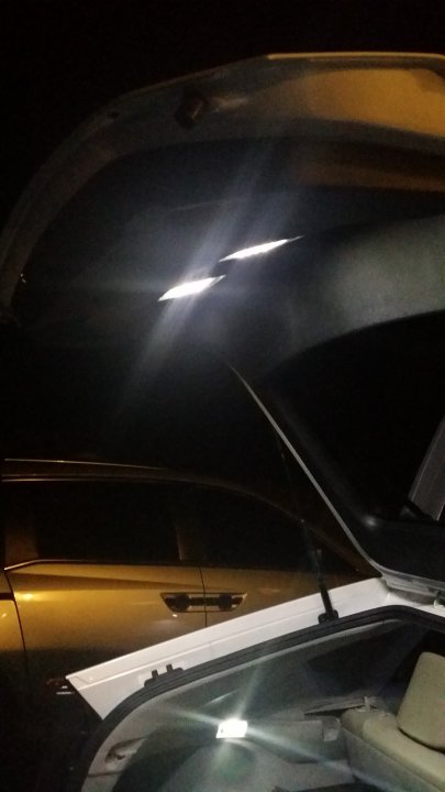

    LED Rear Cargo lights came from ebay....same seller as the LED Turn Signals
    Toyota Prius ZVW30 10 Up LED Lights Rear Cargo Trunk Light Luggage Lamp | eBay

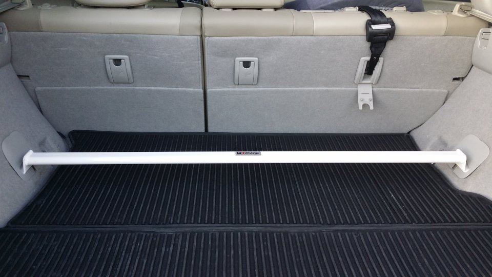

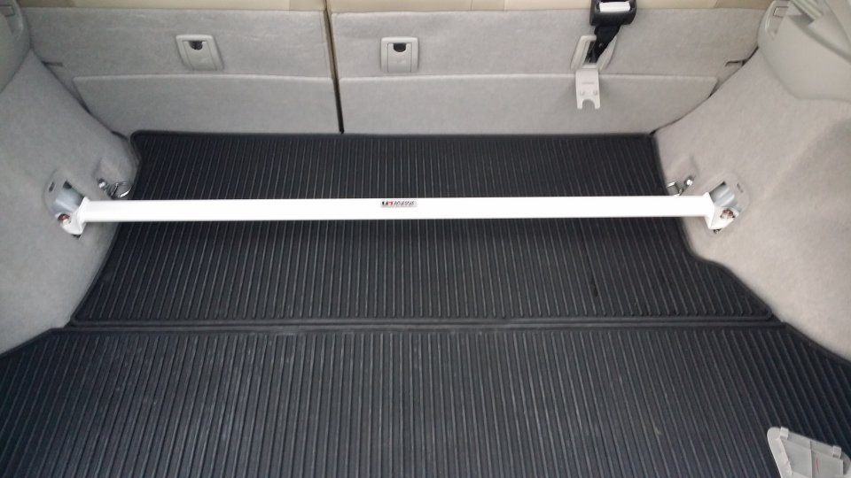

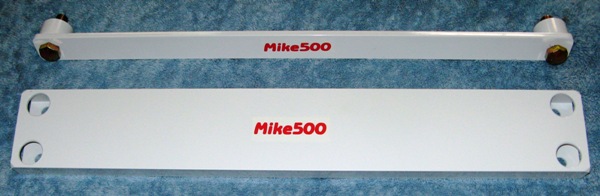

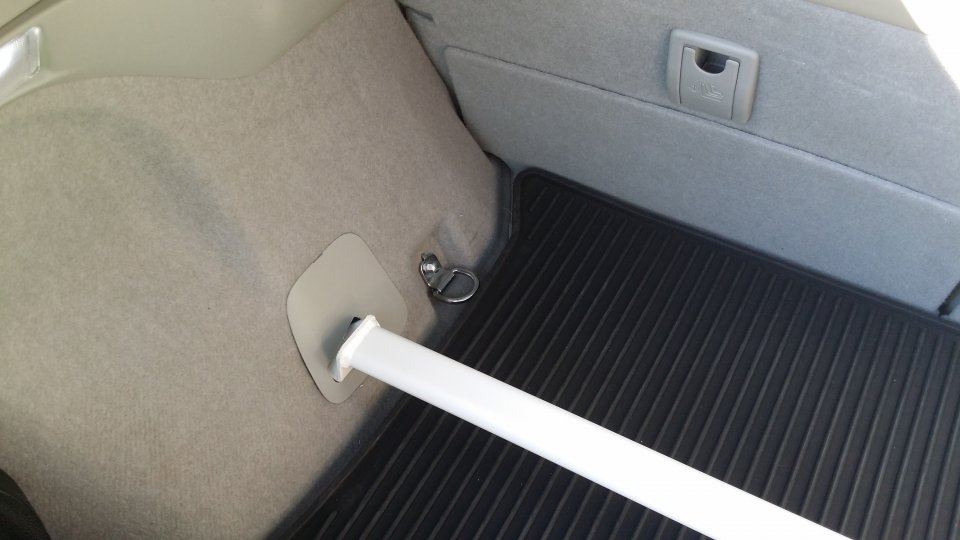

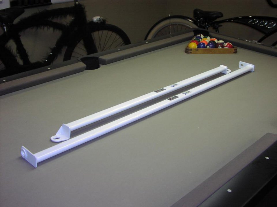

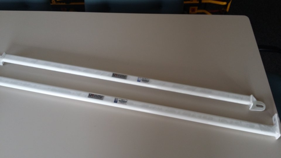

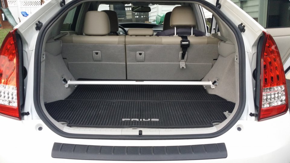

    I thought I was done for a little while until that damn @Burna J posted this pic.....
    I was trying to get some of these made as I had no clue they even made them. Apparently I didn't look good enough! Thanks @sfv41901 & @RightOnTime for tipping him off on the fitment for the Lexus CT200H working for the Prius!

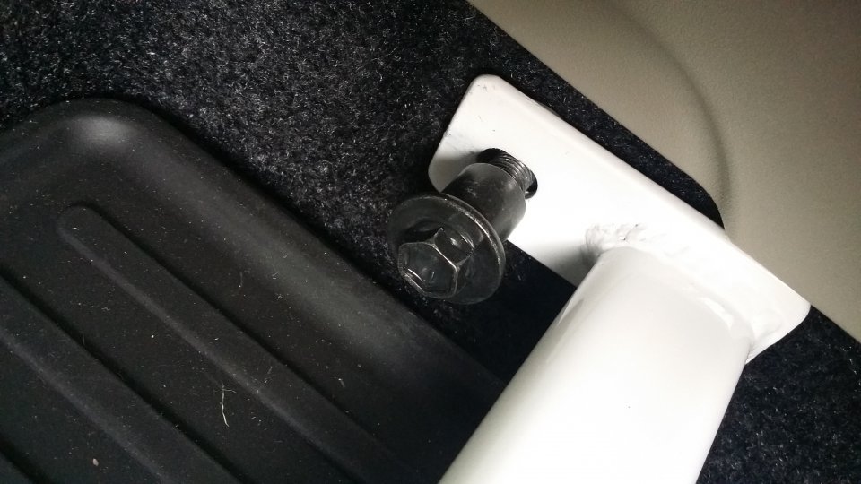

    So of course I was in!
    Toyota Prius 1.8 XW-30 (2010) Room Bar / Rear Cross Bar - Ultra Racing Product Catalog
    Toyota Prius 1.8 XW-30 (2010) Rear Strut Bar / Rear Tower Bar - Ultra Racing Product Catalog

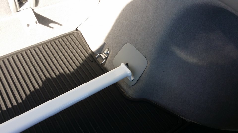

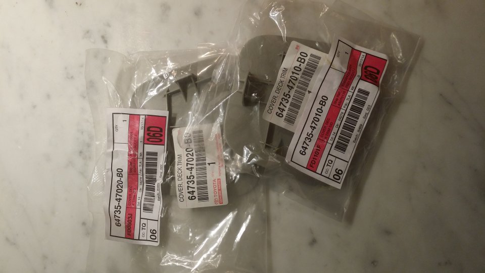

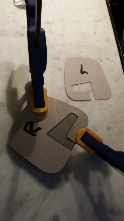

    Ordered an extra set of rear strut covers to cut so I can place back on with the bar cut out. Thank you very much @Burna J for all your help on this. Should be cutting them out soon!
    Thanks @Burna J for the excellent templates for cutting the rear cargo bar covers!

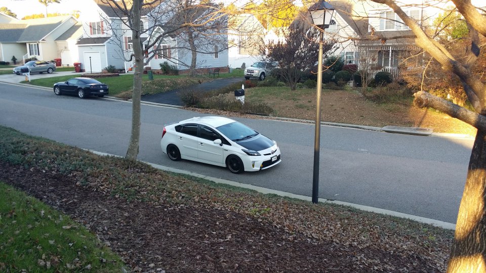

    Got some new wipers.. Trico Onyx (11-14-14)

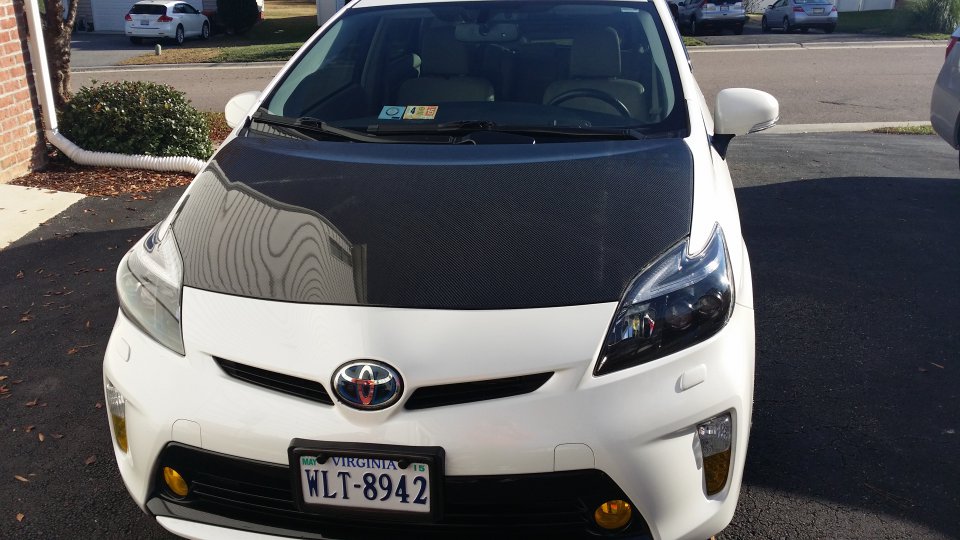

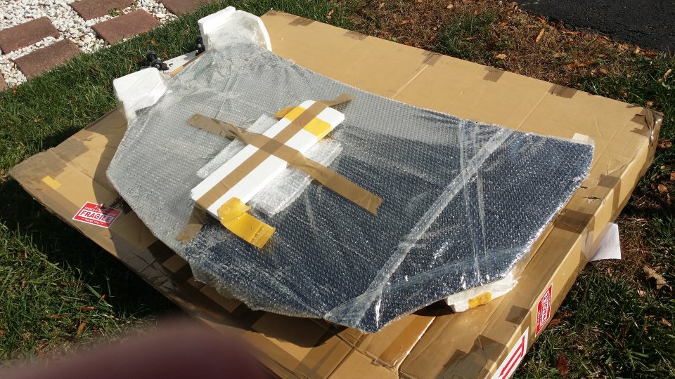

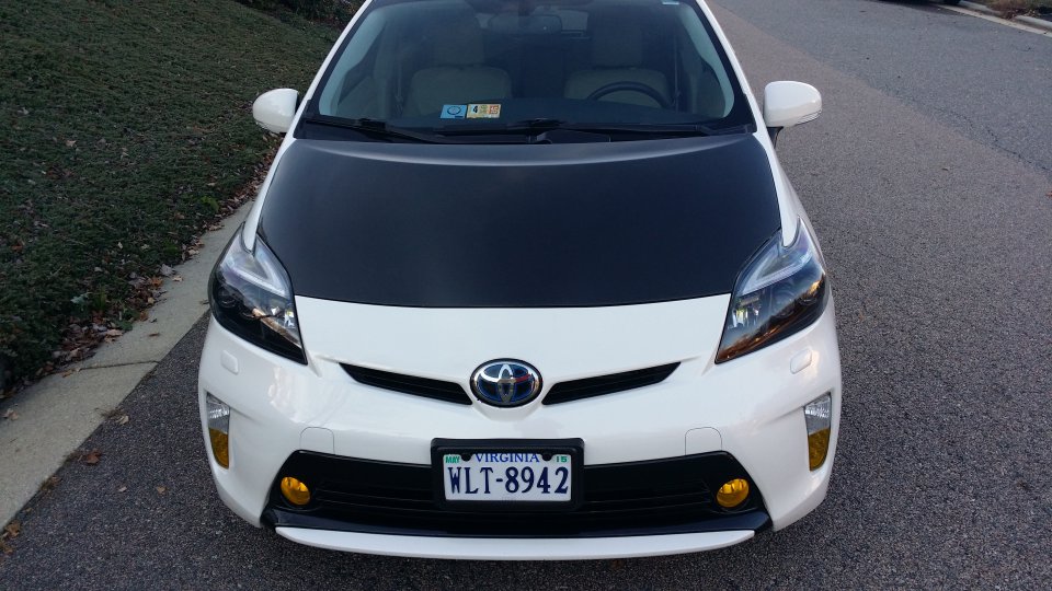

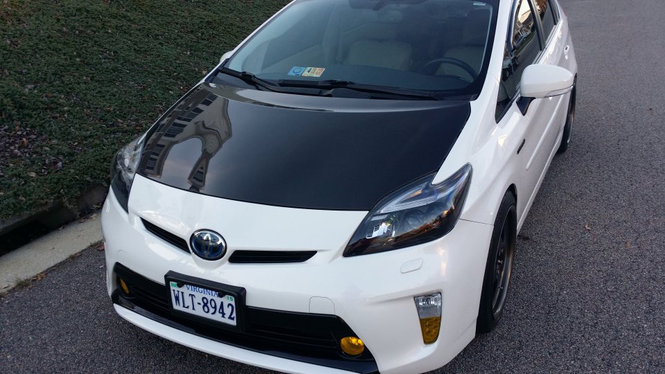

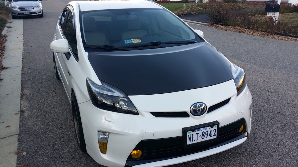

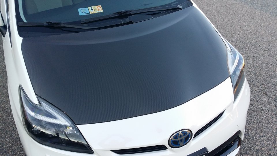

    OK so the big thing is here! (11-15-14) Advan Carbon Fiber Hood I got from www.vividracing.com Sean ext 226

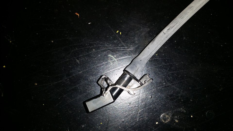

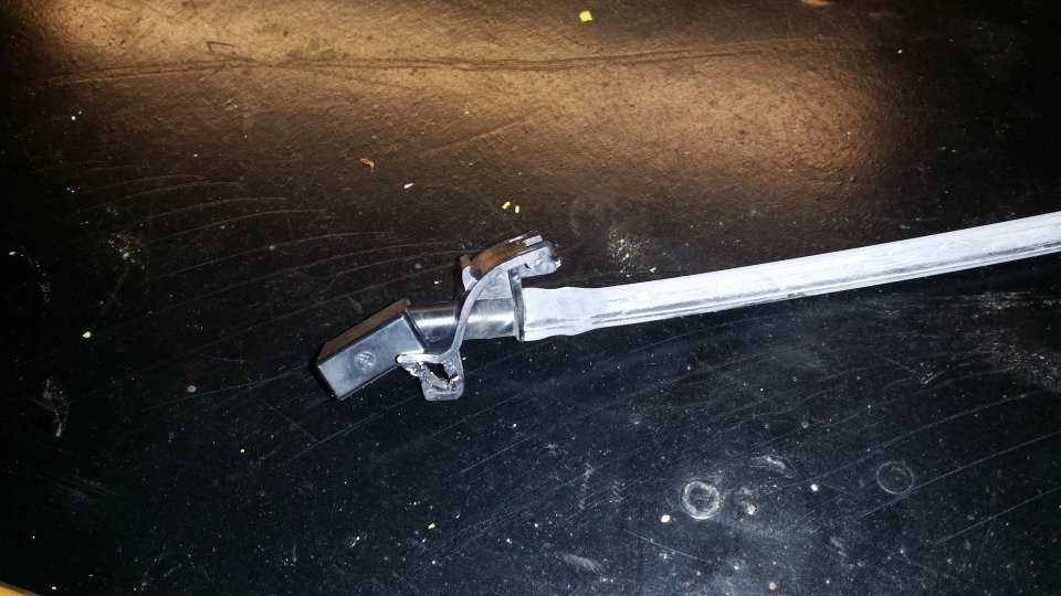

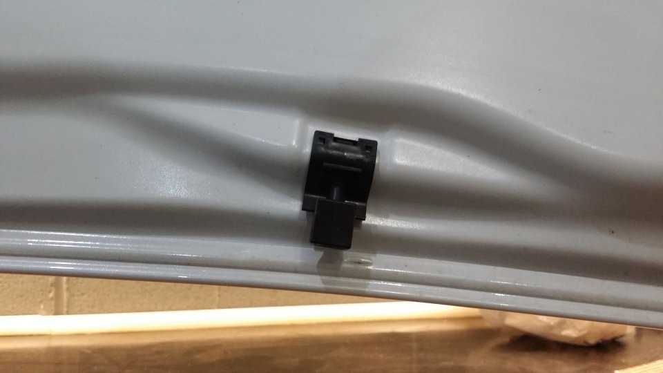

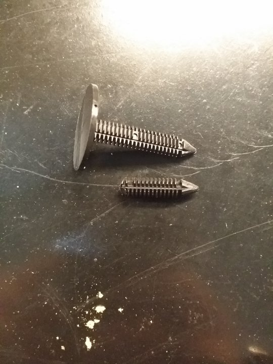

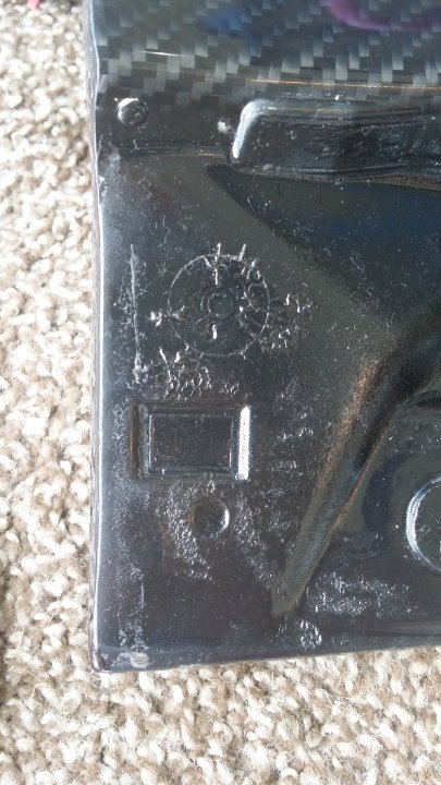

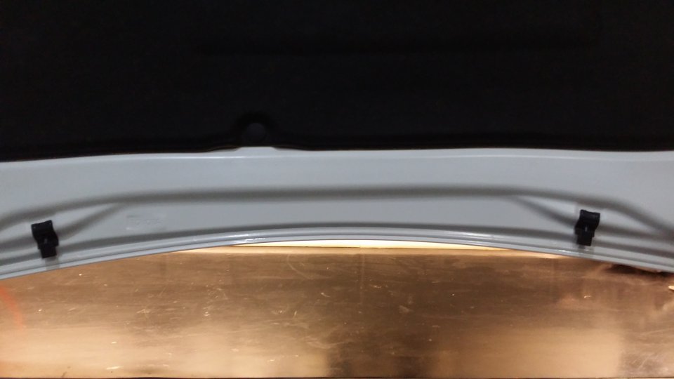

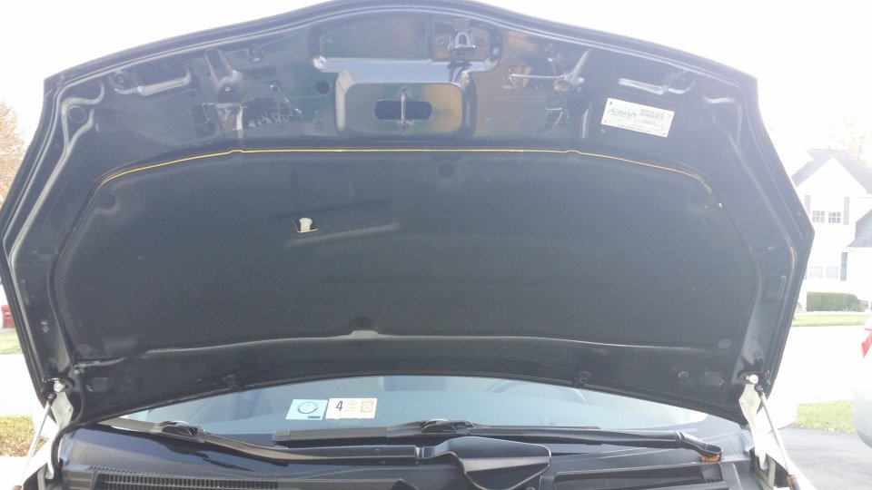

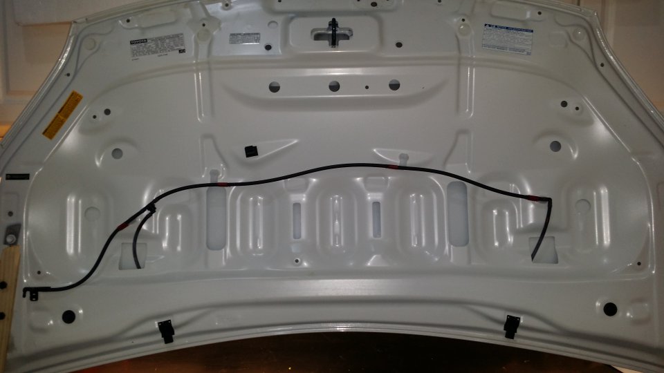

    I finally had some time to remove the heat shield from my factory hood. Of course all the push plugs that hold it to the hood broke when removing them!
    The clips I ended up replacing the broken ones with were from Lowes and there the only ones I could find that fit into the Advan hood...
    The pic below shows where I cut all 6 of them to fit nicely into Advan Hood...
    Then I had to remove the washer lines which were held on by some clear plastic clips that were a pain to get out without breaking. I torn them up a bit, but they still went into the new hood well. The washer squirters were a pain to get off as well with a little prying with a flat head but they came out without breaking thankfully!

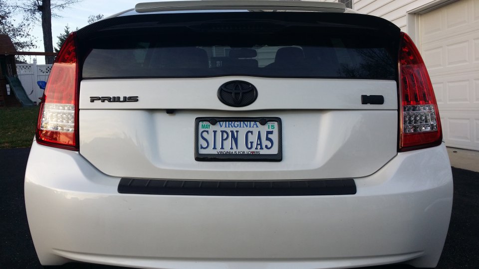

    Put the new plates on today 11-22-14

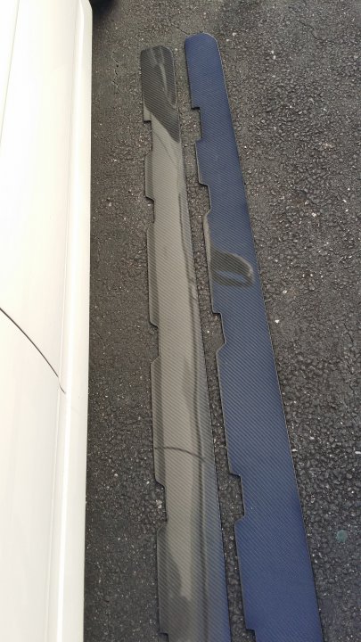

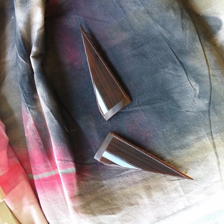

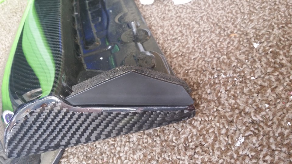

    So I picked up these AeroJacket Carbon Fiber side diffusers from member @donut_boi who bought them brand new but never installed them. He had them for sale for a while and I kept an eye on them. After some time went by after negiation with him I decide to contact him again asking if he still had them(I was hoping he didn't honestly because I've already spent enough) but of course he still had them and I caught him before he was gonna jus put them on his ride anyways. So danget here they are! lol I'm probably gonna wait till I get some side skirts eventually once I decide on a kit to put them on.

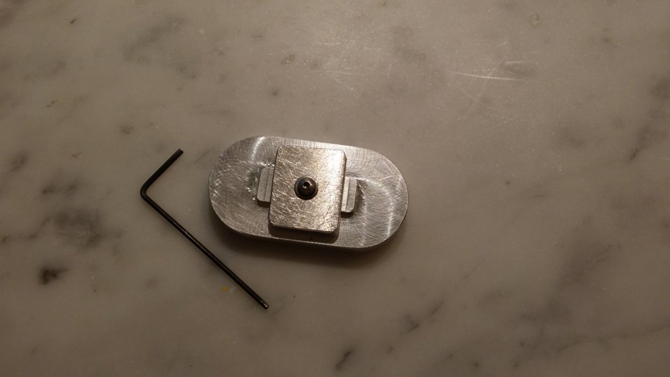

    So I have a few little things I've been messing around with. The first being my little custom piece for my inverter cover from my secret admirer from Long Beach! I plasti Dipped it before I installed it and I think it looks so much better and complete now.

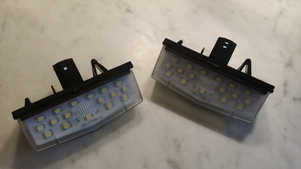

    A while back I was reading some post and seen where @Xterra72 was changing out his licence plate lights to the full led lights which required taking off the hatch trim piece to switch the lights out. I got to thinking outside the box some and said dayum I bet that trim piece would look pretty sweet with no emblems and real CF and clearcoated!(Evidently @Starbrand and I think Alot alike because he did something similar recently but I didn't wanna say to much yet because I hadn't got my piece back yet)

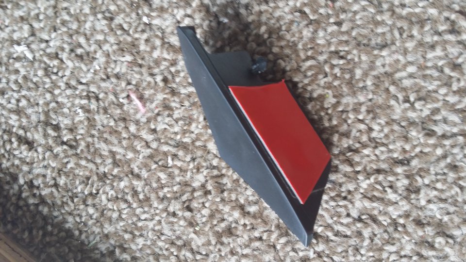

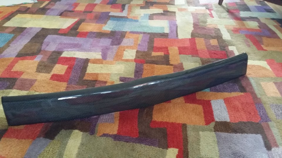

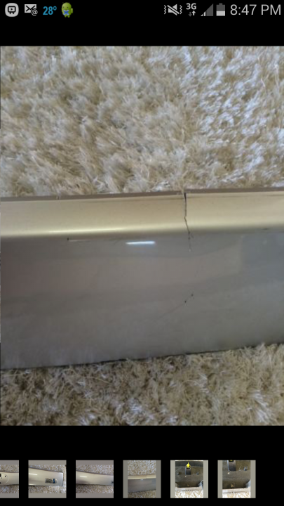

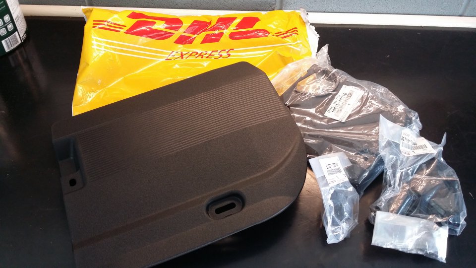

    So I got online looking for the hatch trim piece. The dealer wanted $300 bucks so I said noway. Got on eBay and searched and found a few. The one I ended up getting from eBay, they wanted $100 obo..... offered $50 and they accepted!
    It had a small crack in it but I had the seller send it strait to and undisclosed location ;) where the magic happened! The crack got fixed with fiberglass and all the emblems were removed and holes were filled in and sanded.
    I figured heck, when I get this piece back and remove my stock one to put the new one on why not buy the full led license plate lights as well. Ended up picking up the lights of eBay for $21.99 free shipping.
    UPDATE on the hatch trim piece sanded sans emblems....
    So then the piece was done in real cf and clearcoated and shipped out to me! :whistle:
    Time for the install now. I took the yellow clips off that came on it and replace it with all my clips from my factory piece as the one from eBay was missing a few.
    Install was very easy...jus remove the one panel on the inside hatch that has the hatch led's in it and you can get to everything you need to get to.

    Well when the mirrors came in I actually put my mirrors off and took the shells off and put the led stuff all on and ran the wires and left them behind both door until I found someone to wire them. Not sure if he'd do it again as it took us some time to figure it all out. He was kinds nervous about doing it as we were both scared messing with the A pillar where the air bag was.

    Whoa! Where did you get those amazing DRL replacements?

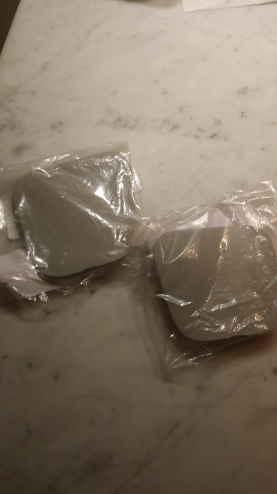

    Cut and installed my rear cargo area brace covers today!
    Xterra72 likes this.

    Installed Trico Onyx wipers and Advan Carbon Fiber Hood(Scroll to beginning of the thread)

    Installed new license plates today(end of first post of thread)

    Nice plates. Straight pimpin.
