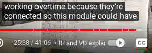

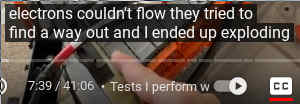

    Not a terrible video, but maybe not a mic drop either. The way a module ends up bursting was given kind of a new explanation here:
    And there's a stretch around 25 minutes in suggesting that a module can be "working overtime" because of the condition of the one it happens to be next to for voltage monitoring purposes, which was already discussed upthread here in #25.
    The point strawbrad was making in #25 was that the voltage sense wires are only that. They sense voltage, but are not used to carry any balancing currents the way you might see in a full BMS for a lithium pack. There is just one series current through the whole pack; how much 'overtime' a module works depends just as much on a module ten slots away as it does on the module that happens to be next to it.
    (Now, if the module next to it is making extra heat, that is an effect that's bigger than heat ten slots away.)
