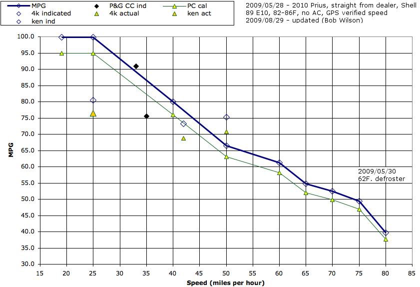

  5. bwilson4web
    28,673
    16,215
    It is a little worse:
    None of those reporting the problem are willing or able to run a controlled benchmark to compare it to what our 2010 did in May 2009:
    Without running a benchmark, it remains a rumor. A benchmark is not that hard: level road, one above 45 mph and one below 40 mph using cruise control over a 10 mile loop or two, opposite direction passes. Instead, we get a litany of 'I complained . . . ' for which I have as much sympathy as the number of benchmarks run.
    There was one credible report of a maximum acceleration sprint where the poster reports having done pre and post patch benchmarks. They report the effect is evident in a maximum acceleration which would stress both engine and traction battery. However, it is impossible to replicate this benchmark without more documentation to find an equivalent slope and distance acceleration ramp. If the original poster would give the longitude and latitude of the acceleration ramp, we could look around to find something close. A GPS trace of the acceleration ramp and their driving profile on that ramp would be perfect documentation. Then we might see if our car has the same or different performance.
    The only one who has actually replicated the benchmark since this thread started is me. I found my post-patch, benchmarks replicated the 2009 data. So if I seem skeptical, it is because the time wasted complaining instead of running a benchmark suggests . . .
    It is time for the complainers to report to the EPA and NHTSA . . . professionals who can actually do what the complainers remains unwilling or able to accomplish.

  10. bwilson4web
    28,673
    16,215
    No benchmarks, no problem:
    • One below 40 mph to test the hybrid mode.
    • One above 45 mph to test engine-on mode.
    For now, I'm waiting for the realization that all "appeals" are exhausted and there is no one else to complain. Hopefully they'll decide to collaborate on debugging the problem.
    Alternatively, they might sell the car and get something else. Then the next owner can come back and work with us to figure out what is going on. I'm patient.
